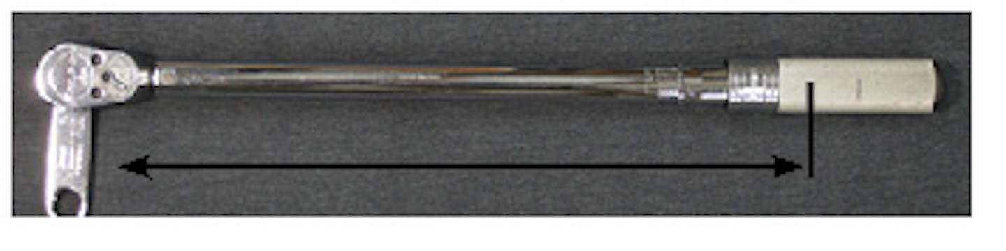

    M1 = M2 x L1 / L2
    Where:
    • M1 is the torque setting of the wrench
    • M2 is the actual torque applied to the nut
    • L1 is the normal length of the wrench
    • L2 is the extended length of the wrench

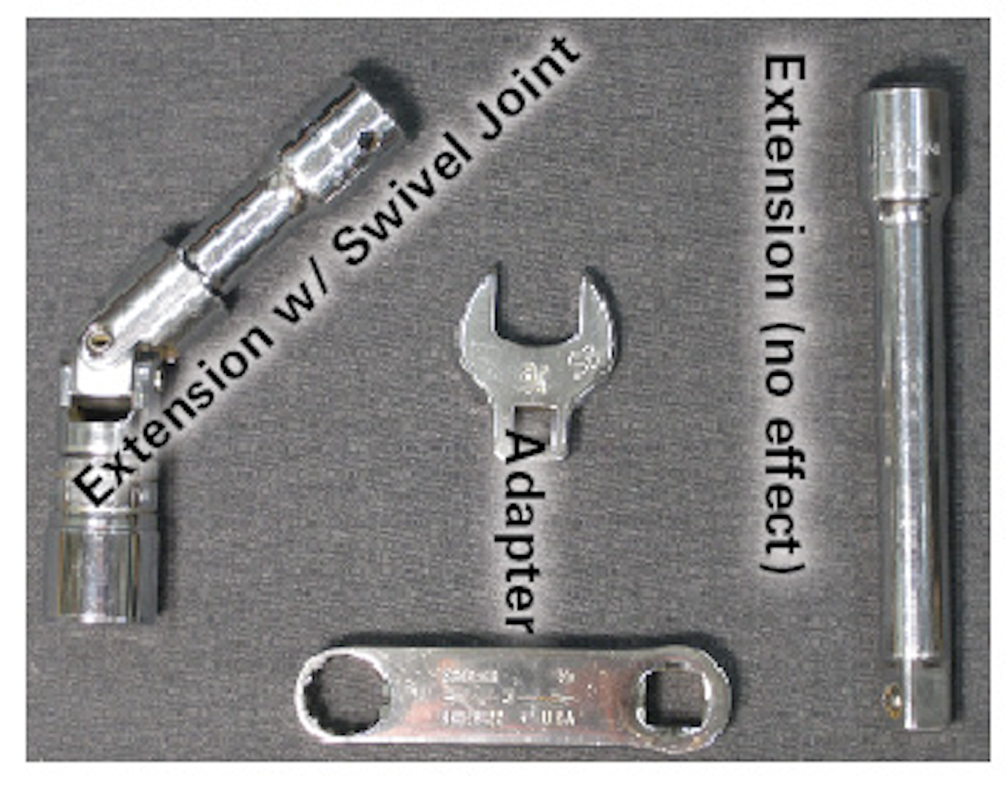

    https://www.utilityproducts.com/too...just-torque-values-when-using-torque-adapters
    FIGURE 2: In this orientation of adapter to wrench, NO adjustment is needed.

    I agree that adding an extension that doesn't change the length of the torque wrench does not require any adjustment.
    BUT I posted the pictures of what type of extension Will require a recalculation of the torque value.

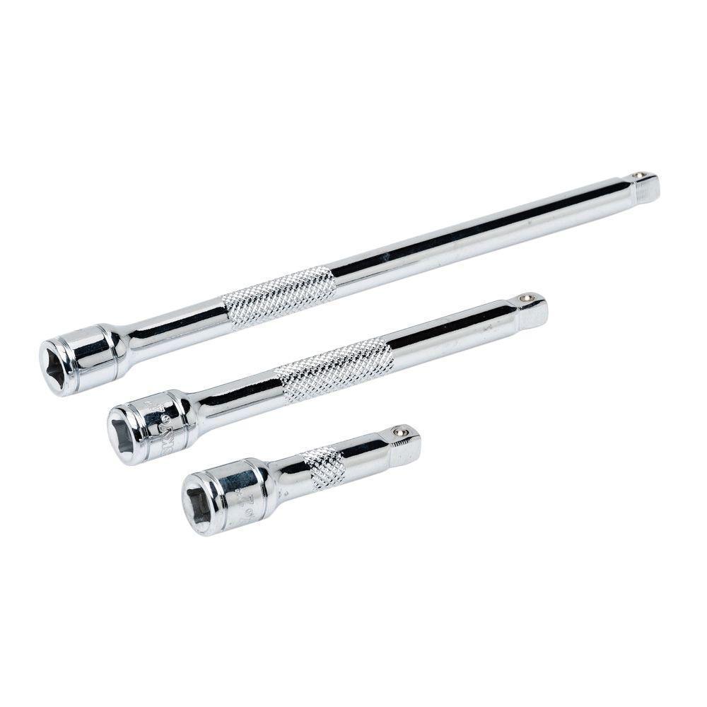

    What you are referring to is this type of extension:
    What I an referring to would be an adapter which may or may not effect the torque value depending on the angle it is installed on the torque wrench. If it is at a 90 degree angle to the wrench handle no adjustments are needed. But if it is in line with the handle ( as in extending the length of the wrench ) will require an adjustment of the torque value. A crows foot used at a 90 degree angle will not require a recalculation but if used inline with the handle it will.

    dog bones and crow's feet have the same rules. keep it at a right angle so you don't have to do math. if you do need math: (old wrench length/new wrench length with adapter)*original tq setting=new tq setting. tq setting should get smaller if your adapter increases the length of the tq wrench, due to increased leverage, and vice versa if the adapter is facing the other way. also measure to the axis of rotation of the nut/bolt head.
