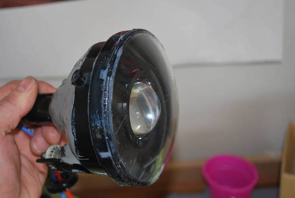

    Correct. Blazers from TRS. This was harder to do than the headlight retro, but I think they came out great, and absolutly worth it. Some people just cut out a hole in the back and stick the end through. I ended up putting the whole projector inside the housing. Then some plexi glass shrouds and presto:
