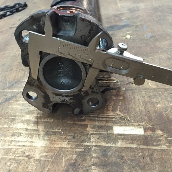

    Edited prior post with correct info. I'm no longer confused... :D

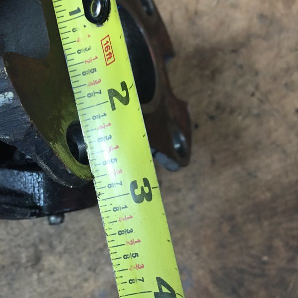

    I'm getting 1 13/16 here
    And 2 5/8 on all the flange measurements. Although the holes are slightly beveled so it might be a 32nd smaller. I can't tell for sure...

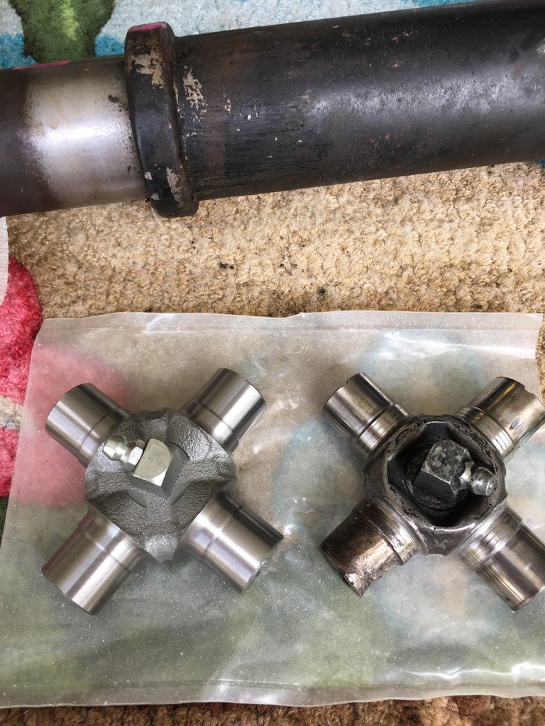

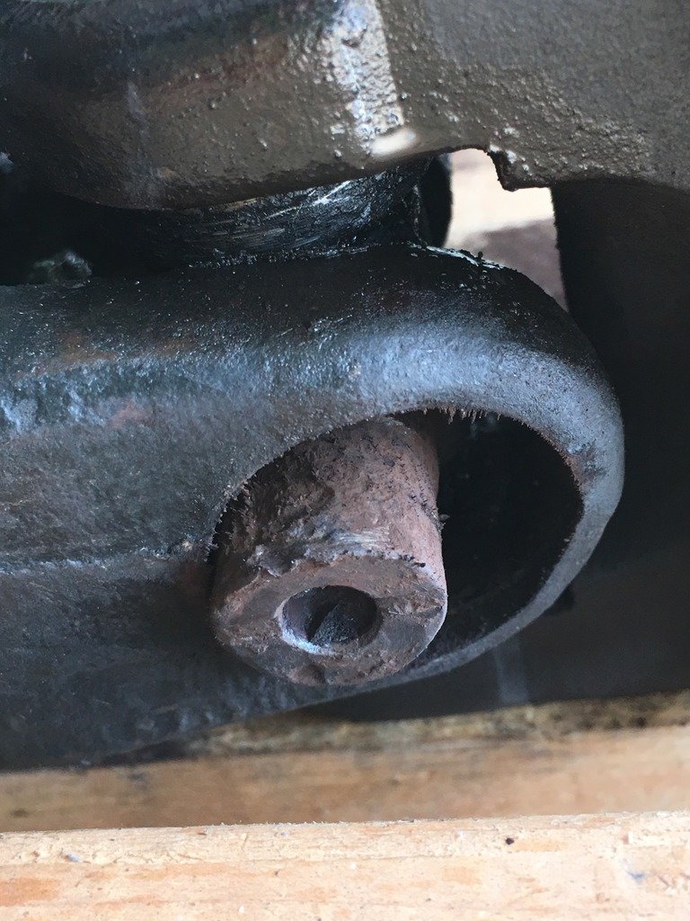

    Well, after taking the center support bearing flange apart 5 times and adjusting driveline angles and correcting a misplaced spline, I decided to replace the u-joint between rear driveshaft and rear diff:
    Opps, dropped something
    5709F81A-A45A-4E4A-A67B-689AE0A0A143_zps_1202e0c71df1a9e942782eadf29fee42be24a88c.jpg
    Somethings not round anymore?!?!
    5A14FB84-D44F-45AF-A8C2-D729AFF287C0_zps_99fed5e68273692e9c8a6d18f48630a674177415.jpg
    Awesomeness on left, not so awesome on right
    9015CAA8-553E-4672-84CC-279AF45BFE0E_zps_24a5d3e7b759058eff3cbb1cfc53db46a49ab85b.jpg
    After replacing -> vibrations gone, but driveline lash still exists...

    Jeezuz man, grease your ujoints please, at least once a month to be safe or more. Also, what brand ujoints are those? They look odd, not oem
    EDIT: oops saw your 1st gen
