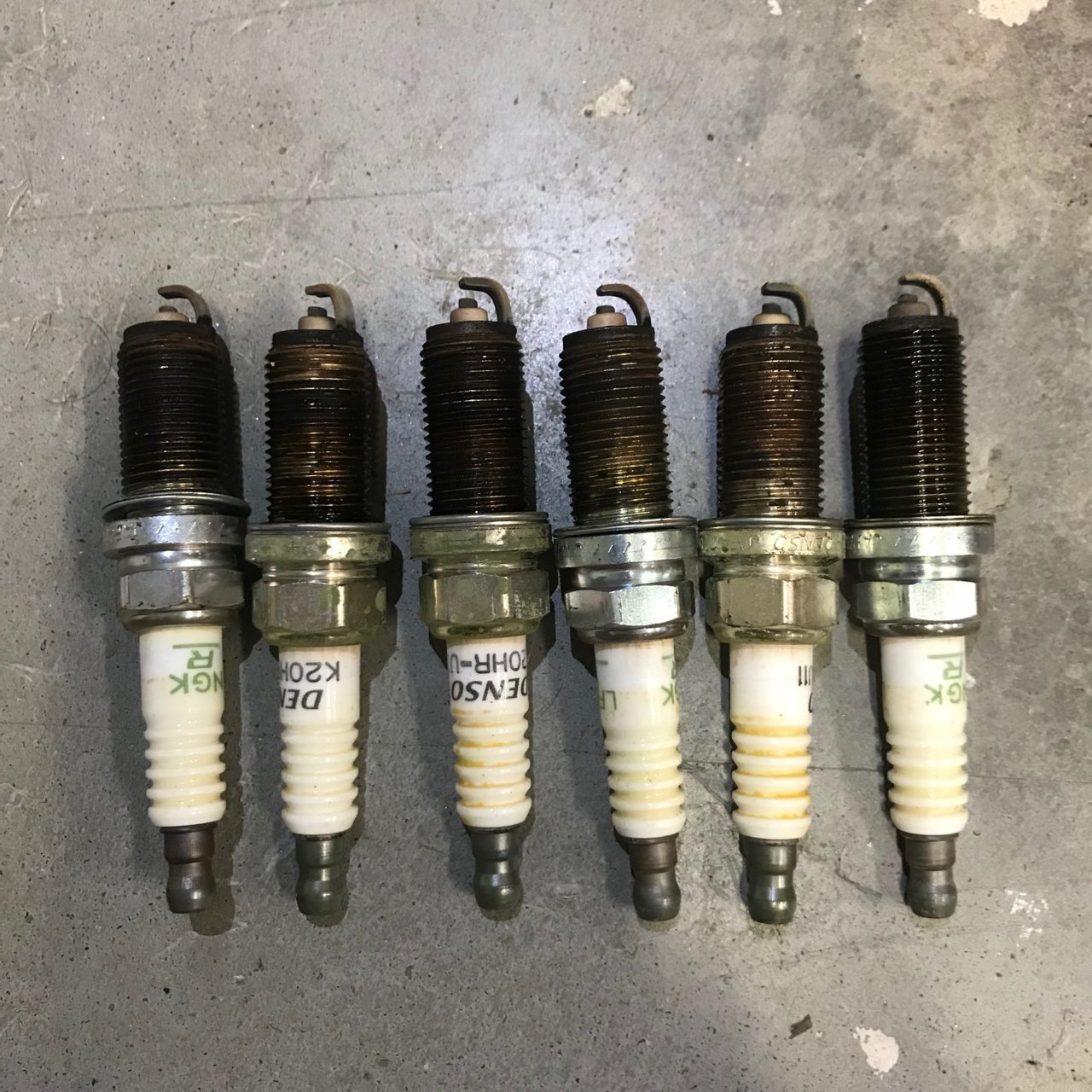

    Look into my mug and tell me what you see.....
    What do these spark plugs tell you?
    I changed them out for NGK LFR6C-11 @ 70K miles

    Tells me they probably have never been changed since there are 2 different types.

    Interesting that NGK electrodes appear more worn.
    Not that it matters, I run NGK in most of my stuff especially power equipment. I use the Densos in the Tacoma because that's what my dealer stocks and I'm pleased with their performance.

    OEM came with two NGK and Denso. Now you can decide whether to go back with copper or iridium.

    The threads, especially on the far right one, look quite oily to me...

    I noticed that as well, but since ive owned it I don't think its burned more than a half quart every 5k miles which seems normal to me.

    Yes, those plugs are Nickel Electrode Copper Core.
    The same as the OEM plugs.
