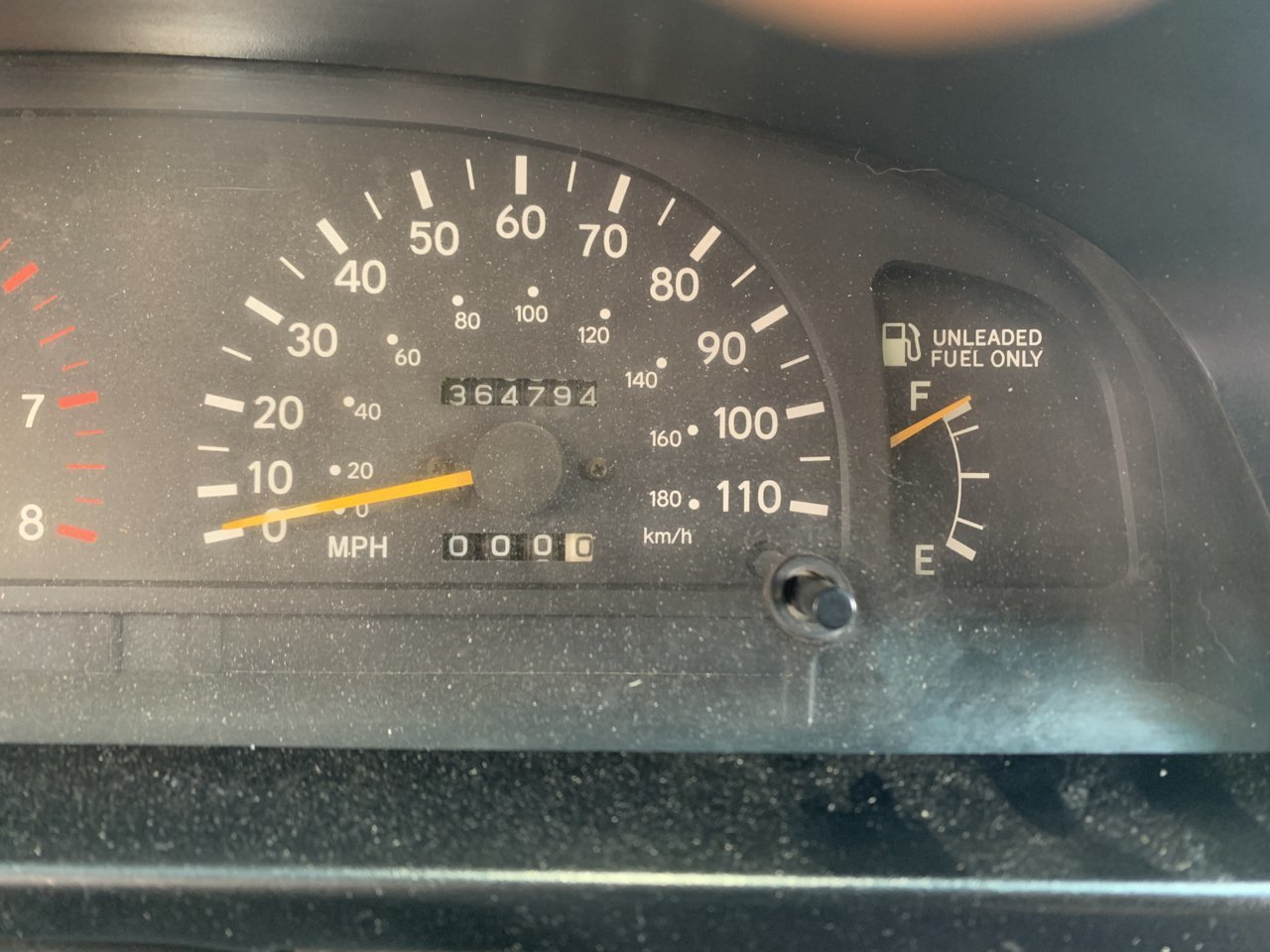

    96BlueTacos
    96BlueTacos トヨダ
    Jul 5, 2017
    #223188
    1,137
    Mikey
    Earth, 3rd planet from the Sun (CO)
    1996 Single Cab Taco Manual 4x4 3.4L V6 370k /1985 4Runner 4x4 22RE 200k /2001 Double Cab Taco Auto 4x4 Supercharged 3.4L V6 180k
    1996-JBA upper control arms, replaceable Cardan joint drive shaft, leveling kit, camper shell, trailer hitch... 2001- TRD Supercharged, TRD headers...
    You only get 150-175??!?
    I just clocked my mileage on a full tank to near empty. 271 miles on a 15 gal tank.
    Here are the photos to prove it
    I only filled up half tank this time because I was in a rush. Next time I’ll fill up full and do it again to confirm. But that’s like 18 miles a gallon

    Driving habits influence mileage a lot too. If you live in a rural area driving on back roads you’re probably optimizing your mpg with speeds not high enough to fight wind load and not sitting at lights or in traffic.
