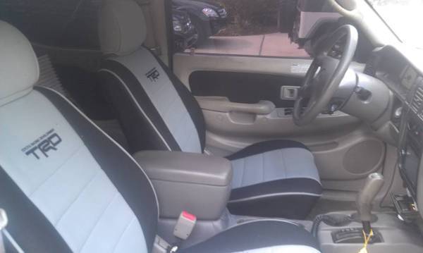

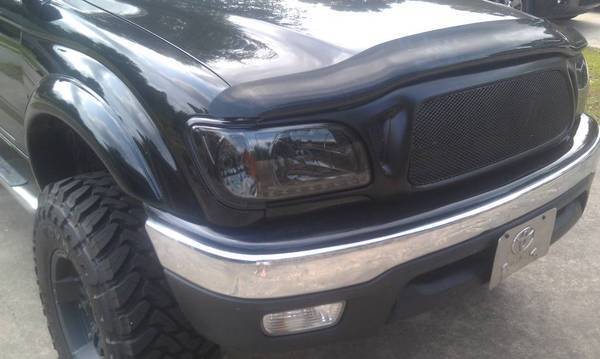

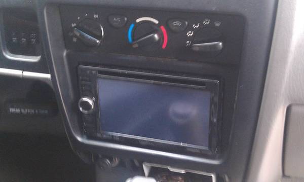

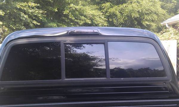

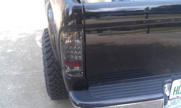

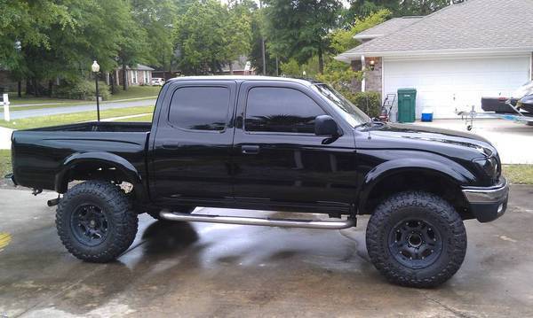

    So here is how it looks today. I am still waiting for my rear bumper, front plate bumper, and rock sliders.
    New Toyo Open Country 285/75/16
    New Smoked Headlight and Mesh Grill
    New Smoked Brake Lights
    Blacked Out Third Brake Light
    New Kenwood DDX470
    New Wet Okole Seat Covers
    Fresh Paint

    Looks good man, glad you see you back up and running. I have those same okoles, they're great!

    I know I love them. They look good and are very comfortable. I also had Wet Okole send me some extra material, so I could do my door panel inserts. I was surprised at how easy it was to do. I am thinking about doing my headliner next.
