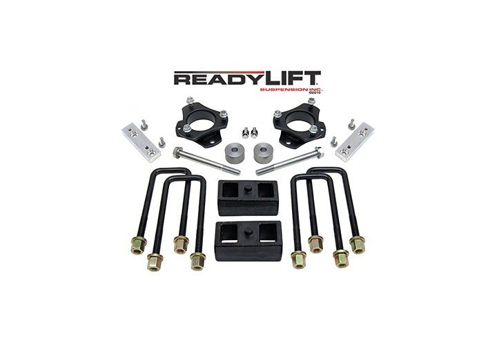

    I just installed a ReadyLift kit 3" in front and 2" in rear on my 2016 TRD 4x4. Had a alignment today hoping it would get rid of the horrible vibration,, sounds and feels like I'm riding on boggers...
    Nope it's still there,, have I ruined my brand new truck friends? I was truly hesitant on putting one on,,,I had no Idea a "leveling kit" could make a truck ride like complete shit. It pretty much only does it when I'm slowing to stop, like 20mph and under it starts.

    Driveline angle is out of spec. That's what is causing your vibs. That's why if I decide to lift I will be letting Toyota lift it. Even though they will charge an arm and a leg to do it.

    This^ you have drive line vibrations shim the leafs or add a carrier bearing drop kit

    It doesnt your alignment can be way off and it wont cause a vibration, but driveline angles out of spec will and block lifts are more susceptible to axle wrap then an add a leaf or a full spring lift.

    Driveline angle would be under acceleration from a dead stop or at high-speed's , 3 inch is pretty tall in the front could have a little flutter in the CVs maybe they popped one of the front CVs out when they were installing the lift hyperextended it and it didn't go back correctly. the alignment would have nothing to do with it . The alignment shop should've also recommended new upper control arms because with that much lift there's no way they got enough castor.

    Appreciate everyone's input I have an update for you! The vibration is gone come to find out my rear blocks were installed wrong. The smaller tapered end goes toward the front it's about a quarter inch difference or so if that. But it made all the difference I have no vibration now slowing down whatsoever, appreciate all the input guys!!
