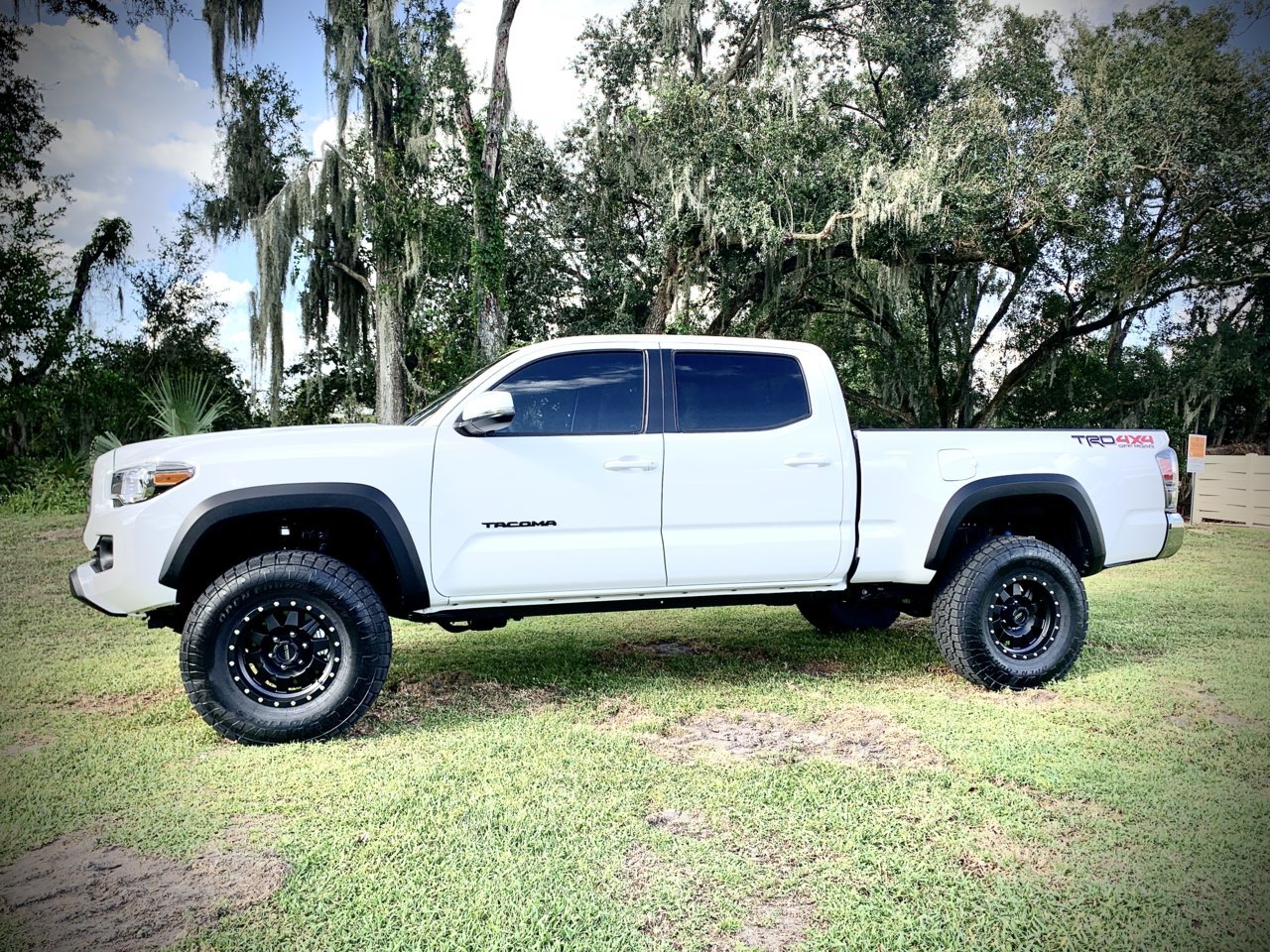

    I got the lift installed Friday. I went with Method standard wheels. 16x8 zero offset. I have zero rubbing.

    looks good man, probably could go even bigger on the tires
    I had this lift and all I can say bad about it is that the truck rode a lot rougher but the good looks was a great trade off.

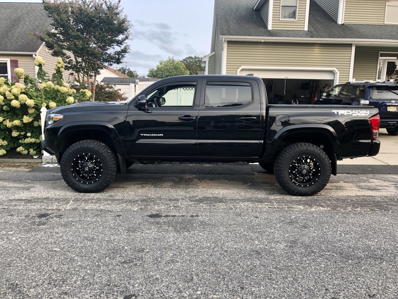

    3/2 Ready Lift with 285/70/17 Nitto Ridge Grapplers and 17x9 Fuel Krank wheels 0 offset.
    I have the same 3/2 Ready Lift installed on my 2017 TRD sport DC. Running 285/70/17 Nitto Ridge Grapplers on 17x9 Fuel wheels with a zero offset. Only had to trim a small amount from the front air dam. No issues with rubbing or clearance. Hope that helps. 63A0FF7C-B82A-4229-96C3-CEA11A4401C2.jpg
