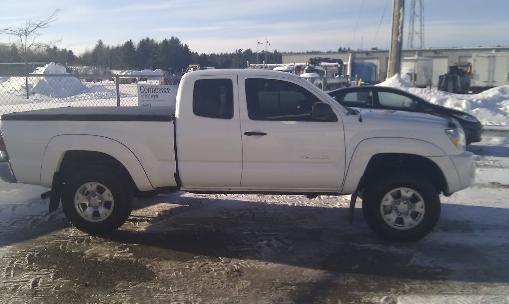

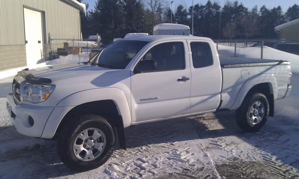

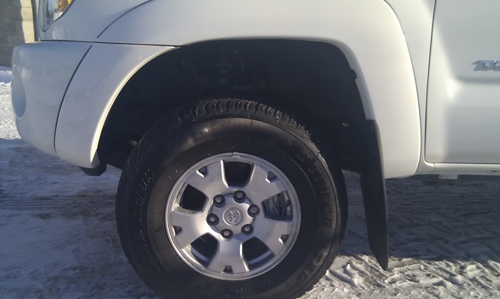

    Here's a few shots of my truck with the 2.25 inch Ready Lift levelling kit installed on the factory Bilstein strut. Rear is stock. Doesn't drive any different (ie not pulling to one side or vibrating) but I'm getting an alignment tomorrow just to be sure.
    I haven't installed the Spidertrax yet and I'm still not sure what tire to go with. I don't have any cash left anyway.:)

    i have the same lift in the front. looks good. if u get new wheels and tires- make sure u get the right size. when i got mine, the tires were a little too big and would hit when i turn.
