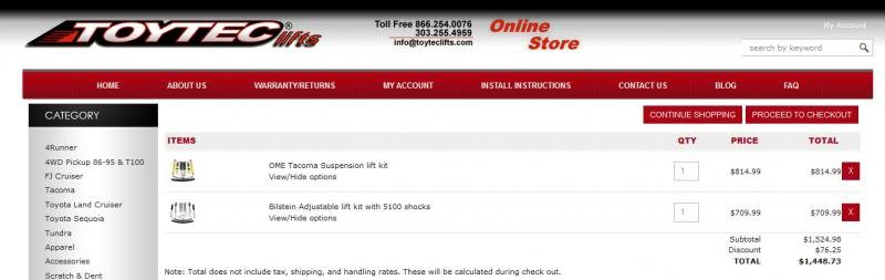

    OK, I'm finally getting around to swapping my 2.5" spacer lift for a "real" lift and have narrowed it down to either the OME kit or 5100/Eibach kit from Toytec...
    They are similarly priced (OME ~ $100 more expensive) so that's not a deal maker or breaker. I am rarely off-road and mainly want the 3" for clearing my 33" Duratracs although I do want my truck to be "capable" and not just a poser. I do get some rubbing at certain approach angles at full lock (mainly in reverse) but do also rub quite a bit when my plow is mounted. I run a SnoWay plow so it only weights ~ 300 lbs so it's not a huge amount of weight I need to support. I have a TRD Sport Double Cab long bed and am currently running MB TKO wheels that are 17x8.5 with -6mm offset. I've trimmed quite a bit of the inner fender and had to clip some of the fender flare to alleviate most of the rubbing. I'll trim more if I need to...it's only plastic...it'll grow back!
    My main questions is whether the choice of the two that I'm considering is more of a personal preference or if there are other things to consider. I spec'd out the 885 coils with the OME kit and am wondering how the Eibach coils compare to those?
    I've been thinking about this for a few years and have been researching this for the last six months pretty religiously. Just trying to make an informed decision and spend my hard-earned money wisely. Any help would be greatly appreciated. Thanks!
