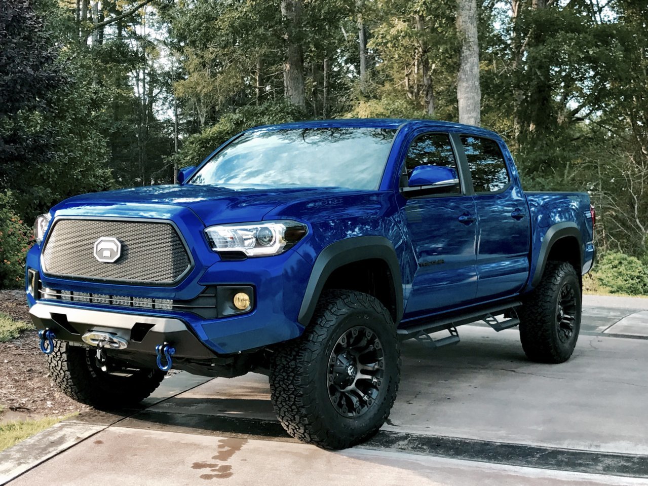

    BF2849A3-0EC8-4D48-8365-6E7A5B7EDC67.jpg I’ve had a full OME kit with 888 coils, soft ride struts and Dakar leaf packs and SPC Light Racing UCA’s on for two years now on mine and it’s been fantastic but didn’t break the bank. I hunt and fish and roam the forests a lot and it’s just what I needed. I also have a slimline winch bumper that he might find handy. My next thing will be getting rid of these damn predator steps and getting some sliders as I’ve nearly ripped the steps off about 50 times now. This is a freshly washed picture......gets pretty nasty come hunting season.

    OME full suspension kit with 888 coils and 1/4" spacer, soft-ride struts, full Dakar leaf packs, SPC Light Racing UCA's, Fuel Vapor 17's with Double Dark Tint, BF Goodrich K02's in 285/70R17, Tinted Windows, Headlight signal light smoke outs, Weathertech Mats, full audio system upgrade with JL Audio subs, JL Amps, Audiocontrol Processors and Focal K2 components, LED interior light kit, custom bedside decals, leather interior and heated seats and TRD Pro Tail Lights. SOS Offroad Concepts Low Profile Winch Bumper with Smittybilt XRC Gen II 9.5k winch with synthetic rope.
    The 1/4" spacers were to compensate for the weight of the bumper/winch so that I still had adequate clearance for the wheel/tire combo so they were for lift, the drivers side has the trim packer within the coilover. I'm getting around 3" of lift. My rear end sits at 24" hub to center for the drivers side and passenger is 24 1/4", my front end is 23 1/2" on both sides. I'm not getting any rubbing at all and did zero trimming, but that varies vehicle to vehicle and varies based on tires, etc.

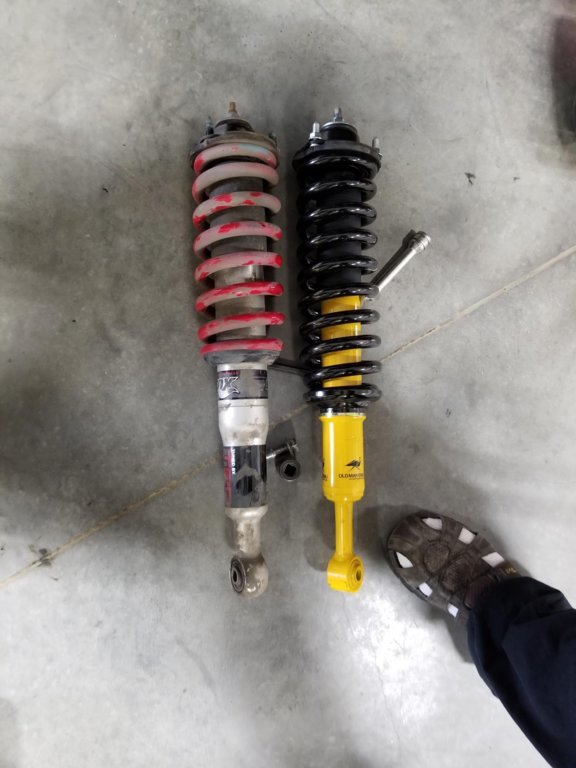

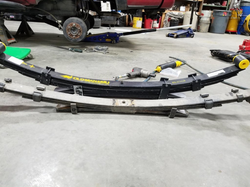

    Now for the list of money...I mean...parts and mods to this Cement 2018 DCLB OR with Premium and Tech pkgs.
    Toytec 2.5's with 650 springs in the front, 2.0's w/reservoirs in the rear with OME HD springs for a +2" lift. ECGS Clamshell, SPC UCAs, front diff drop, swap bar offset, carriage bearing drop, 5 each 17" SRS Ray 10s gun metal, 5 each Nitto Ridge Grapplers C-Load 285x70x17's, spare well modded to fit larger spare, front CMC, Total Chaos bed stiffeners, Factory TRD PRO Grill with factory correct garnish and longer harness, all 3 RCI bare aluminum skid plates, transfer case exhaust reroute for flush aft skid and better spare clearance, Toyota all weather mats, front tint, bed mat, mud guards (fronts now deleted) and A.R.E "Z" shell.
    I thank all the vendors for their quality products and fast shipping, but would like to give a special thanks to the guys at Tandem Automotive in Haltom City TX for their excellent and knowledgeable work putting this together for me. My highest recommendation! https://www.tandemoffroad.com/
