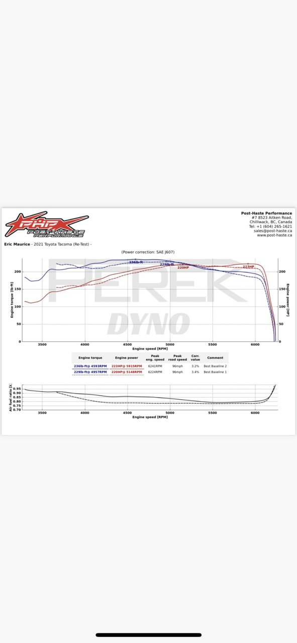

    Would to share some some info
    I have a 2022 Tacoma TRD Off Road, 3.5L, wanted some more power, 5 days from picking it up from dealer I got a OV tune last February

    So I wanted a bit more power and searched the internet, couldn’t find any real numbers other then specific product HP dyno numbers from the item itself and those number IMO are mostly lies and not real world number
    So I bought shit myself and paid for my own dyno

    First dyno-Baseline-June 10th 32000 km
    Weather-13 C and was heavy mist/light rain
    Doted line
    Second-Sept 9th-All parts installed
    Sept 9th
    Weather-25 C and clear skies and sunny
    Solid line
    15 ft Tq
    3 Hp
    I’m located in Fraser Valley, basically sea level, maybe 100ft elevation
    My thoughts on the upgrades:
    3500 rpm ish under half to 3/4 throttle feels great, I thought (as always) I had way more power but after looking at the dyno, looks like under 3500 I actually lost from stock and aggressive climb to my gains
    Ultimately I did gain more torque at lower RPM
    also to note-on the second dyno, they had a harder time to stay in gear-3rd gear- and took a few more pulls and yet the truck was on the dyno less still

    I know this is an old thread, but I appreciate your time and effort here. I was considering doing some of those mods, but an extra 3 hp and 15 ft-lb torque are incredibly disappointing. And 3 hp are within the margin of error. I really want to find dyno results showing these mods are worthwhile, but such evidence is severely lacking.

    Cold air intakes and throttle body + intake spacers are so over-rated it is almost comical. Ditto aftermarket coils, because the tiny amount of spark these engines actually need is ..... yup..... the tiny amount of spark these engines need.
