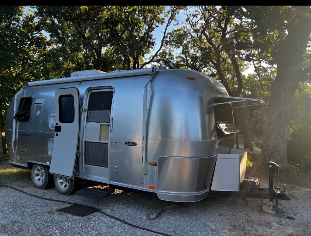

  7. Jul 25, 2025 at 8:39 AM
    p1zombiekiller
    p1zombiekiller [OP] Well-Known Member
    May 19, 2018
    #253978
    594
    Wes
    DFW
    2009 4x4 Access cab (Chocolate Taco)
    This is the one I am looking at.

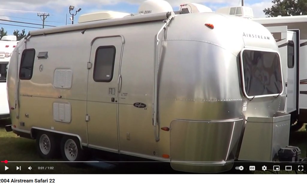

  8. Jul 25, 2025 at 8:50 AM
    YF_Ryan
    YF_Ryan Well-Known Member
    Feb 23, 2017
    #211450
    5,919
    Kent, WA
    2011 Silver Tacoma TRD Offroad, 2022 Honda CB500X
    Icon Coil Overs. Deaver U402 Stage 3 Leafs w/ Bilstein 5160s. ARB Deluxe Bull Bar. Fuel Boost wheels w/ Wrangler Duratracs. Brute Force Fab Sliders & HC Rear Bumper w/swingout
    That's not a 15 foot trailer. The one below in this picture is a 19 foot bambi. The one in that picture is in the 20+ foot range. I do see the logo you're talking about with what looks like 15 under it... but there's no way. I'm still doing some digging to see if I can find the one above, but that's gonna be much heavier than 3200 dry.

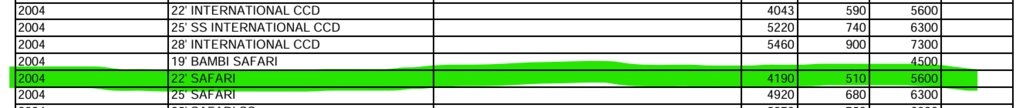

  9. Jul 25, 2025 at 9:03 AM
    YF_Ryan
    Feb 23, 2017
    #211450
    5,919
    Kent, WA
    I believe it's a Safari 22' LS, that's LS not 15 under the Safari plaquard.
    Per a PDF I found from Airstream, it weighs 4190, with 510 hitch weight (when empty), and 5600 GVWR.
    I'd definitely say it's towable... but WDH and taking it easy. But it's at the upper limit of what I'd want to tow with a Taco... and I tow a lot with a Taco.

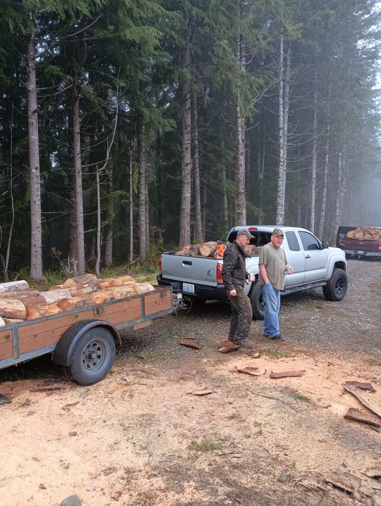

  17. Jul 25, 2025 at 9:32 PM
    #17
    Phaeton
    Phaeton New Member
    Dec 31, 2023
    #440607
    3
    2005 Access Cab
    3" lift, 33x12.5 wheels.
    I have probably 4500 lbs of firewood between the truck and trailer. The power was there but the suspension was maxed and the brakes over worked.
