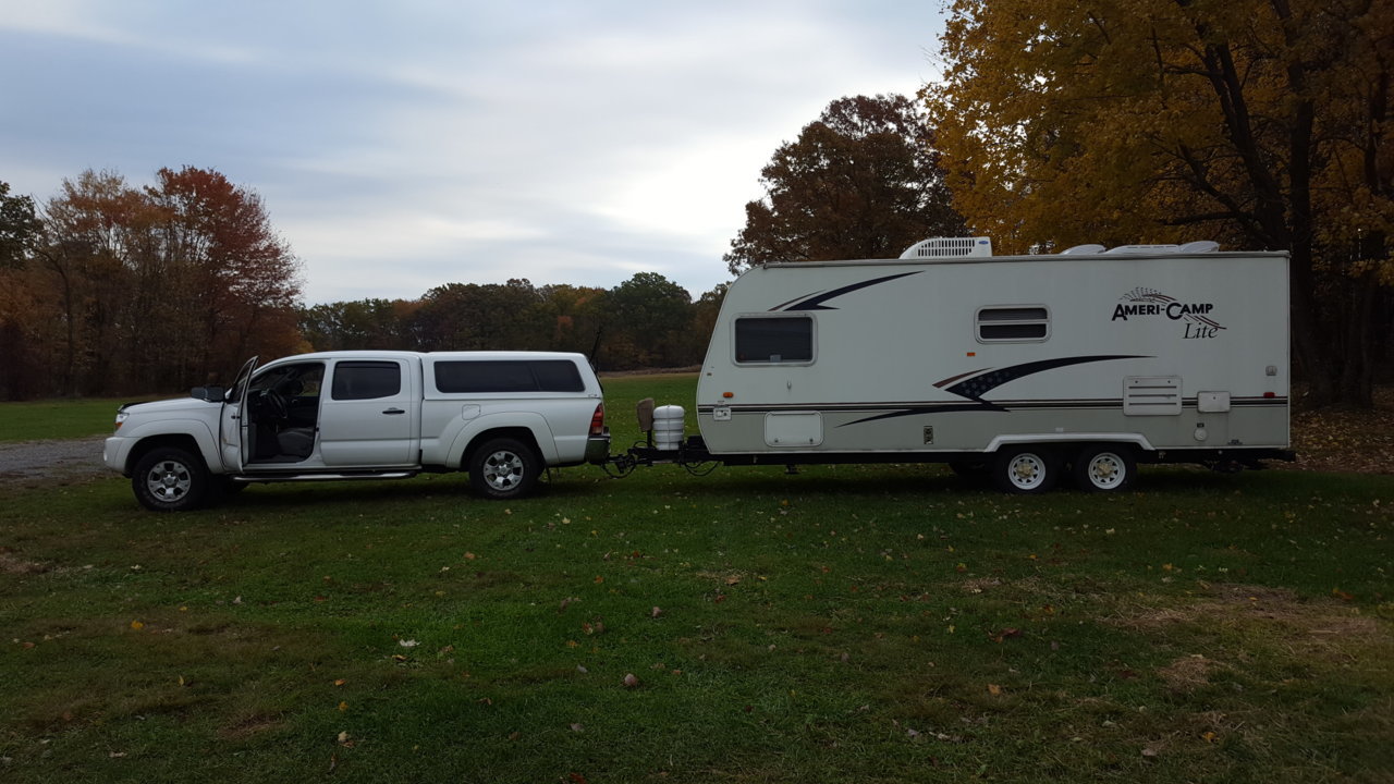

    Stevo
    2006 White Tacoma DCLB
    Maybe I can help....a little. I towed this for about 10 years. Many weekends. Through East coast hills and mountains a the flat areas of Ohio, Michigan, Illinois, etc. I never towed in anything but 4. Revs stayed higher than normal but the truck acted like it was made for it. Never had any issues with overheating. I had my first transmission flush at 60,000 and had my 2nd flush at 93,000 after I sold the camper. My trans, to this day, shifts smoothly and flawlessly. Truck camper 2.jpg

    2,294
    How much did "this" weigh?

    382
    Stevo
    Between 4 and 5,000 depending on what I had to load due to camping area and how long I was staying there. Mostly fields and remote lots. always had the truck loaded too. 3-4 dogs in the back in RuffTuff kennels which were anchored. I was a field trialer. Bird dogs are a blast!
