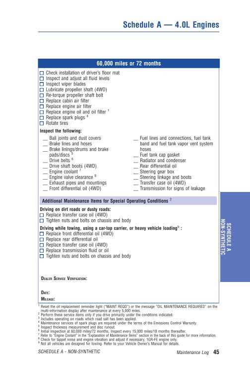

    Literally says right in the manual, Replace fluid (ALL 11ish qts) every 60k.
    That stated, i have a neighbor with two first gen tundras with the same 5 speed we got.... something like 200+k miles on em never been touched. Not that i would do that ever, my truck sees way harder use than his, so they are a tough trans... but still "lifetime" is a joke, and not replacing fluid is stupid.

    This is straight out of my Maintenance Guide for my 2015 TRD Off Road
