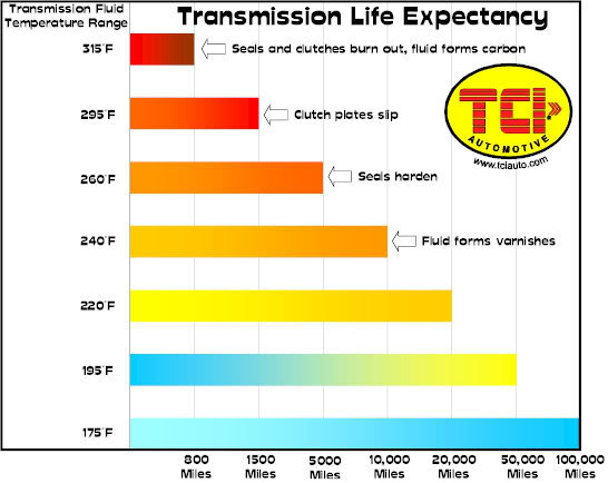

    OP look at this.....
    /thread

    I’m at 143,000 miles, most of those (probably about 100k) are highway miles pulling about 3500lbs of trailer, some of those miles in over 100degree weather, some in the Rocky Mountains. I also tow a 16’ double axle loaded up with hay or other farm equipment here and there. I did a full flush of the atf fluid around 60k to replace the factory stuff with Valvoline MaxLife, and have done two drain/ refills since then (I made it part of my 30k maintenance)... because with the stock cooler the highest temperature I saw on my gauge was about 220 or so and that had me worried. I would get over 200 degrees sometimes in the harsher conditions due to mountains and or temperature and I had this chart in my head:
    However after some digging and thinking I came across a thread on one of the 4 runner forums that addresses temperatures with the WS fluid our trucks use, and they wrote Valvoline with their concern about having reached 240 degrees in his case. Valvoline wrote back saying basically hey don’t sweat it, this new fluid can handle that.
    So that made me worry less though I do still mind my temps and change my fluid. But what I’m saying is the standard chart like the one above that talks about the risks of fluid temperatures doesn’t seem to apply to our fluid. If this is in fact the case it would be nice if someone made a chart for our fancy synthetic WS fluid.
