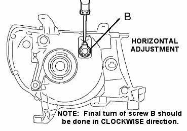

    How do i do this :confused:

    I don't think you can (presuming the main headlights). I need to mess with my drivers light but the front reflector piece is bent in causing it to aim high... I need to take it apart anyway as it fogged up the other day. I might be wrong though

    There are some screws to turn and adjust. I'll find my info on my computer.

    Thanks chris, my damn computer shut down. lol.
    This one pictured adjust left/right
    The what appears to be an allen, to the diagnal left, adjust up/down.

    Awesome, thanks for the document Chris, as always you got it down :D I'd add rep but it won't let me yet...

    you should only adjust vertical, you should leave the horizontal alone. Unless it is waay off like aiming at the sides of the road.
