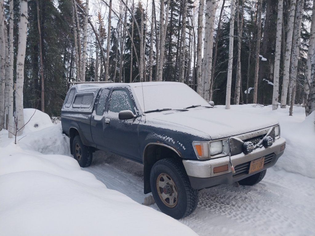

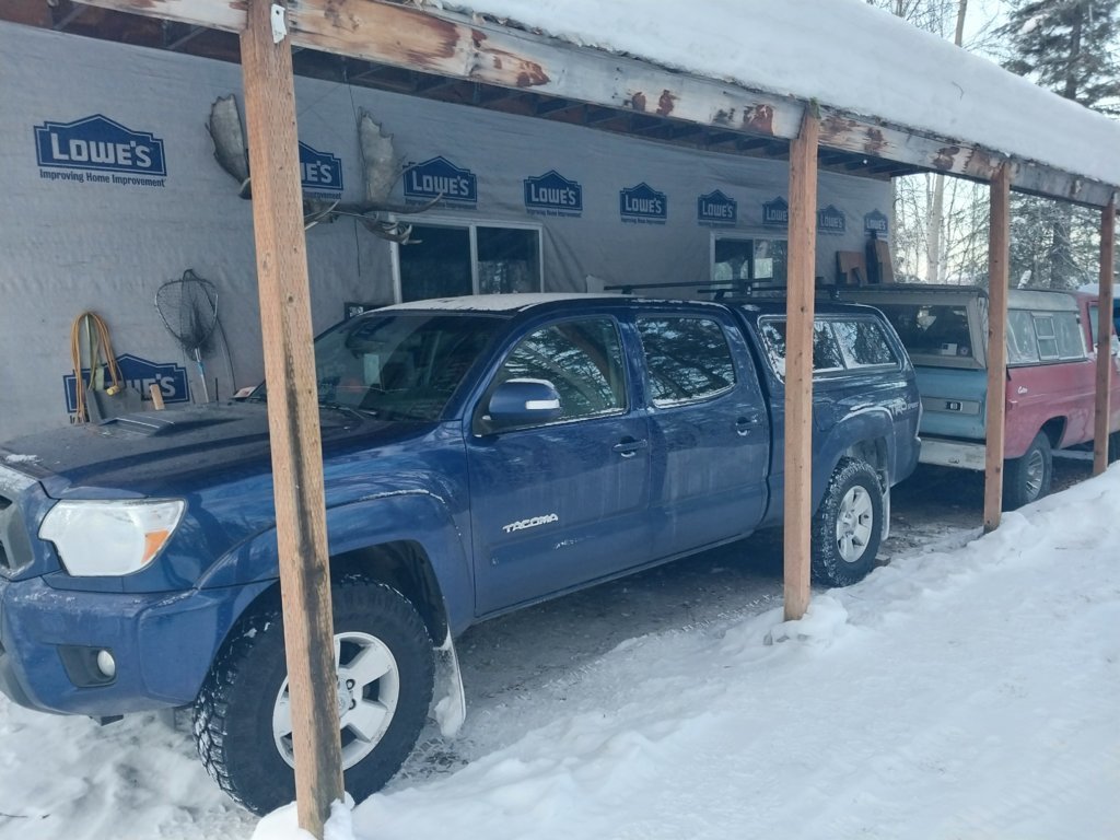

    I recently bought a 2015 Tacoma, DCLB, V6, auto, 4x4, 97k miles, no lift, 265/70R17, with a topper.
    What kind of gas mileage should I expect with this set up?
    I was under the impression that gas mileage would be similar to my old 89 ext cab, v6 4x4 (I've gotten as much as 22mpg with that one), but after driving it home from 300 miles away, I'm wondering. I'm think that the old yota would have done a couple of mpg's better, but not sure.
    Before starting the trip, I did just a little bit of driving around town, then got on the highway. When the trip odometer read 70 miles, I decided to slow down and drive with the CC set to 55. I stopped for gas when the trip mileage was around 200. I calculated my mileage to be about 17 mpg. I expected a little better than that, even under the conditions. I was bucking a noticeable head wind most, if not all the way. Temps started out at about +15F, and got colder as I went north, I believe it was -25 when I got fuel. I was not using 4wd much.
    Maybe the headwind impacted mileage more than I expected. I just thought I would see what others are getting with comparable rigs.
    BTW, I did search. I found a number of threads on the subject, but a lot of people chimed in with rigs that were not comparable ie: lifted with big tires, not 4wd, different engine, etc.

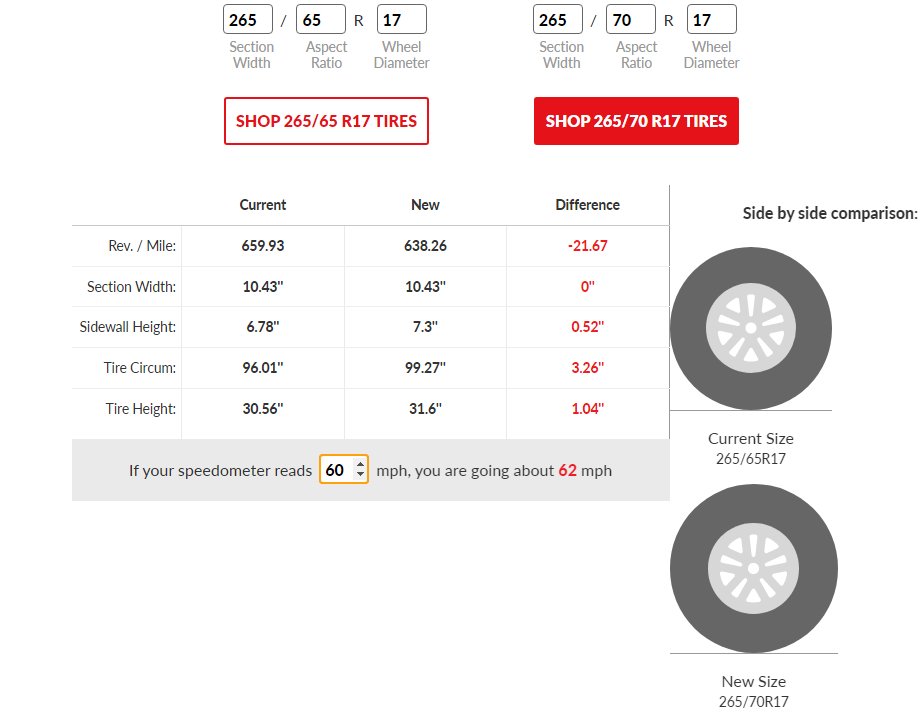

    I'd add tire choice as well. My Access Cab has 265/70R17's (stock is 265/65R17) and, since speedo's read a bit high with stock tires, the added diameter has my speedo/odo spot on. I typically see a 2-3 mpg drop with "winter" gas but highway mileage can fluctuate between 17-20 depending on conditions and speed.
  15. Jan 9, 2025 at 4:09 AM
    Sub-arctic Toy
    Sub-arctic Toy [OP] Member
    Aug 8, 2024
    #454783
    20
    I checked my speedometer against GPS. I was impressed at how close it was, about 1.5 mph off at 60 mph. Speedometer read low compared to GPS, IIRC.

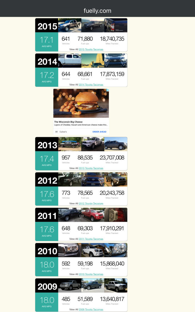

  16. Jan 9, 2025 at 6:31 AM
    #16
    MSgt O
    MSgt O Well-Known Member
    Nov 4, 2020
    #345824
    1,200
    2013 Tacoma
    ABA180 and Sub-arctic Toy[OP] like this.
