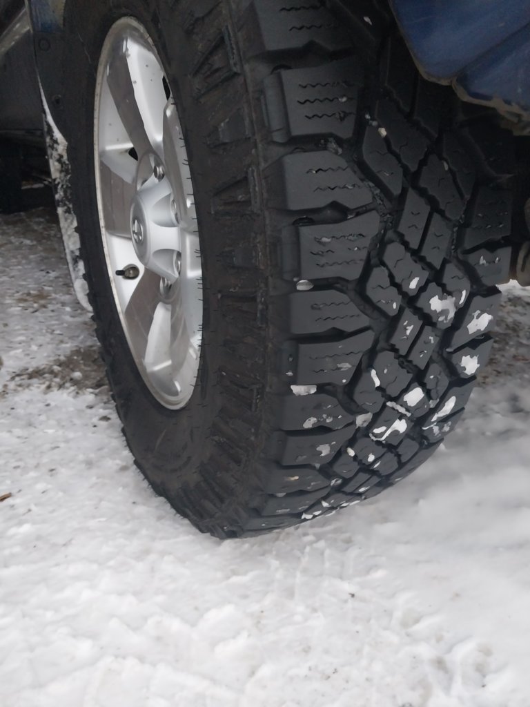

    I just checked my tires on the Taco, they are Goodyear Duratrac M&S, they are somewhat aggressive. As far as oversize, if I understand and remember correctly, 265 is the diameter, which is stock. 70 is the aspect ratio, which means they are wider than stock. I wouldn't think the width would affect mileage so much as the diameter.
    In case anyone is interested, so far I'm impressed with these tires on snow and ice.

    I'm certain this was a typo as you seem to know what you are saying, but 265 is roughly the width of the tire in mm- not the diameter. It is reasonable size and not much larger than stock, but that tire specifically is heavy. Skinny tall tires may yield better snow performance and modestly improved economy thanks to being a few lbs lighter.

    Another Dude, my memory failed me.................again. I had it backwards. Thanks for correcting me.
