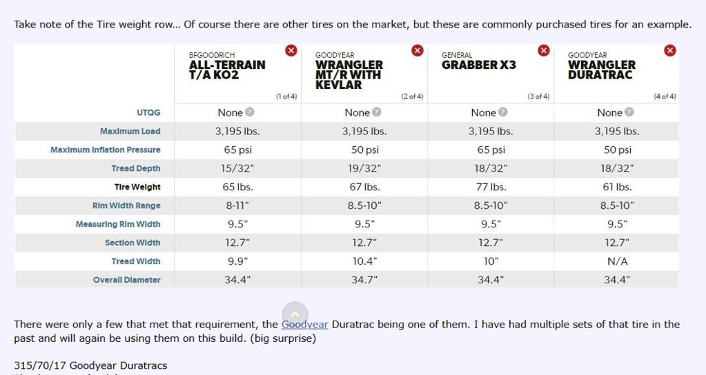

    to everyone saying duratracs are heavy, i remeber in @Ripcord build he compared weights of many tires including duratrac, and theyre the lightest, and why he choose them originally
    heres screenshot
