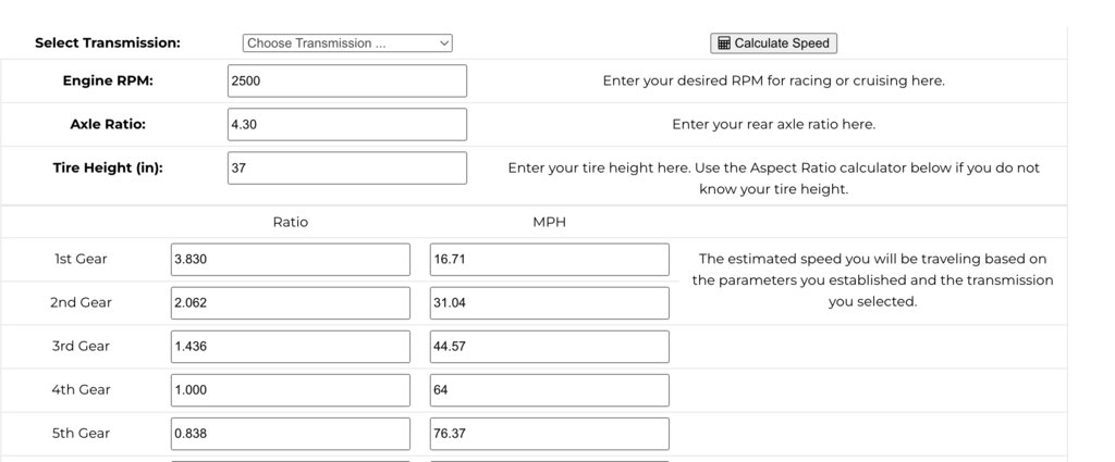

    Now that you know my driveline idea, here's where things get interesting. In the front axle I have a 2002 4Runner E-locker with 4.30 gears, and the rear axle is from a 2003 Tacoma with a factory locker, which has 4.10 gears. I am not driving the truck right now, obviously, so don't worry about the different ratios quite yet. One or both of them is getting re-geared.
    For the tires, I'm pretty sure I want to run a 37 inch. Which one? Haven't decided yet. I think it would be a good size with the 6" lift and would give me lots of clearance without being overkill. Regarding the engine, it looks like the sweet spot for highway/freeway driving with a 1UZ-FE is 2400-2600RPM. I've split the difference here and done my calculations with 2500rpm.
    With the R150F's gears, and using my front differential's 4.30 gear ratio for my calculations, it looks like I can find a sweet spot for highway/freeway at around 75mph.
    And with that, we come to the point where I need help. I have read lots of posts, both here and other forums, about how much Toyota pickups struggle to run a 4.10 gear ratio with 37 inch tires. I think this is usually in regards to stock engines in the 1979-1995 pickups, which range from the 20R to the 3VZ-FE.
    With this in mind, and the understanding that I have a 1UZ-FE, is it reasonable to assume that the 4.30 gear ratio will be good for my truck? I would not want to sacrifice any more speed if possible since the freeways in my state are all 80mph. This would also be nice because I would only have to re-gear the rear differential.
    Are there any concerns (other than starting-from-stop low end power/torque) that I should consider when running 4.30 gears? Am I missing anything?
