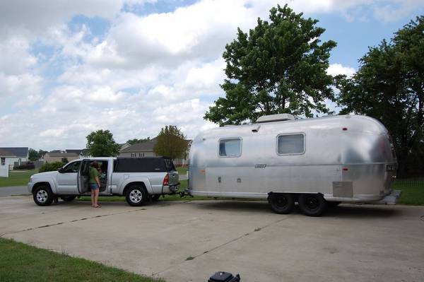

    I tow a 1972 23ft Airstream with mine. It weighs 3500lbs dry, I am guessing it weighs 5000lbs loaded with 2 adults, 2 kids and 2 dogs. I use an Equalizer hitch and the truck sits level. After a 2,600 mile tow from NC to MI (and back) I can say the Tacoma is a great match for this size of trailer. I averaged 12 mpg if I didn't go faster than 65.
    The Airstream has a 550lb tongue weight. I do not have the rear spring TSB. With my Equalizer (weight distribution hitch) set up properly there is no need for air bags. A properly set up hitch will spread the weight equally over all axles.
    I used the videos from etrailer to set up my hitch.
