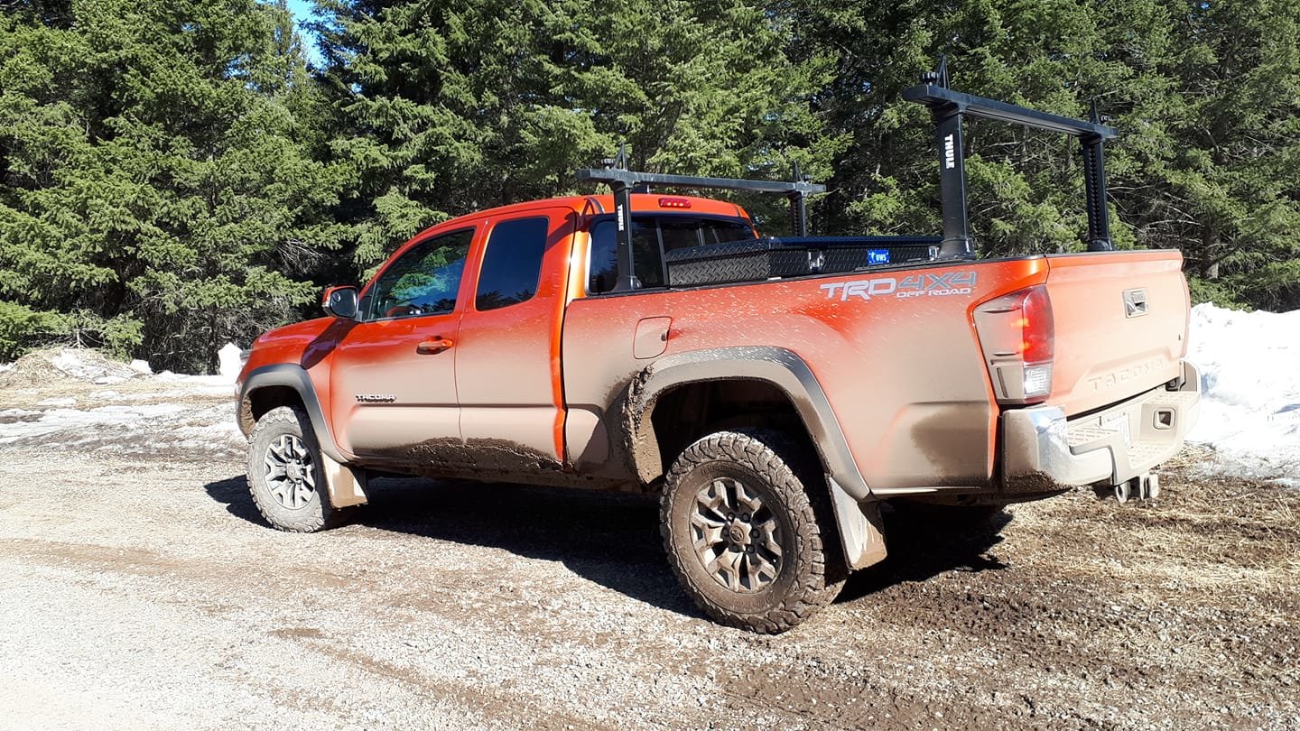

    Just added toolbox and roof-rack to haul my fishing boat 100's of miles into the backwoods every week. Goodrich K02s, Bilstein 5100 front and back, no lift.
    Just keep them clean with a high pressure power spray, and the silicone spray or WD-40 if needed.
    Mine squeaked madly all day long even on pavement. Until I started cleaning them after every off road trip. For me that is weekly.
    Even with this crap mine no longer squeak as long as they are kept clean.
