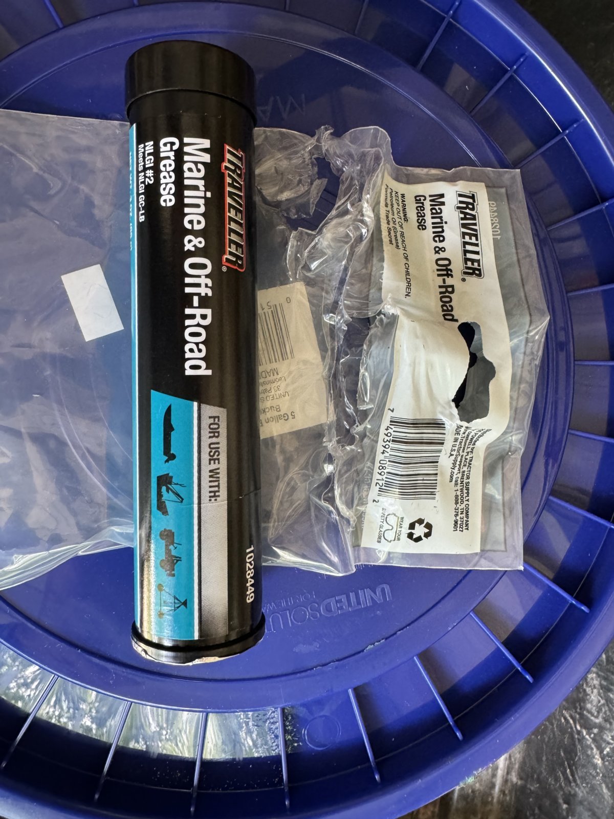

    I was thinking of using some of this grease I use for the ATV on rear suspension components bushings leafs etc. Any reason I shouldn’t? Or specific parts yes or no. ‘21 OR

    I am off road every week. Just pressure wash them. No grease or lube needed. Mine squeaked like crazy too, until I kept them clean after every off road trip. Zero squeaks in the last 5 years.
