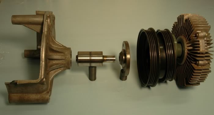

    Before you go past it into the timing belt area check what Toyota calls the "fan support bracket". You will need a stethoscope, real or improvised.
    If you buy it from a dealer you can only get it as an assembly including a fan clutch and pulleys. Get just the bracket from a parts house that sells Aisin. The bearing that fails (shown pressed out) is a proprietary unit, not available separately.

    Thanks for the pic. I'll check that.
    Before I move ahead, I should meantion that I have the fan off, but the nuts tightened. Is there a chance That this could be causing the noise?

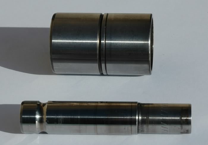

    Not sure what type of sounds you have but on the 3,4 a failing fan support starts with a sound exactly like a slipping belt or a dry bearing, kind of a squeal or shriek. It usually surfaces in cold weather and goes away after a few minutes. The bearing can feel nice and smooth but still make the sound.
    If you don't have a stethoscope ($5 at HF) just stick a good sized screwdriver tip on the housing and put the handle to your ear, you will know right away. Without the fan in place it should be quick and easy.
    The "assembly" from a dealer is $400+. The fan support alone from an Aisin dealer is around $130. Avoid the Chinese knock offs, if they will even bolt up they don't last long.
    This is the shaft (also serves as the inner race), it had 1 row of ball bearings on the left and 1 set of rollers on the right.

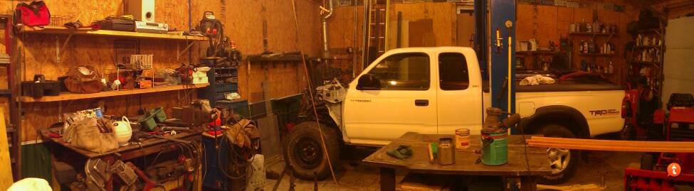

    A bit off topic, do I see "supplemental" foam insulation panels on your garage door? If so did they make much of a difference?

    I've been thinking about that. They are insulated, tho. The shop is heated with hot water tubes in the concrete. I keep it at 50*, feels much warmer when your feet are toasty. I got a pretty nice playground.
    When the wife gets pissed at me and sends me to the shop, I ain't suffering too bad:)
