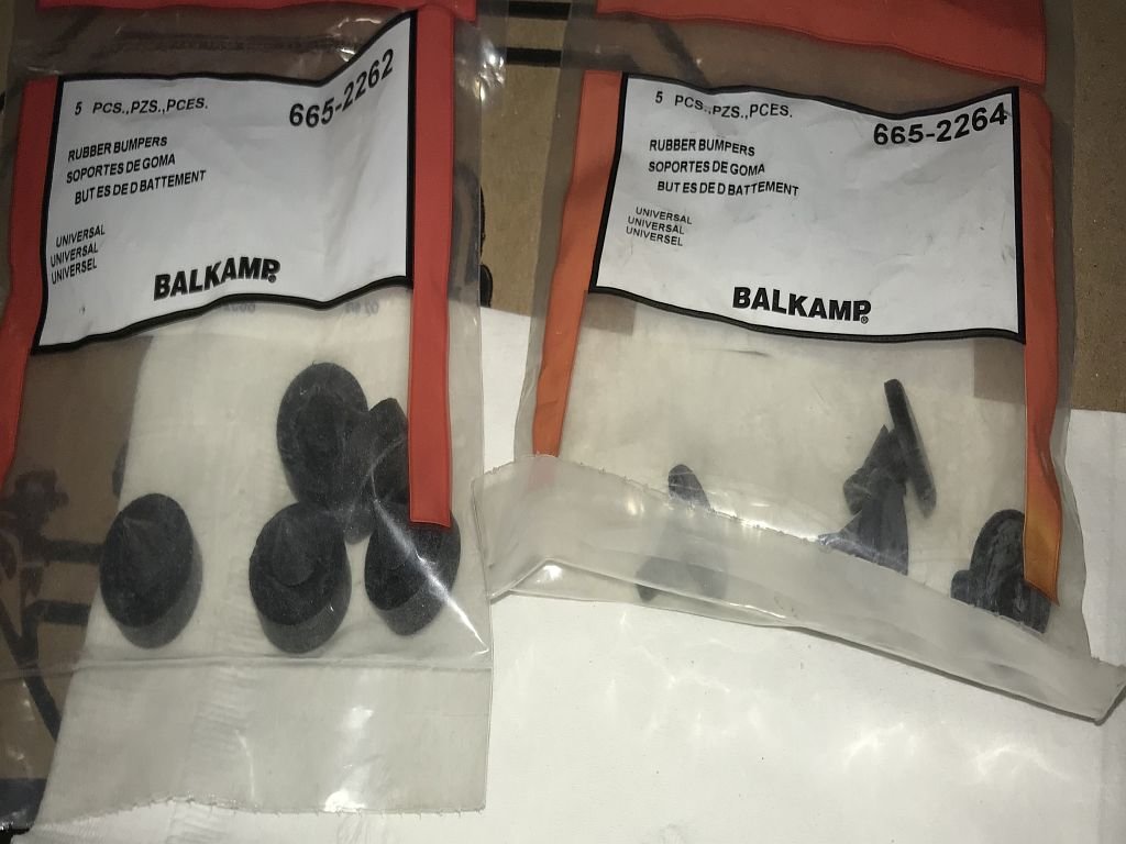

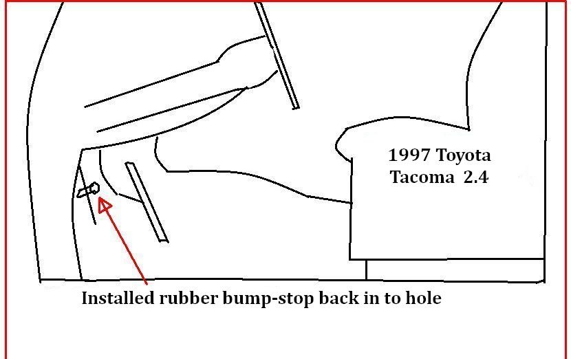

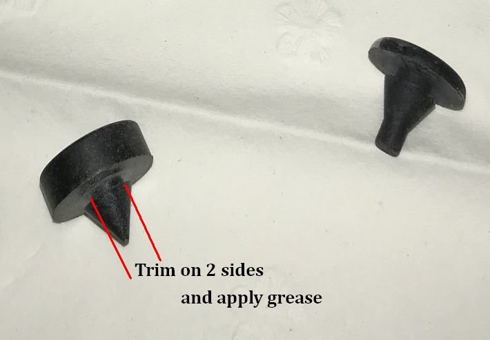

    Rubber Stop 004.jpg Rubber Stop 003.jpg Gas Pedal Adjust.jpg Rubber Stop 003.jpg Rubber Stop 004.jpg
    I had most of the normal maintenance done to correct my low idle problem. Thinking back though, I remember finding a rubber piece on the floor near the gas pedal. I just looked around but could find nothing wrong. I started hearing a slight click when I let off of the gas pedal. One day I got under the dash with a flashlight and saw a small hole behind the gas pedal return arm. I reasoned that if this rubber bump-stop was missing, the gas pedal might be going too far and lowering the RPMs to the point of stall/dying. I know the AIC can also be the culprit but the rubber-stop needed to be replaced anyway.
    I bought new rubber pieces that I thought I could never find. As it turns out they can be purchased for about $5 for a bag of 5.
    I unscrewed 2 screws at the gas pedal spring, and moved the accelerator apparatus off to one side.
    I opted for the same size rubber and after some grease and small cuttings, at opposite sides, the nipple finally went in to the hole and now it works as expected.
    Sorry about all the duplicate pics. Not my fault.
