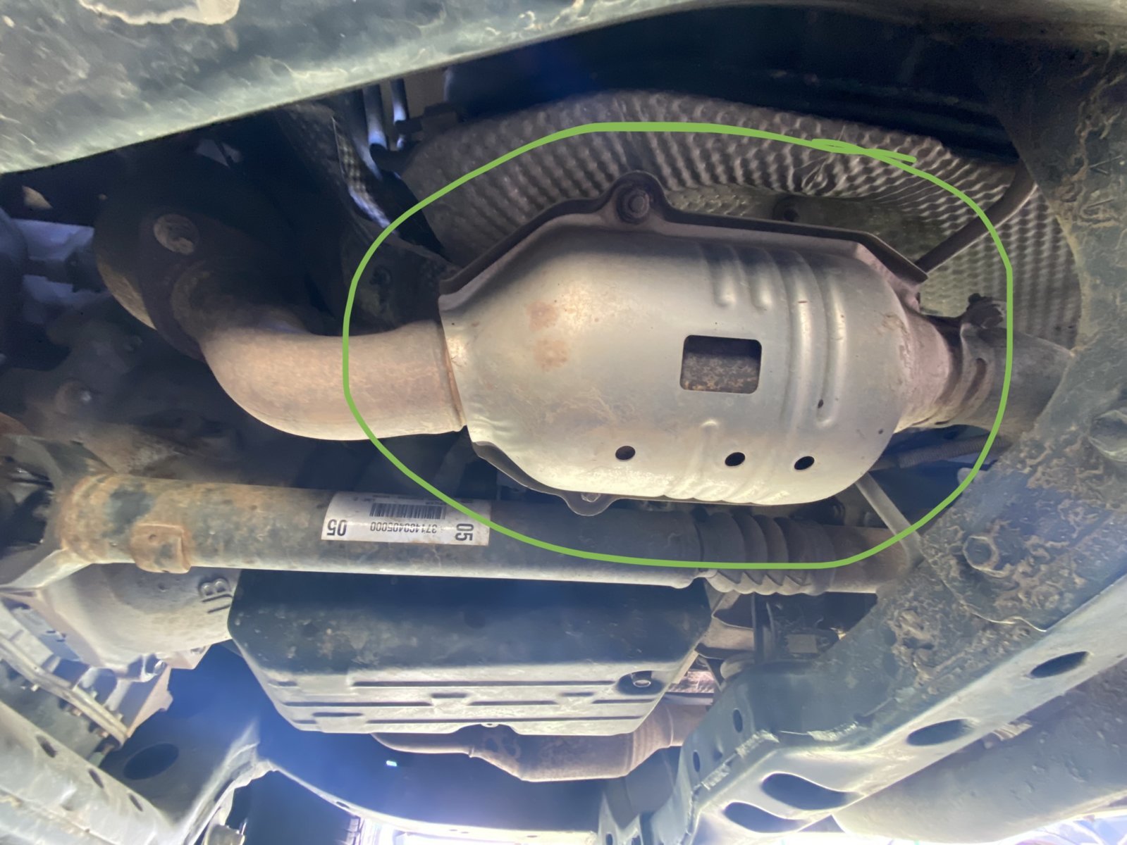

    Update:
    Changed spark plugs, cleaned MAF and throttle body (which was extremely dirty). Seemed to help a bit with the vibration. But still having a rough shift into drive and reverse and idling roughly when in either of those gears. I can very clearly hear the shift happening in the transmission fluid box (not sure what the correct name is)
    I also hear a slight whining sound coming from this part circled in green... there’s is also an O2 sensor in front of it upload_2024-5-18_15-28-21.jpg
    Planning on doing rotation and rebalance tomorrow. Not really sure what else to check at this point since there are not any lights coming in the dash indicating any issues… not at this moment at least

    That is a catalytic converter protected by a heat shield. It is very common for those heat shields to become loose and rattle. When its cool, grab it with you hand to see if it is loose. The catalytic convertor isn't going to make any noise, but a loose heat shield will.

    I am not sure what is common for a 4cyl, as I have never worked on one. I would think there is a high probabilty that the heat shield design is common between a 6 and 4 cyl. On my 6cyl, the bolts holding the two halfs of the heat shield rusted out. I just bough new boths, painted with high temp paint, and then installed them. I've read a few owners just pulling the heat shield off completely to reduce the rattle. If you grab the sheild with your hand and you can move it, that could be a source of the noise. The shield should not move around on the cat.
