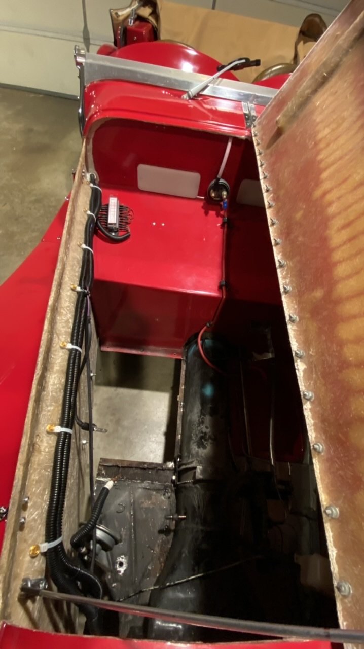

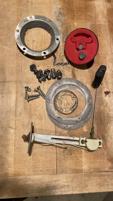

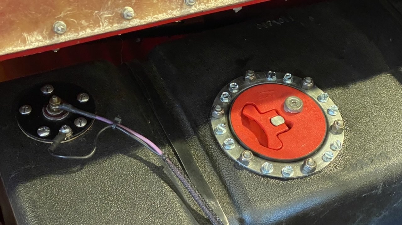

    But when I put gas in it it was seeping bad at the top of the tank and I had to tear this all apart and completely regasket it.
    Here’s what it looks like after I added 13 new screws and some internal back up to the tank.
    That red plastic Wisco brand fuel cap is unfortunately quite old. It needs replacing.

    I got the fuel tank to seal up tight which Is a real joy. Unfortunately I messed up the fuel sender somehow. It appears to be a loose ground at the gage.
    Anyhow I put some gas in it and took my wife out for a ride today. It starts instantly and runs good when cold but as it warms up it starts to get rich and load up at idle. I think the float may be a little bit heavy with dry gas and also I think the main jet and idle jet are slightly clogged & the idle air bleed is very clogged.

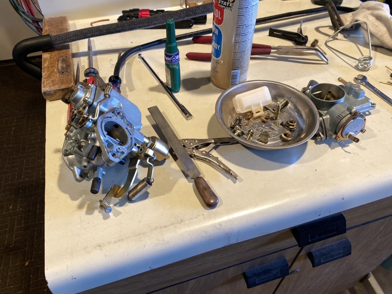

    I took the carburetor and distributor out and overhauled them both.
    Actually I just cleaned the distributor up and put it back in after straightening out the bent clamp. What moron…!
    It was in perfect shape. The carburetor was a different story.
    Every hole in the carburetor pointing towards the sky except the Venturi was plugged with dirt. All the air bleeds just simply plugged. The main jet was half plugged & the carburetor was full of dry gas residue.
    I spent some time cleaning it up and flat filing the base. I also flat file the manifold so everything would seal 100%.

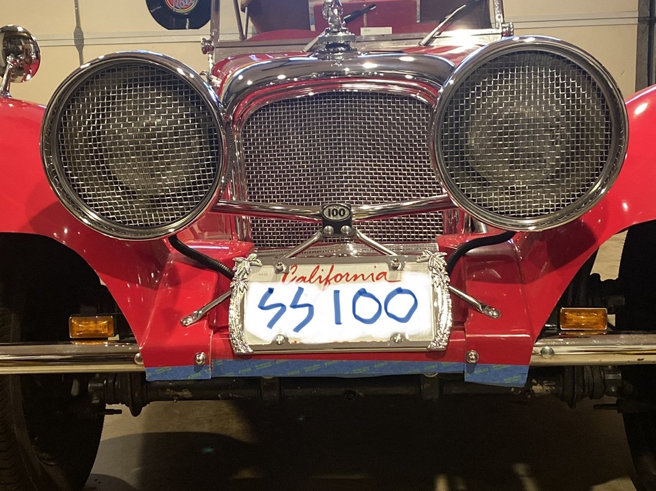

    I got the plates mounted, but the rear mounts still need reinforcement. The front looks better after trimming the crooked fender tips to match. I did this with a pneumatic cutoff wheel, and then board-sanded it even by hand. Unfortunately I took pics before the touch up paint.
    before: Marking with blue tape really shows up the ugliness. How come the previous owner never fixed this snaggletoothed mess?
    after:
    I retuned the carb and it’s running well in the garage. We have been too socked in with fog to go driving yet.

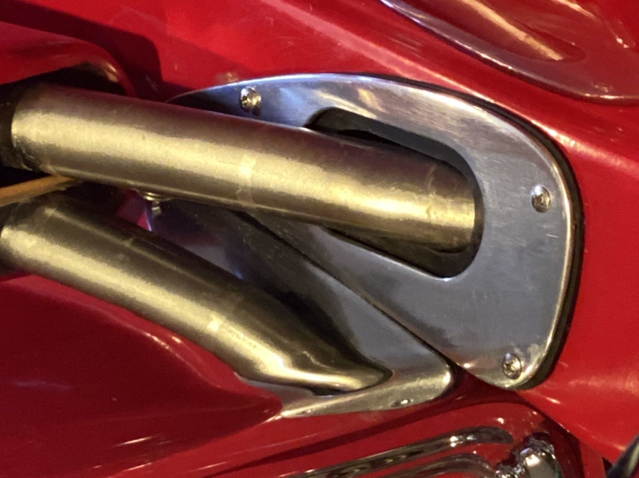

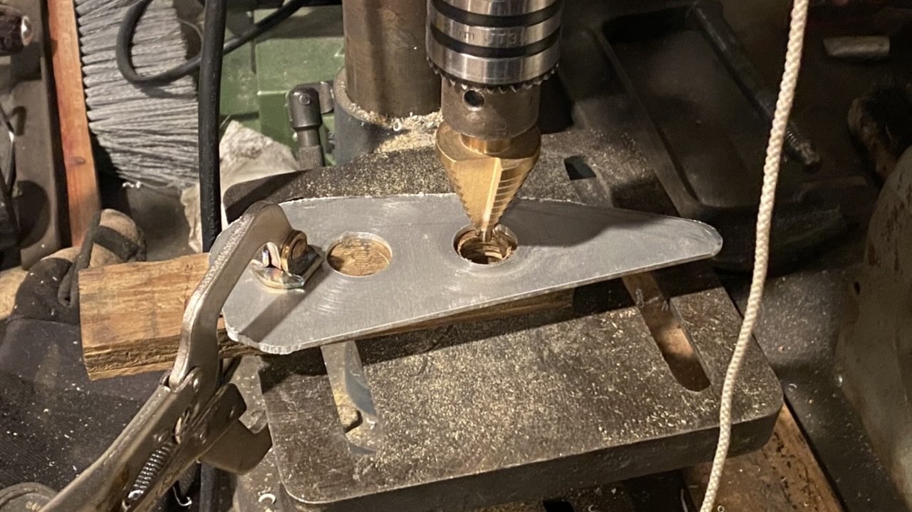

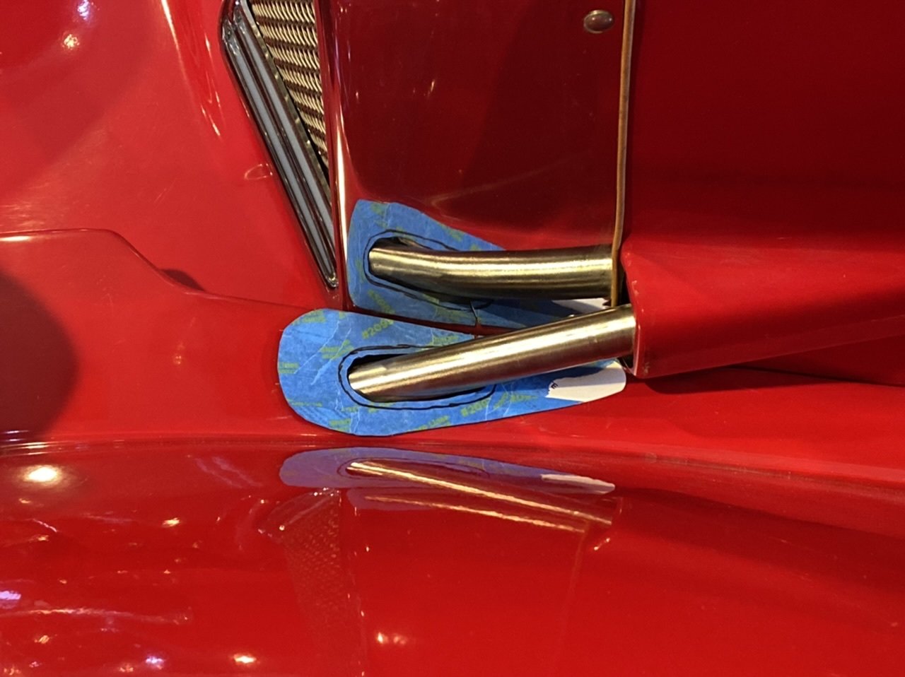

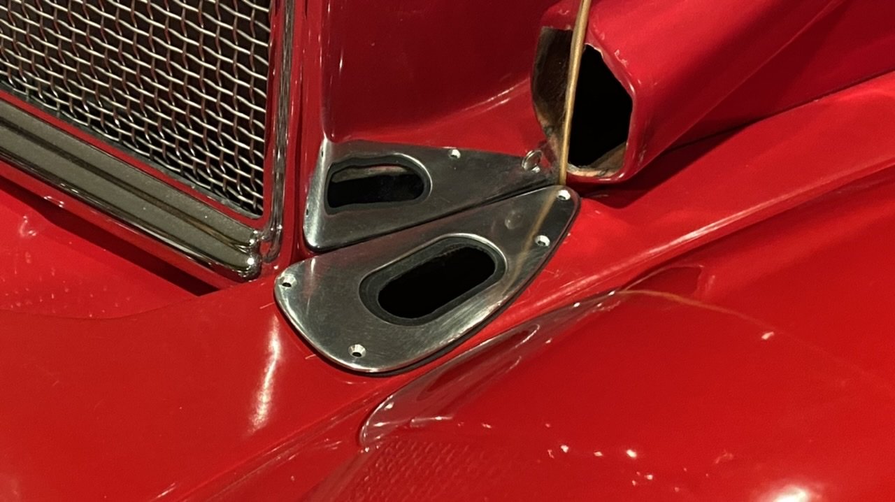

    So I still have this awful hole in the fender where the steering shaft enters.
    My first cardboard pattern for a trim plate.
    Hogging out the rough part from a bit of aluminum.
    Polished up a bit, with hand-cut rubber gasket, I’m showing the first trial fitting on the fender. I had to pull the steering column apart for the installation.
    FishnTx, 32vsnake and Toyko Joe like this.

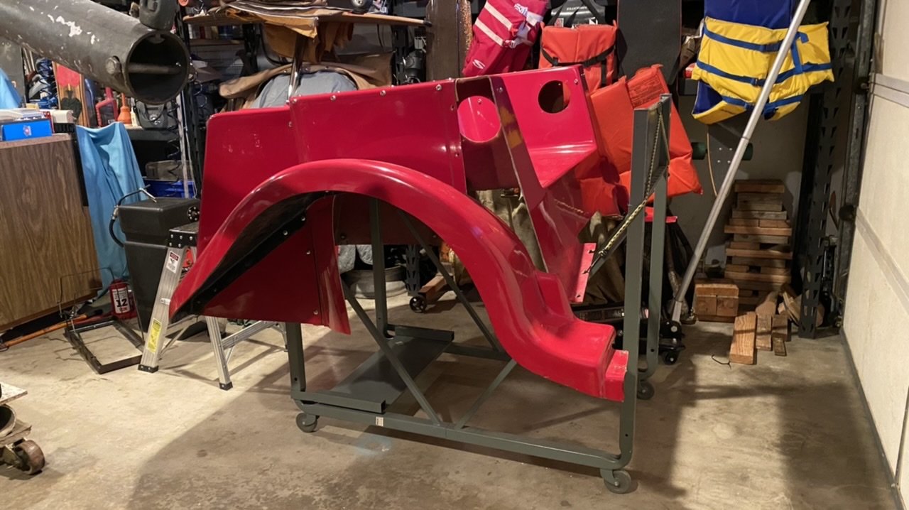

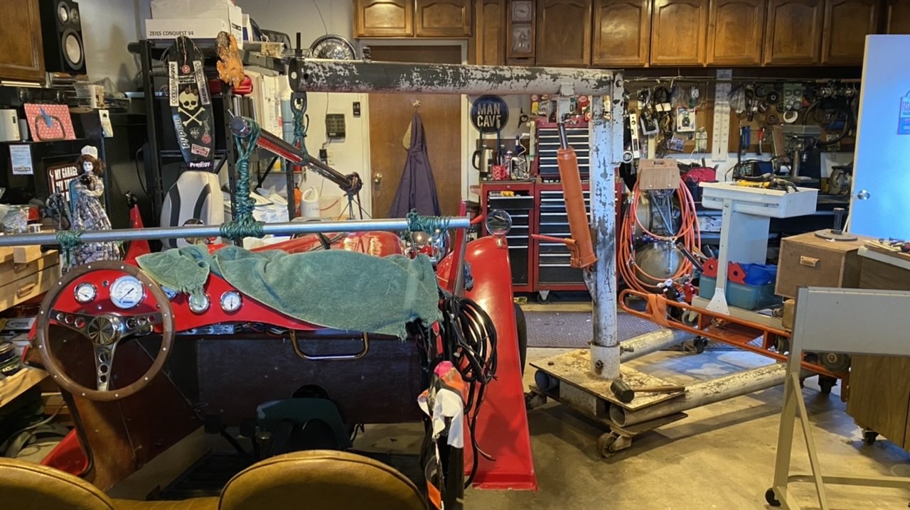

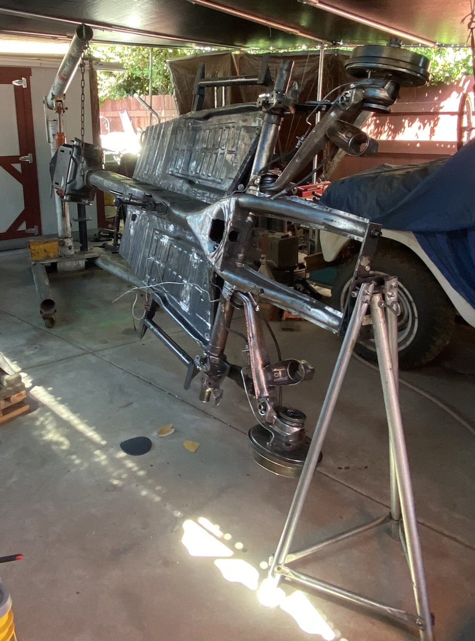

    I have the rear body apart and on a cart.
    I built the reversible hoist in 1973. I built the cart yesterday out of a couple of old plan carts from our engineering office.
    Our old office finally went paperless and I recycled all of the carts.

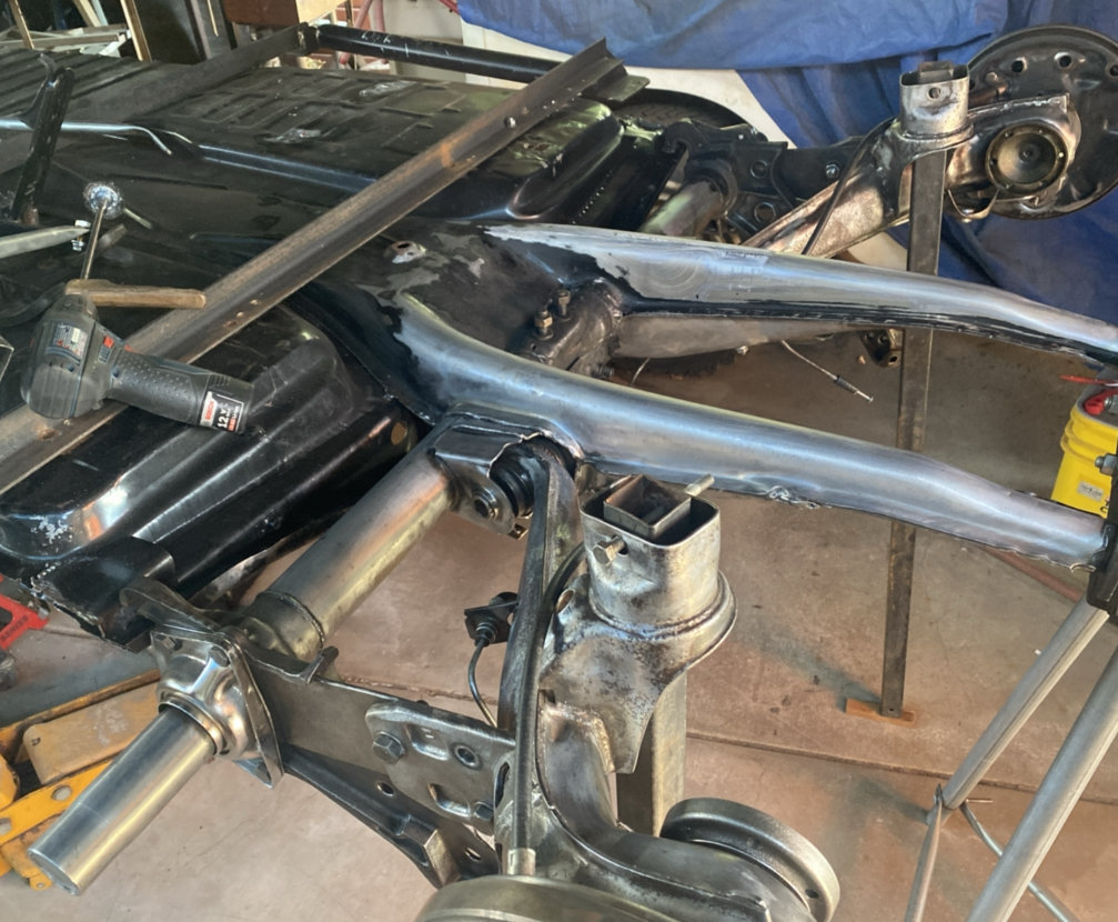

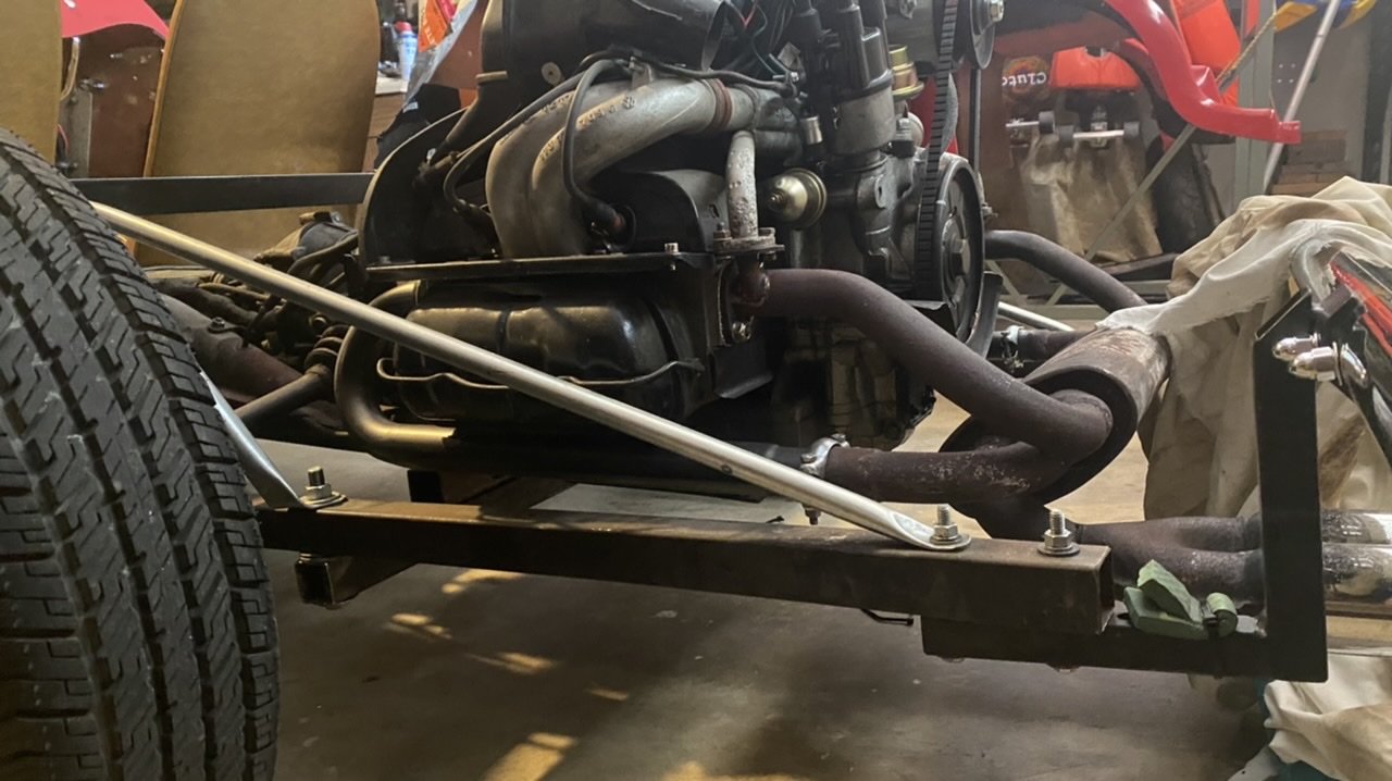

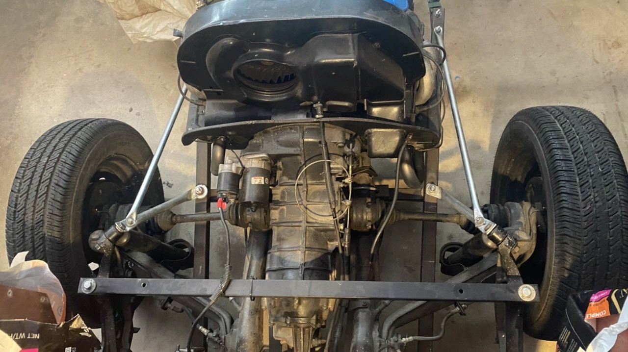

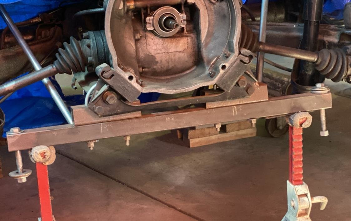

    Here you can see my initial frame mods. I had to do this to stiffen the rear frame and get the body off the muffler.
    First I added the square tube between the shock towers. This bears the rubber body mounts (not shown) below the body.
    Two pieces of galvanized tubing brace the shock towers down to the square tube crossmember under the frame fork. Two more pick up the frame at the bumper brackets.
    None of those tube steel to tube steel bolted connections had sleeves in the tube, but they all do now. I sleeved each connection, plus some that haven’t been made yet, in preparation.

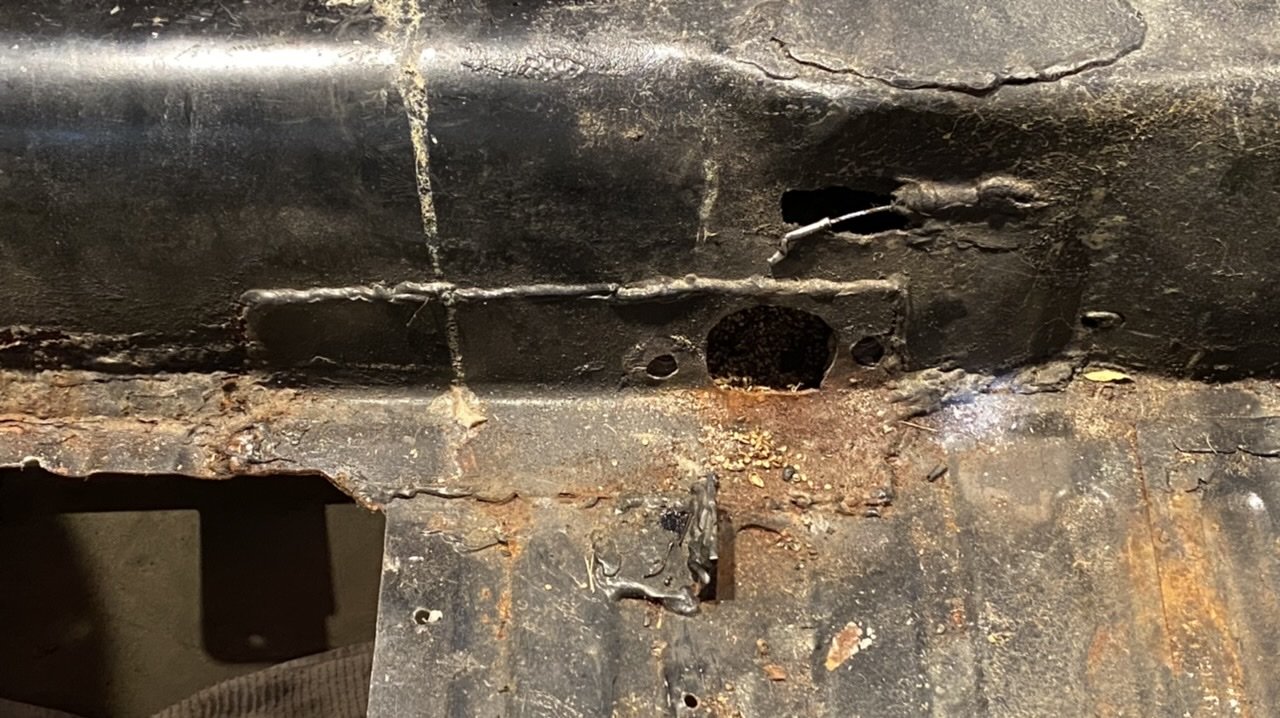

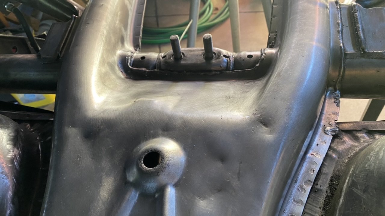

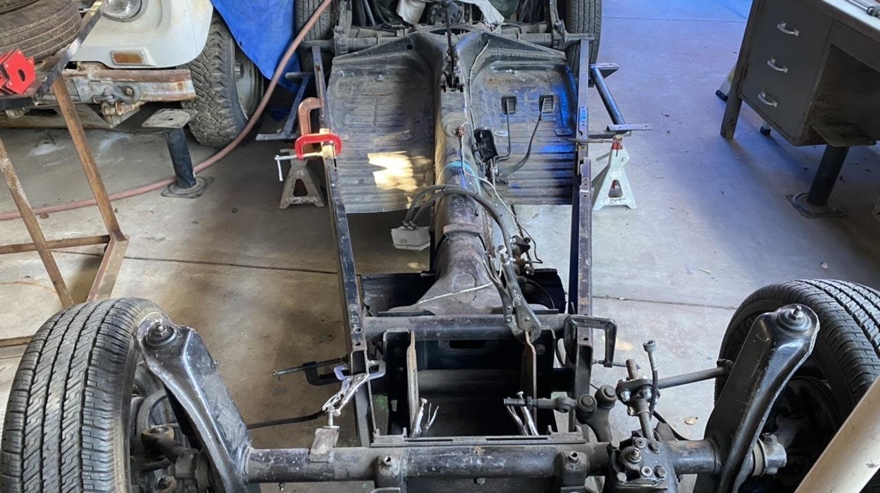

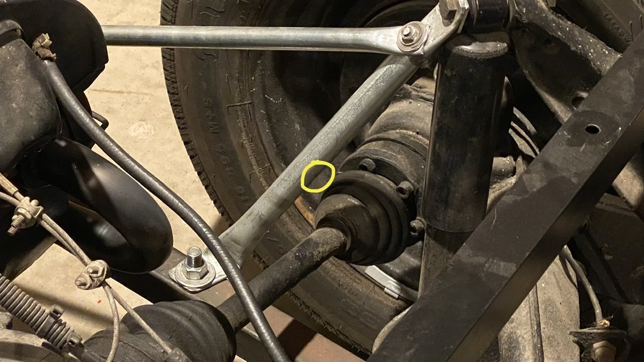

    I spent some time examining the car tonight. Right there is where the axle smacked the frame doing violent burnouts.
    Did it even worse on the passenger side.

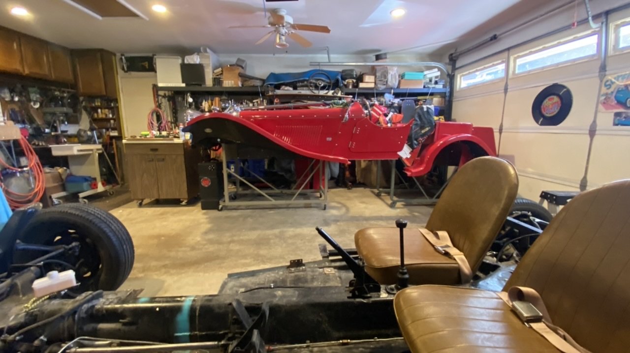

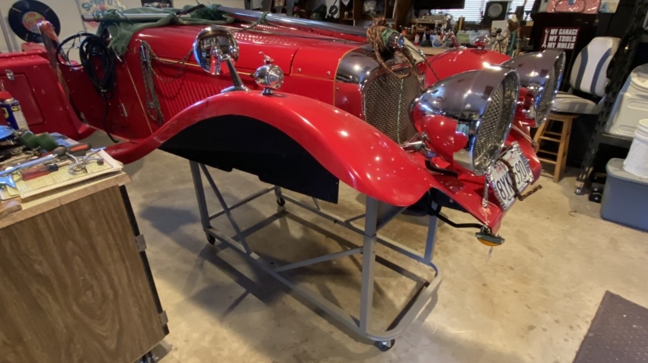

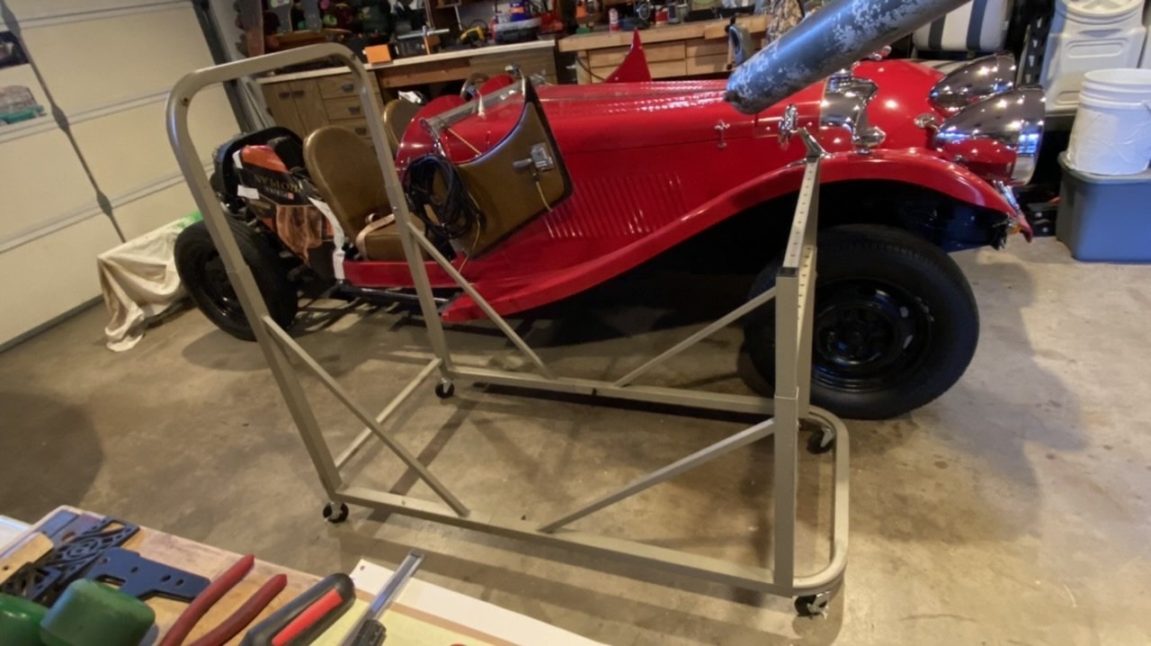

    I put together this cart to rest the front part of the body on while I work on the frame.

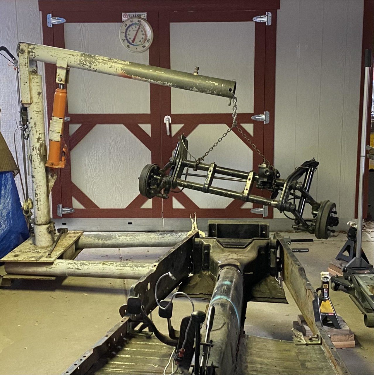

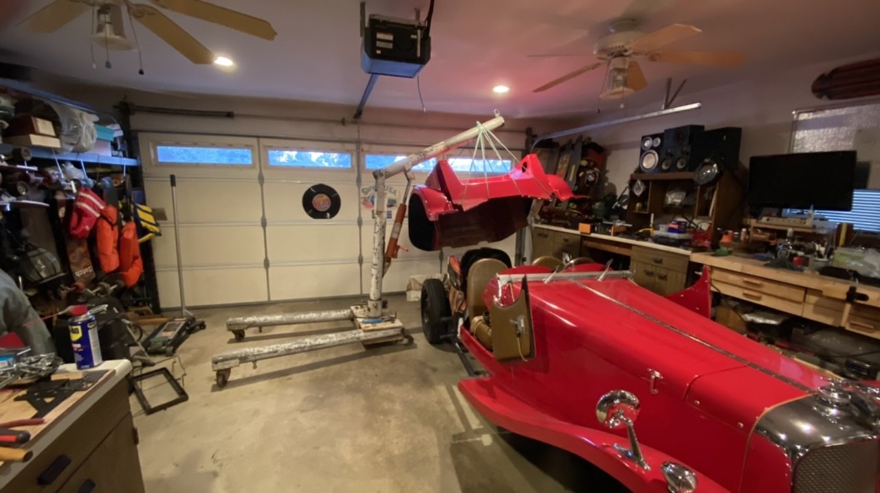

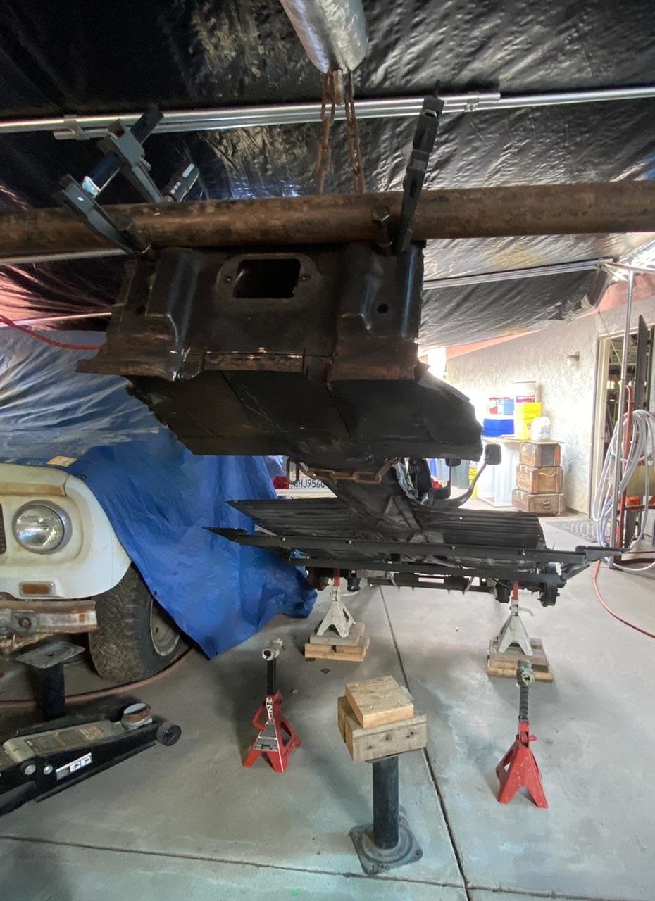

    The weighting is the hardest part.
    I had to counterweight the reversed hoist quite a bit. I used a piece of conduit as a cross bar and I used the front bumper as the spreader bar.
    Here she is off on the cart.

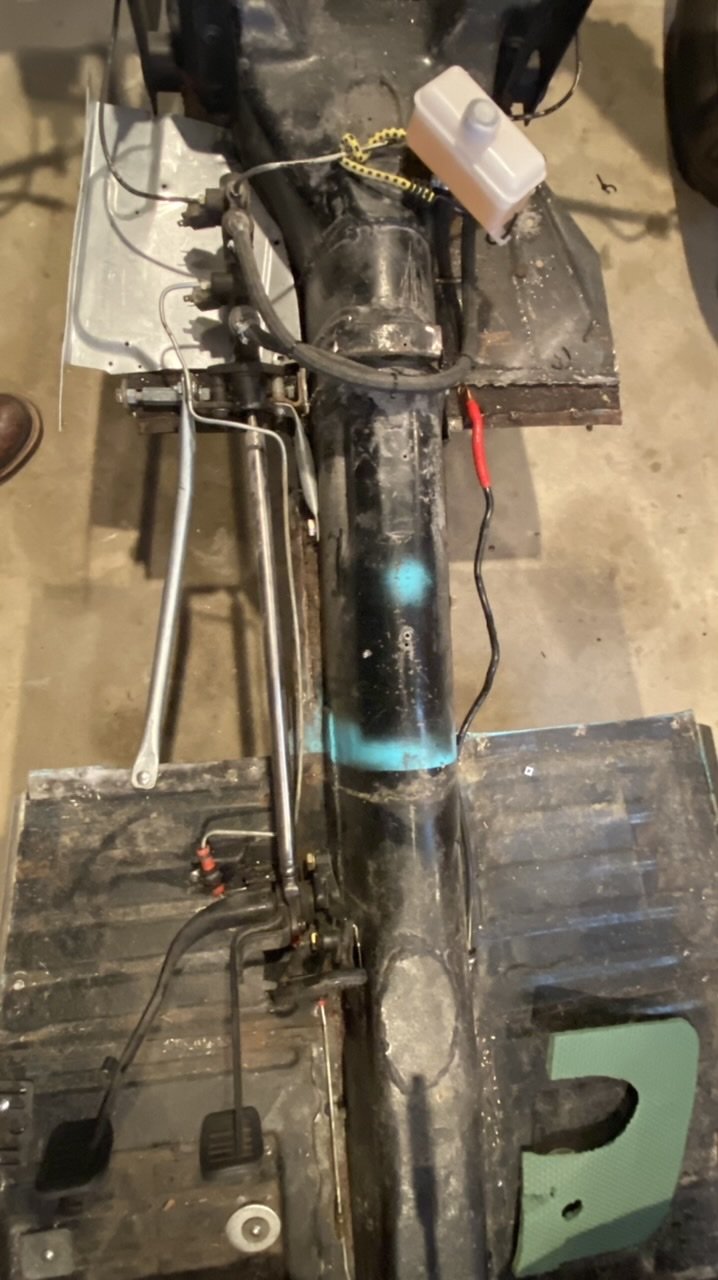

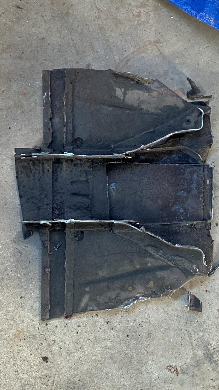

    I got the garage organized some more and I took my funky master cylinder arrangement apart so I can begin rearranging the brakes.
    Before I can do any other work to the frame I need to figure out how and where I will mount the master cylinder and establish the brake line routing so I can make allowances in the frame.
    The sheet metal that attached the master cylinder to the frame was badly rusted. I chiseled it all away and reattached the master cylinder with this series of bolts, spacers, nuts, clips, and struts. There’s a half inch all-thread that goes clear through the frame tunnel to the other side. There were already holes rusted through the frame so I didn’t actually have to drill them. LoL
    This was a super hokey arrangement, but I didn’t have to spend any money to put it together, and it actually worked ok.
    As the master cylinder stayed in its original position and the pedals were moved rearward 15 inches, the brake pushrod was extended with a piece of water pipe and some basic barnyard welding.
    I burnished off the old rust, paint and dirt, to make sure it was sound, before I actually used the old rod.
    Not so much the master cylinder itself, which started to leak a little bit after driving the car four or five times.
    Anyway, I went to the Volkswagen Shop, and now I have a new master cylinder, and a new steel brake line kit, and all of that old stuff has been removed from the car.
    it’s difficult to tell in my photos but this car also had the rag joint from a Ford on it and I bought a genuine Volkswagen rag joint to put on the car. The Ford part worked but it didn’t fit quite perfect, and looked like shit.
    Soon I will be cutting and rebuilding the frame and in the process I will be able to get rid of this ugliness.

    Here you can see I am test fitting some frame rails.
    I strip off the wheels and the front axle assembly and brake master cylinder.
    I take the engine off and roll it into the garage on a little cart for safekeeping.
    The rusty tubing all came off and got cleaned and repainted.
    The whole forward frame is going to change, and I had to start chopping it away so I can do various things to the chassis.
    This is all 1980s repair work, done over the rusty chassis, the cancer of which is revealed when I split the tunnel open.
    Not only was there lots of old oil and brake fluid inside the tunnel, there was quite a bit of debris from mice nesting in the tunnel. I set the stuff on fire with my grinder, and went through several rounds of decontamination to get all the burnt crap out.

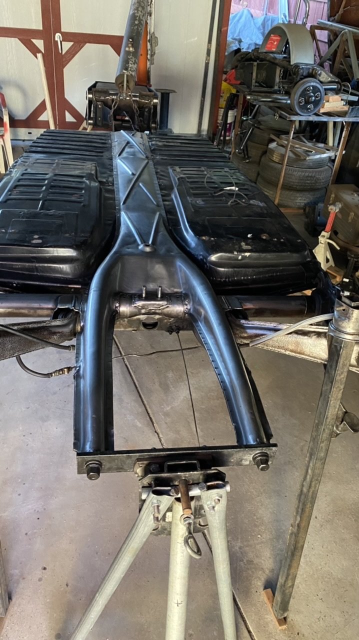

    You can see here I have stripped a lot of it down to bare metal and just shot it with some rust-converting oil.
    I built a primitive trunnion from random junk, so I could flip the chassis over.
    I propped it up with a steel saw horse and steel tubing, and went to work on the bottom.
    I pinned some steel tubing through each shock absorber perch, for legs to steady the chassis.
    I burnish everything down to bare metal with wire brushes. There was a lot of very light rust, and it all came off quite easily, as well as the layers of black paint, grease, and dirt, which this car had acquired in various places over the past 50 years.
    I would have disassembled the rear suspension as well but the main pivot bolts are rusted in place after 50 years and it seems impossible to get up the backside of the threads. Fortunately, although Rusty, this was a low mileage chassis and the rubber suspension bushings are still fine. If it had sat out in the desert 50 years, they would be crumbling; but this car was stored indoors its whole life after kitting.
    Cleaning up the chassis…
    The transaxle is all cleaned up and ready to repaint.

    There was a lot of random casting flash on the transmission case, and I knocked a lot of it off with the grinder, which make it looks a lot nicer.
    I burnished the entire transmission case with wire brushes down to the bare aluminum, and washed it with acetone. Here it’s getting a paint job on the hoist with self etching fusion paint.78588DBF-0D0B-40F6-9D6A-0EB7716525D1.jpg
    This is a preliminary mock up of the new front framing arrangement.
