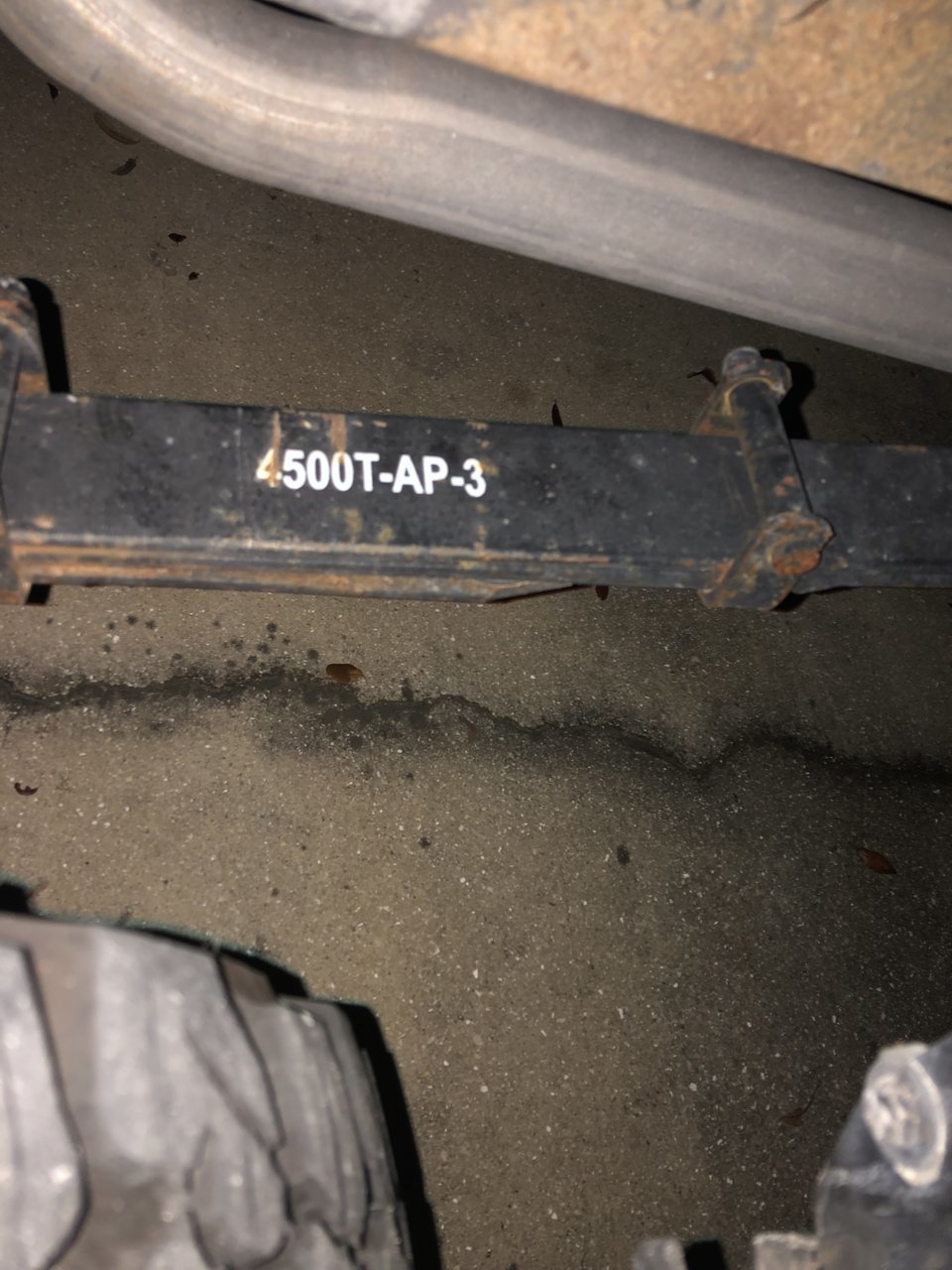

  3. Feb 28, 2019 at 5:59 PM
    Willstutz7
    Willstutz7 [OP] Self-proclaimed, unjustified expert
    Apr 19, 2016
    #184760
    34
    Will
    2003 TRD Off-road Extra cab V6 Prerunner
    3” allpro leaf springs; Bilstein 5100 shocks all around; thrush welded muffler back system; deck plate mod; 1.5” wheel spacers; rear led bumper light pods
    I thought you might’ve been right so I went out and checked just now and there’s no EX on the numbers painted on them. I’ll probably be flexin em out a little more and running around with sand bags in the backs little while longer before tackling removing leaves from it. It sure would be nice to have my bed space back lol
