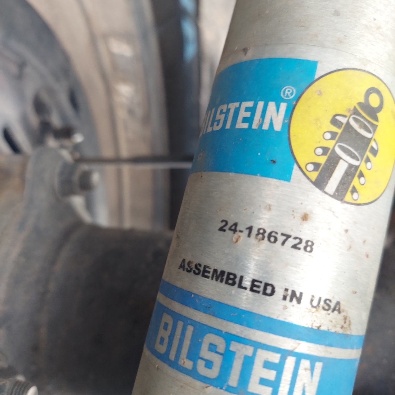

    This is what I got

    This is what the part number brought up.
    you should be fine, unless you are using your suspension to the full. Like crazy off camber rocks and ditches.

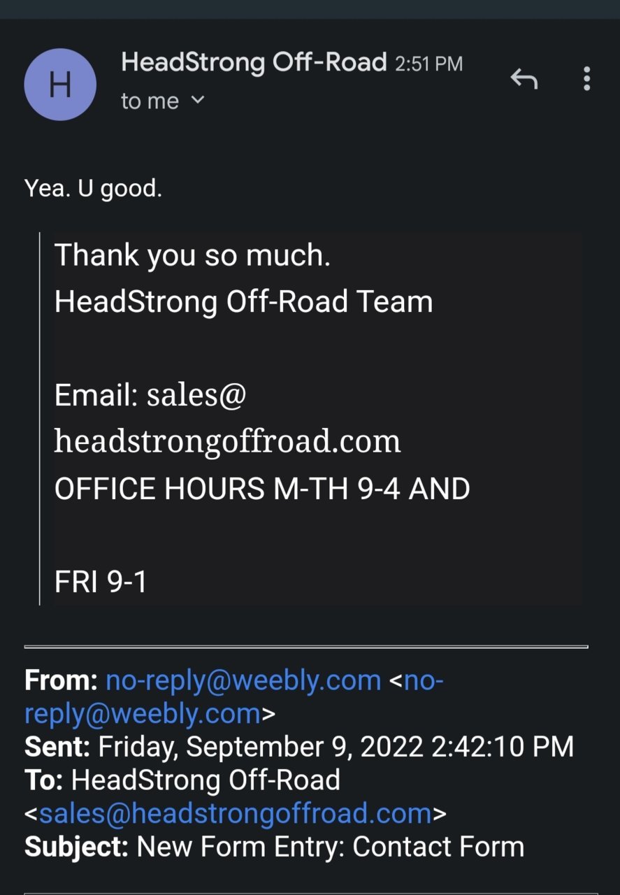

    Headstrong says I'm good. So I'm guessing I'm good? Lol
