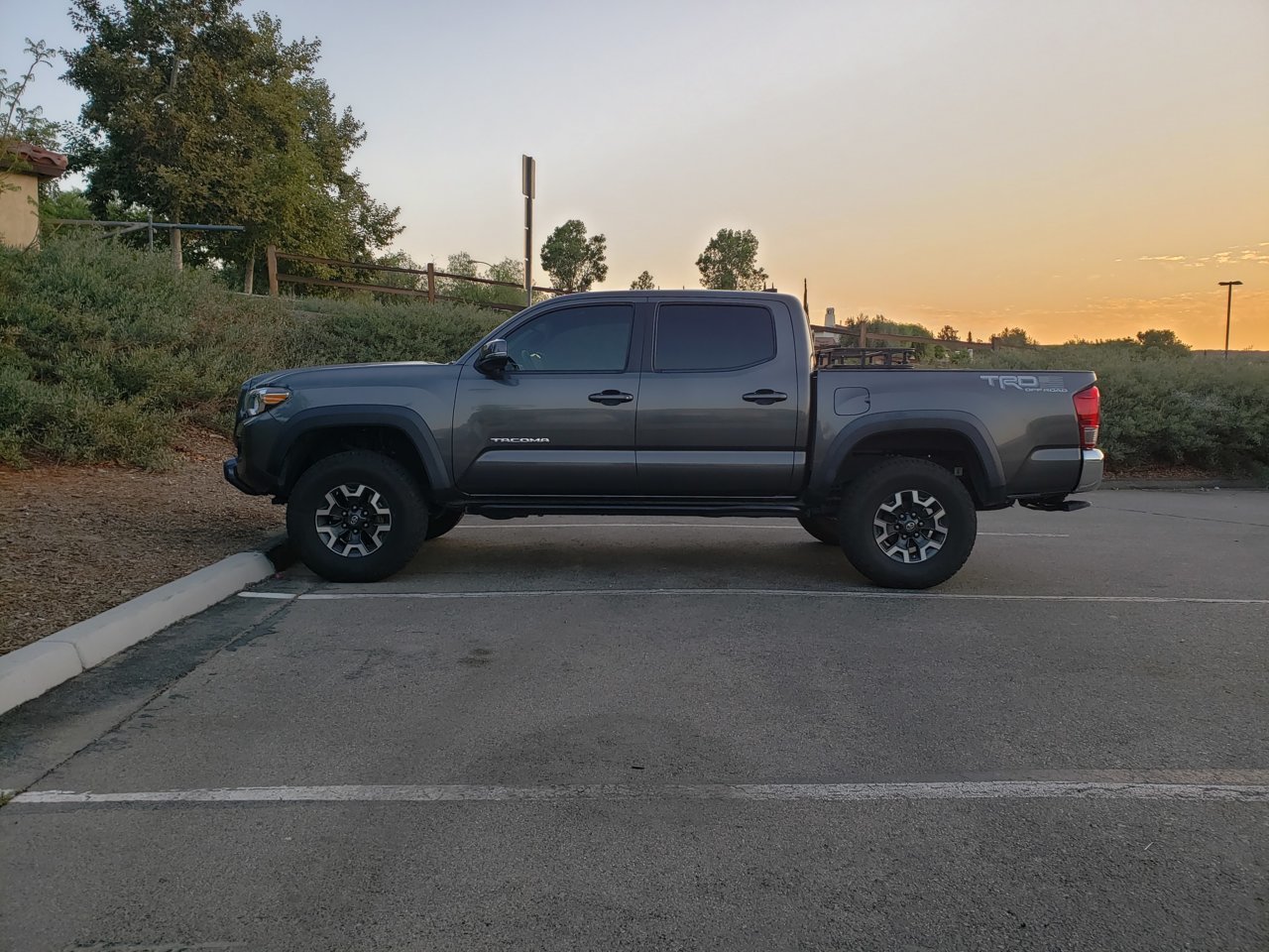

    Is anyone running Bilstein 5100's in the rear with aal or replacement leafs? My leaf springs have worn out (2016 w/95,000 miles) and my truck has lost its rake and sags when loaded with camping gear.
    I have 5100's all around set at 1.1" up front and a 1" block in the rear which maintained about 3/4" rake. From what I understand the 5100's are good for 1" lift from stock, but nearly all the replacement leaf/aal choices seem to give you 1.5" to 2" of lift? Will I be OK with the 1.5" lift in the rear?
    Pic as it sits today:

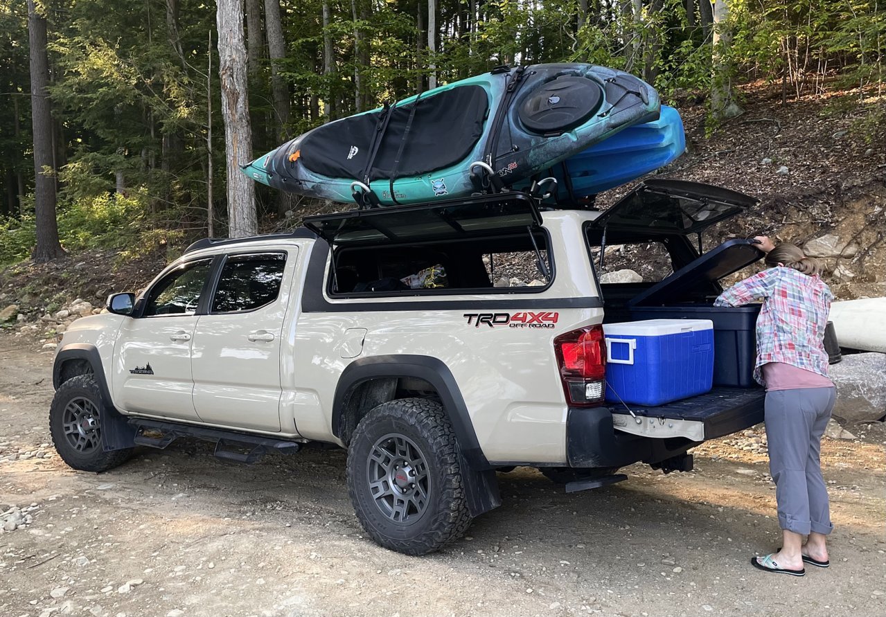

    5100s with the icon 1.5” aal in the rear. No issues.

    I see you have a topper...did it give you a full 1.5" lift?

    Pretty close. Just a tad shy according to my measurements. I should add that my overload leafs came out. If you leave those in you’ll gain an additional 1/2”.
