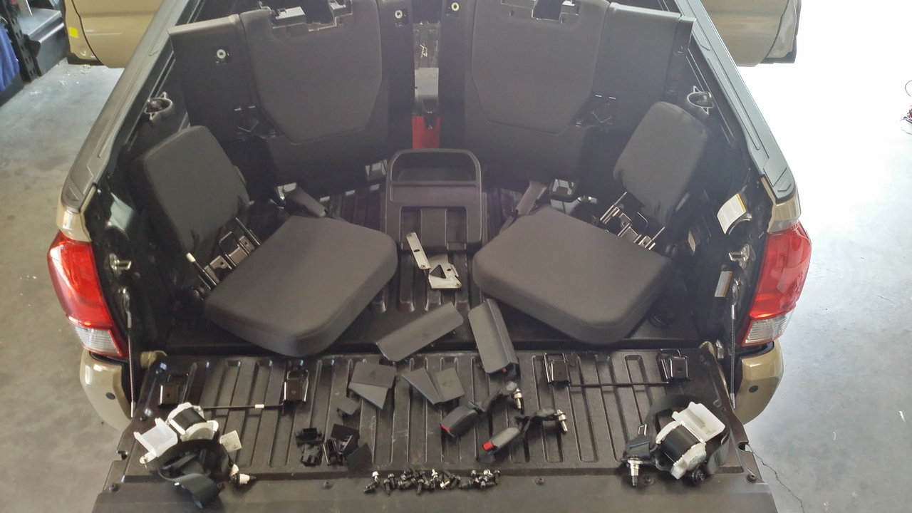

    I am trying to recall the sequence... I removed mine the first week I owned the truck. I think you remove the lower seat, then the seat back panel, and that allows access to the headrest fasteners. Your mileage may vary...
