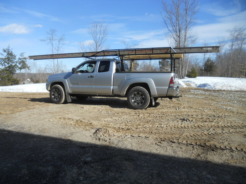

    I'd like to add a little bit of extra spring to the rear. I know it's just for looks and won't increase actual capacity, but I hate a sagging truck and have 350 & 450 "F" series trucks for heavier work.
    I built a set of pipe racks and it doesn't take much to make my little friend squat. I was thinking air bags vs. a cheesy bolt on helper. I like the factory ride & would rather not change that with an added leaf(s), my usual cure on my other trucks.DSCN8604.jpg
    The racks slide in & sit on the bed floor directly above the frame and only take a few minutes to remove or install. They are usually NOT on the truck.
    Any experience or suggestions?

    I had Firestone Ride Rites on my '06 after the TSB replacement springs started to sag. That's a great product, I really liked them. There are a few things that you need to know about them.
    1. You have to keep a minimum of 5psi in them so you don't pinch them.
    2. You have to saw off your rubber snubbers when installing, so no going back.
    3. During install you'll swear that the top bracket installs wrong, read the directions.
    4. You will lose a little bit of articulation after install, no big deal unless you wheel the truck. Don't be surprised if you go over a big curb and you lift a back wheel off of the ground.
    5. Speed bumps will be noticibly rough.
    6, The 5psi will give you a very slight rake, much like it was when it was new.
    7. I never found a reason to put in more than 15psi even when hauling heavy.
    8. Expect your ride to be firmer, but most people like it.
    9. Expect less body roll.
    10. There are existing holes downward facing in the bumper that make great mounting points for the valves.
    11. They say 1 hour install, maybe if you've done it before. Give yourself 2 or 2.5.

    Look at cheesy. Could be you save a lot of cheese. Without some of the issues mentioned above.
    Airbags are great, but it really depends on your application, as other suggest.
    Hellwig helper springs.
    tacojefe[OP] likes this.

    Most of the time I run around empty and I like the ride. This kit along with the other metal springs will alter the empty ride.
    The roads in FL must be like floating on air compared to our frost heaved, pothole canyon, goat paths that we call roads here in Maine.
