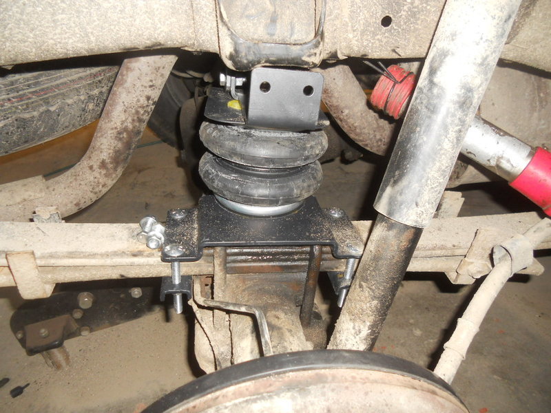

    Daystar cradles work great with the Firestone bags. Mine have been getting abused for over 4 years.

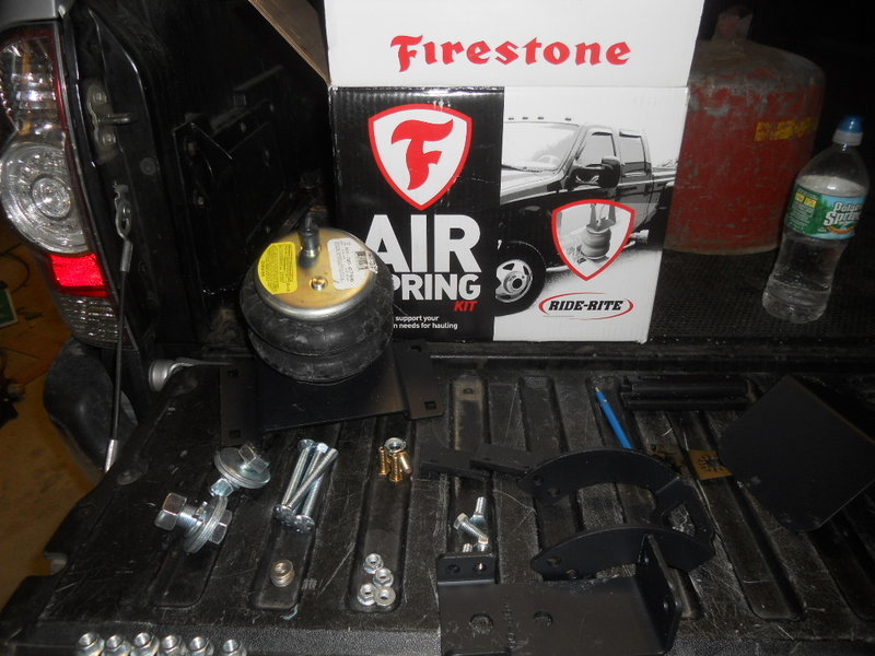

    I just bought a new/uninstalled set from another member, hoping to install them Monday. Planning on running 5-10psi everyday (topper, shelf, tools in bed)
    Edit: with Daystar cradles

    I run 5 psi in them "unloaded", just to keep from damaging them and so they act as bump stops.
    With my HD Dakars, I almost never need air in the bags. I have a heavy AF fiberglass topper with a bunch of other shit in the bed at all times - around 400 pounds or more. My main concern is bottoming out my B110s.
