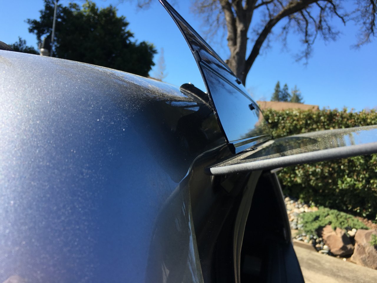

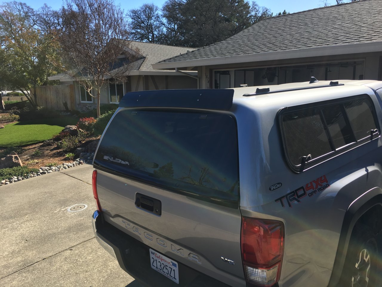

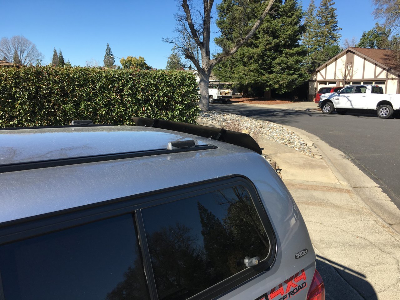

    I have a 2016 TRD ORAC w\Snugtop shell and was looking for the same thing, primarily to keep dust off the rear window and bumper. I couldn’t find one anywhere in the US, but found an excellent, universal rear deflector in Australia at Roof Rack World (
    https://roofrack.com.au/product/rear-dust-wind-deflector-1100mm-alloy-universal/)
    The price is reasonable but the shipping is steep, mostly because of the length. By ordering two or more at once, the shipping cost per unit gets tolerable.
    I ordered the 1100mm model, which matched the visual profile of the rear glass nicely. A friend put the 1200mm on a Snugtop shell on an F150.
    The curve of the bracket fit the shell closely enough and the mounting was easy and sturdy. I purchased stainless hardware locally, using fender washers on the inside and sealed the holes with silicone seal to be sure they were waterproof. It has to be located to clear the window when it’s full open.
    The results are excellent. No dust collects at the back and if you put RainX on the rear window, it keeps it clear in the rain.
