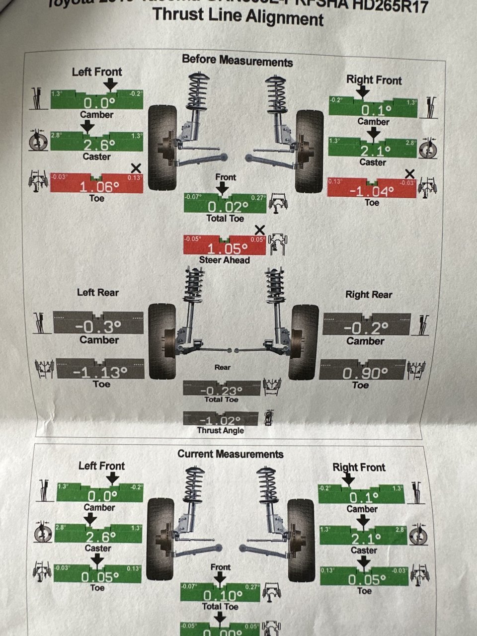

    I had someone hit my side they hit my wheel and pushed me sideways. I went to get it aligned after and this was what I got.
    What CAN I do for the rear?
    I realize it cannot be adjusted as the front can. I just need some advice.

    Loosen the U bolts on the rear leafs and retorque them .

    And have them fix the caster while they're at it. You generally want a bit less on the driver's side but this tech got it backwards.

    U bolts won't fix that. We barely get 0.05 toe with it at times. I'd still try it but you need the frame measured.
    Likely its just a rear differential housing and springs. We do it all the time on these.
    Sorry for the bad luck.
