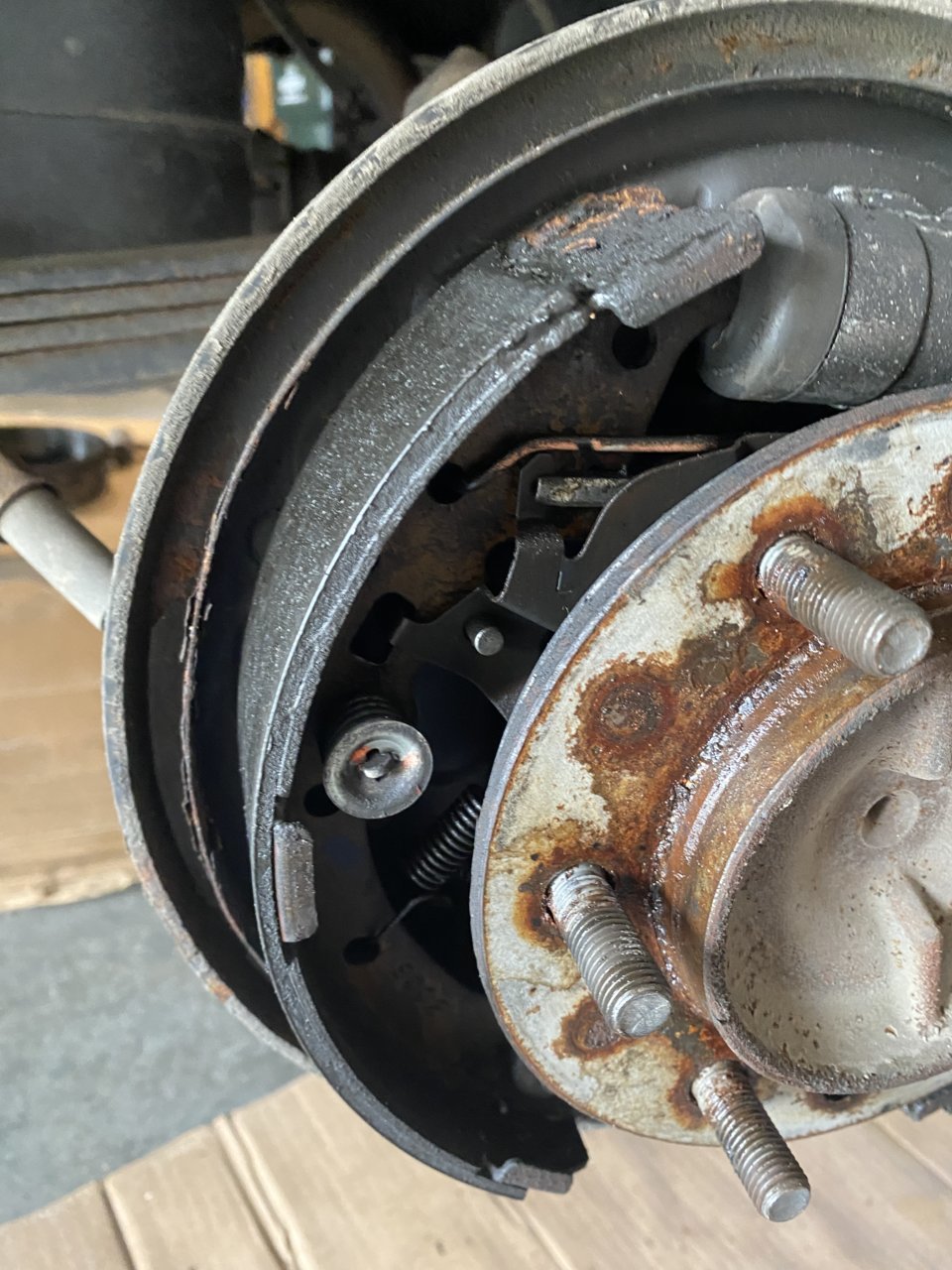

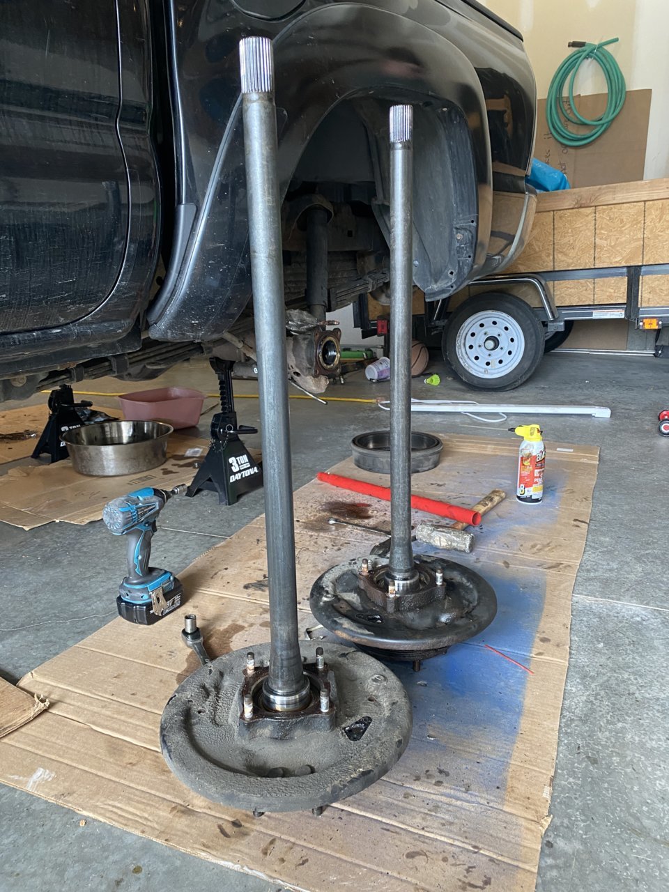

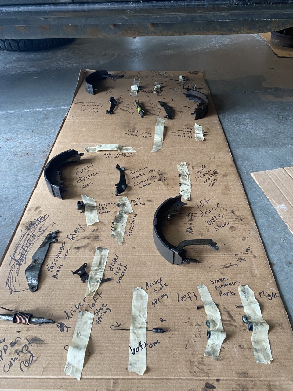

    So, kinda just coming on here to vent lol…I just “finished” replacing my rear axle seals, bearings, and brakes. The shop I had press my bearings put the left bearing onto the right axle, and the left onto right…I thought little of this when I was installing them and just put the left abs sensor on the right and right on left as that was the only difference. However I didn’t realize how the abs sensor works…now it thinks that I’m going backwards and as soon as I hit 60mph the abs, traction, chck engine, and brake lights came on on the dash. I also lost speedometer. I’m gonna contact the shop on Monday and tell them what they did. Also my parking brake cable seems loose and doesn’t engage the brake very firmly. Any tips on this? Haha kinda long sorry. Some pics for your enjoyment

    Okay, nvm I got the brakes adjusted and they work now.

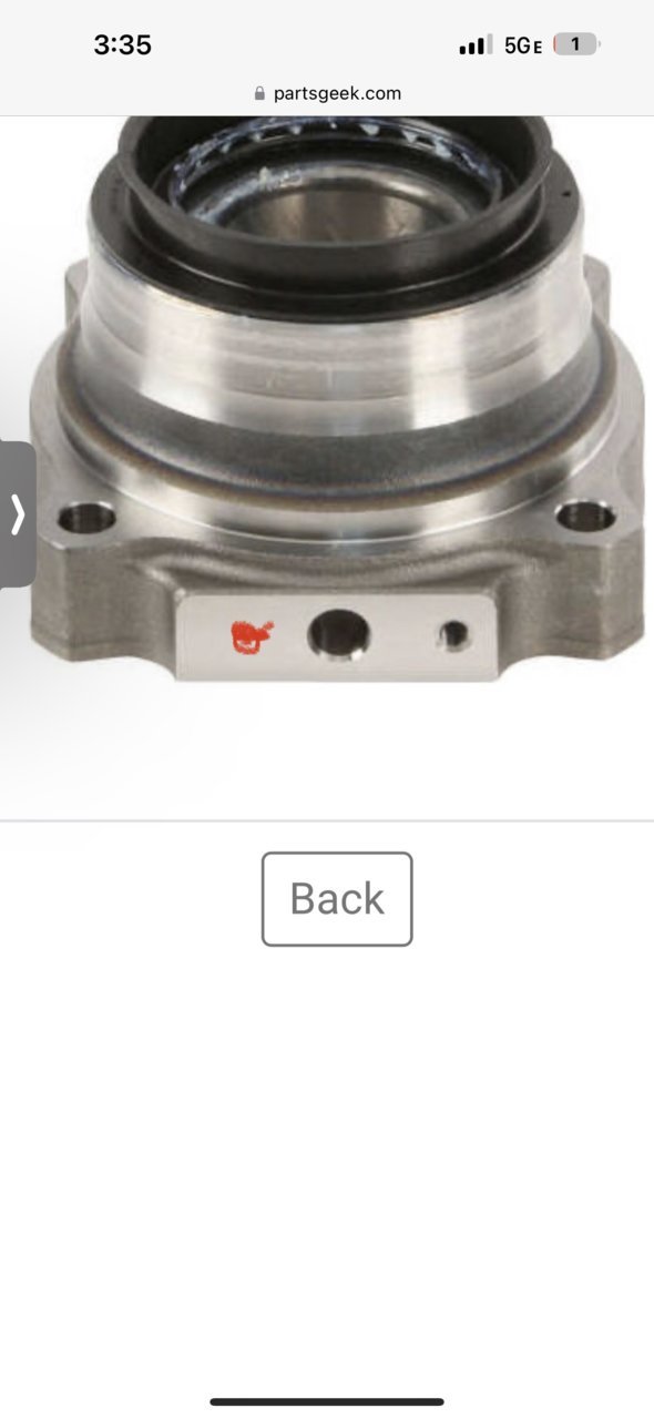

    yes the pulses backwards are different than the pulses forwards, the axle shafts aren't side specific, so you're going to have to get the shop to put new bearings on the correct sides. Hopefully they eat the cost.

    All you need to do is drill and tap a hole for the sensor alignment 10mm bolt/stud it’s the opposite side of the sensor bolt. As why to Toyota doesn’t just put 2 bolt holes for the sensors there would be no need for a right and left side bearing
