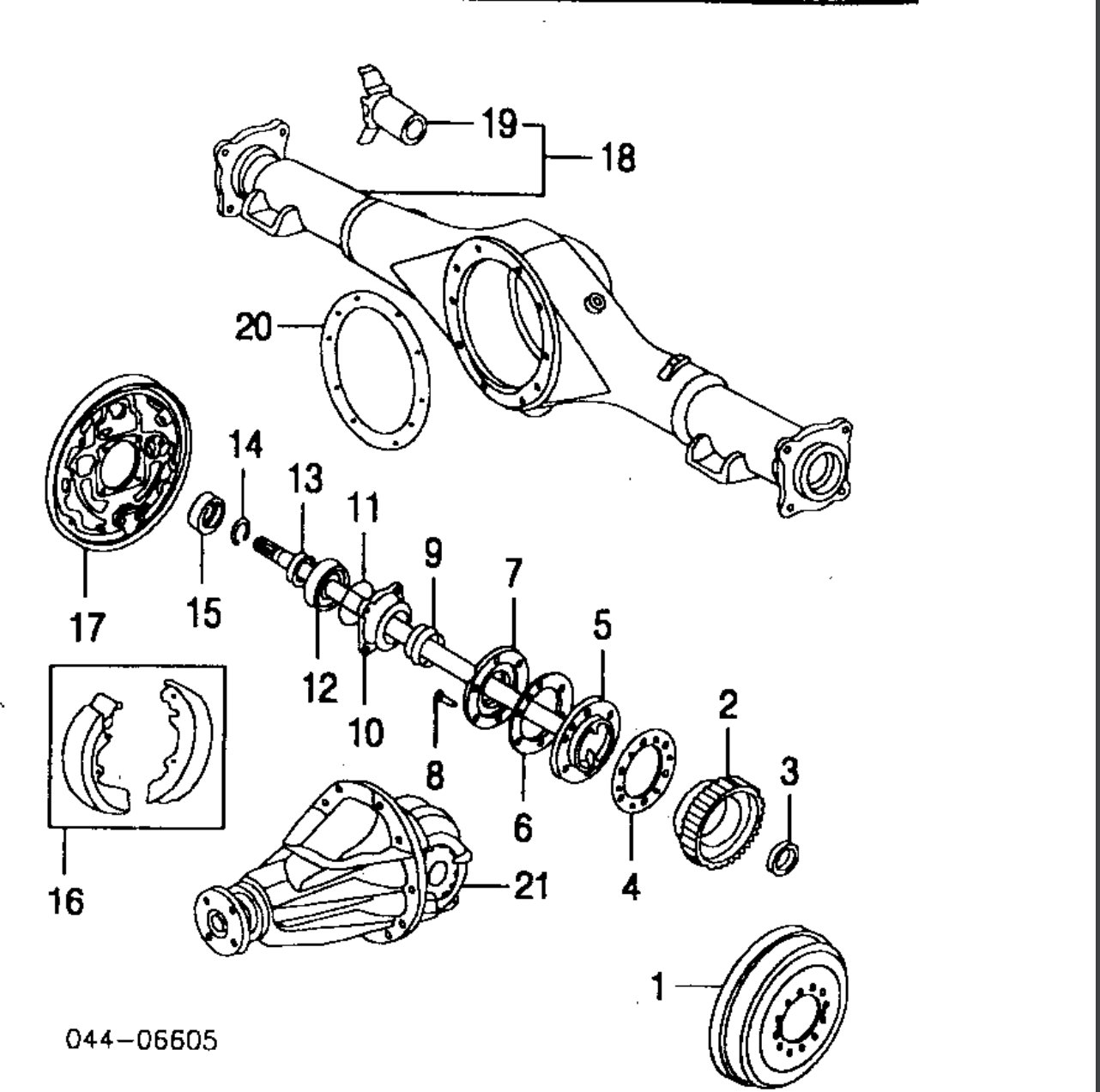

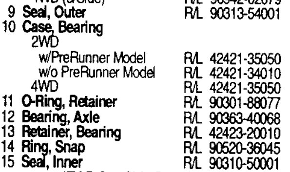

    This is from a 2001 parts diagram.
    They should be the same.
    You will need parts 9, 11, 12, 13, 14, 15
    There are also 4 studs that go through part 10.
    They are not shown in the diagram. They are studs that the 4 nuts go on.
    The same nuts you take off to remove the axle assembly.
    I don't have the part # for them. Some guess beat there's out and re use them. I would NOT myself.

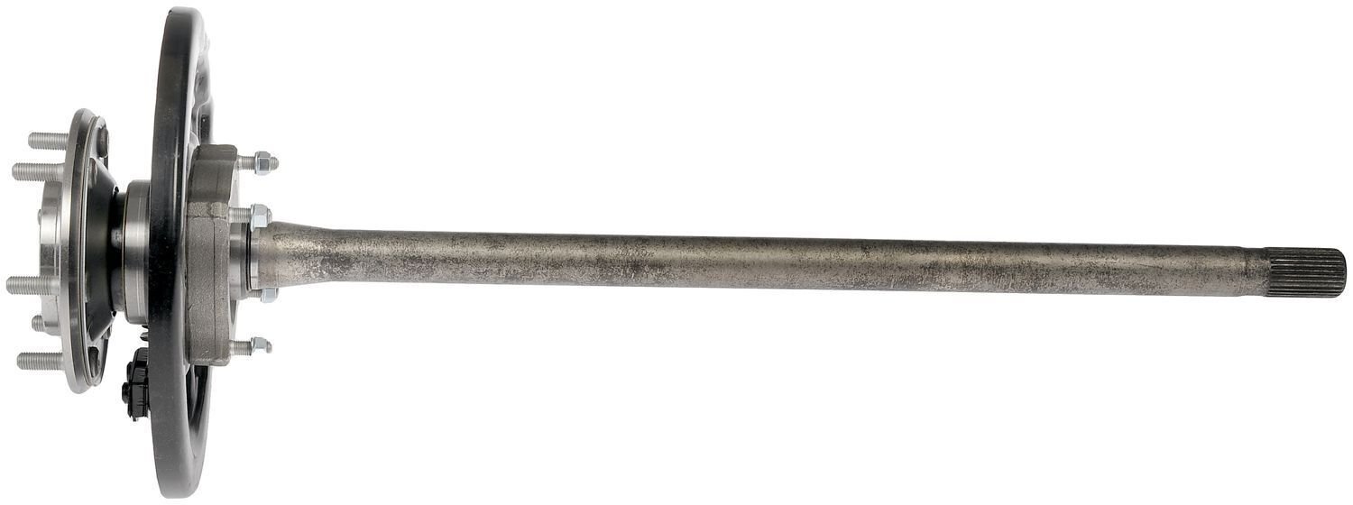

    He's confused, I've found complete assembly for 05-15
    but for gen 1's I can only find the kit....but not assembled.

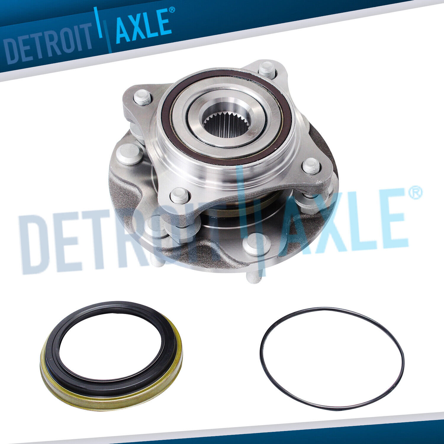

    Fronts are pretty popular to use the already pressed in bearing....

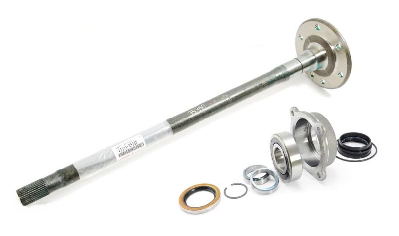

    They are all over the internet, have you looked? And you are correct, they include the brake and everything. I just cant find on for my 2000, Nonone offered assembled knuckle when I did that recently. Luckily I found Jason Sabat aka zippsub09 and he got me fixed up in no time and the knuckle he prepared and sent me made it a super a easy job. Ihighly recommend you hit him up if you're doing steering knuckles.
    I've found the same thing and I guess you've just confirmed it for me. Ugggh not a happy camper here. Where did you find the kit you have pictured?
