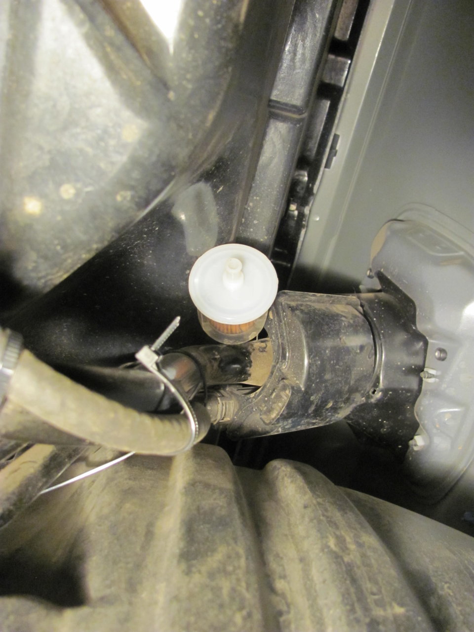

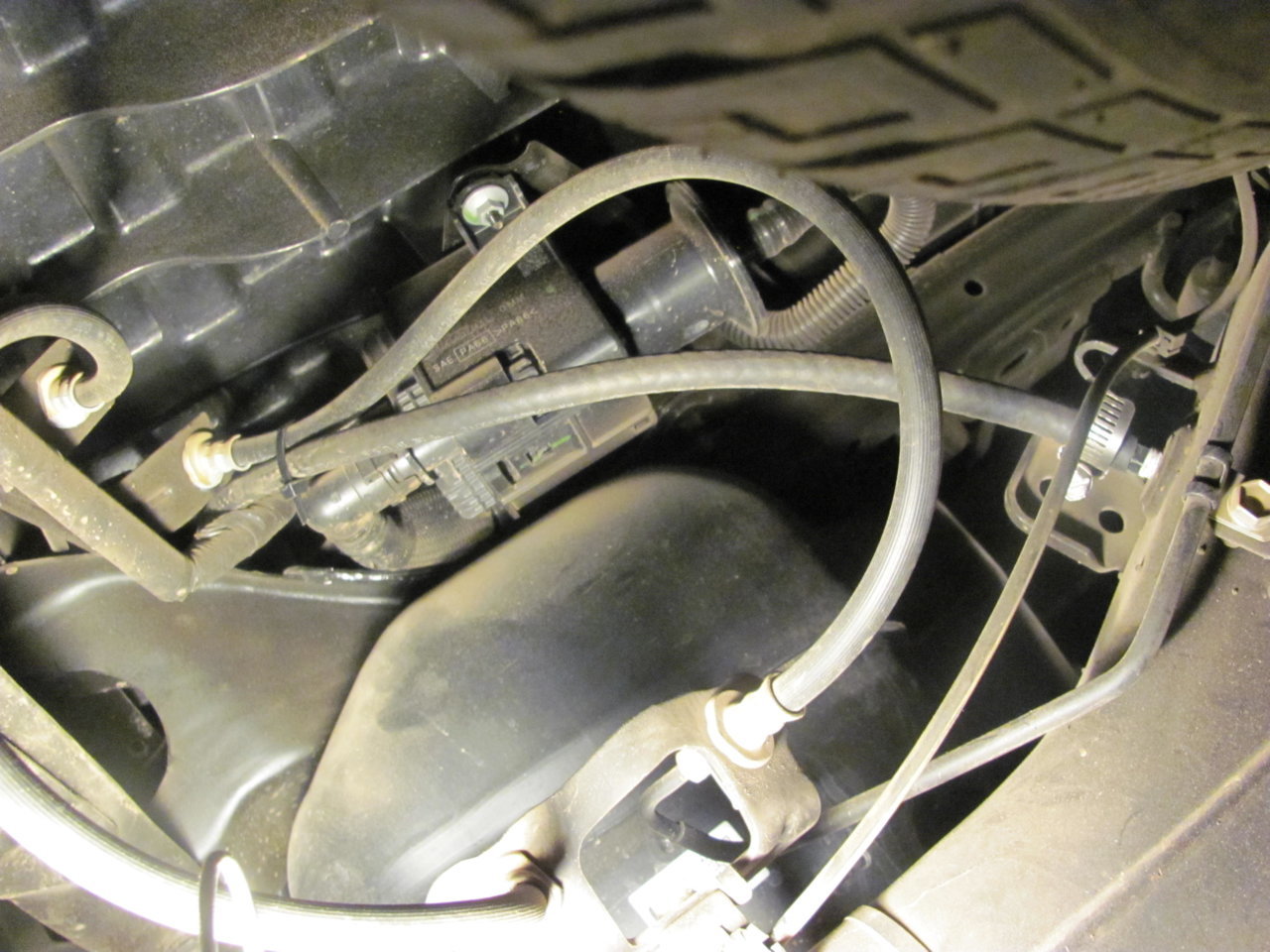

    First, Instead of the breather cap on tube I used a clear small engine in-line gas filter. I ran mine over the frame up to the gas filler tube used a few Zip ties making sure the open end of the filter faces downward to keep out water. It is high and dry there, also it gets no winter tire spray as does the back of the truck location.

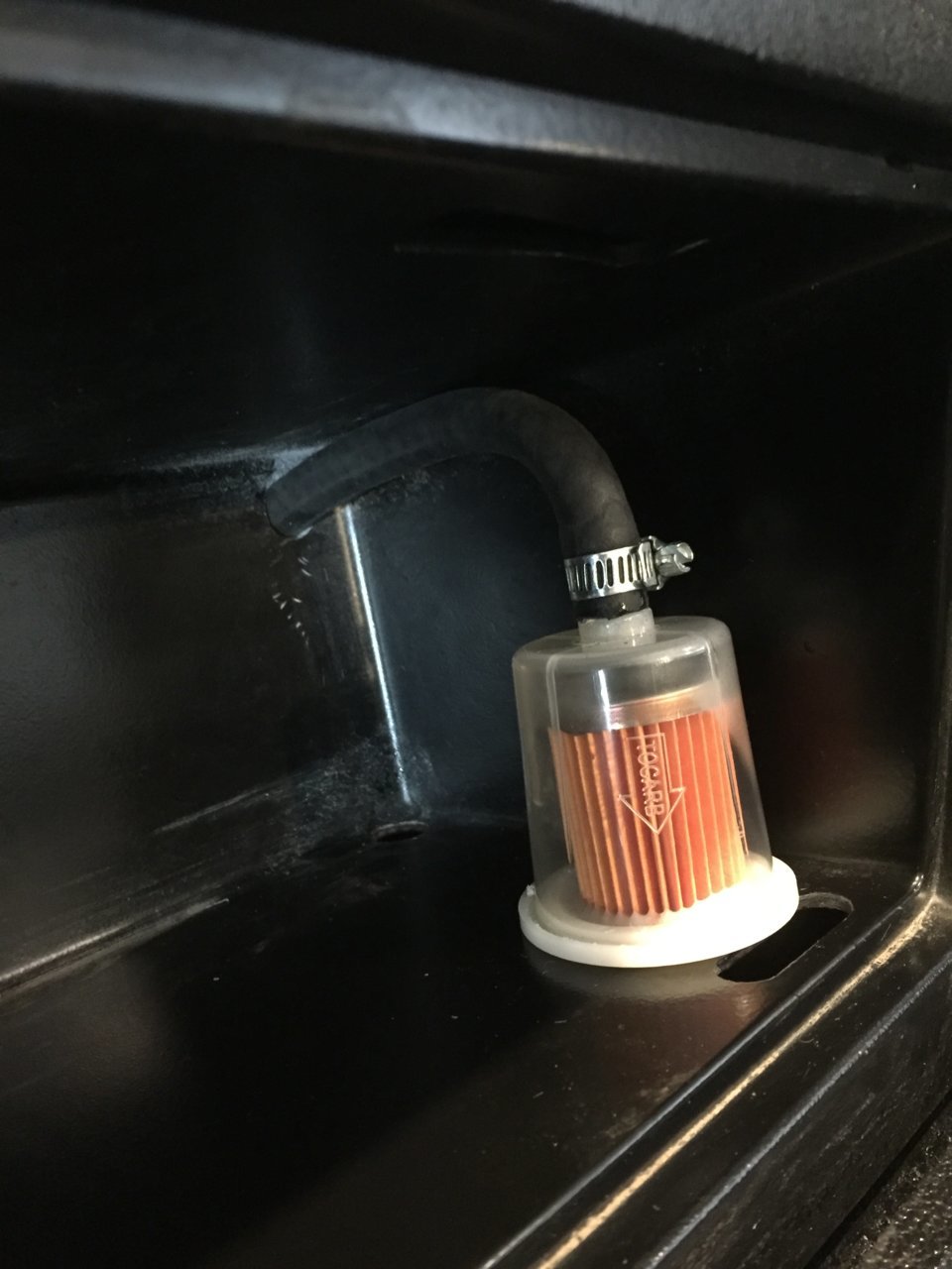

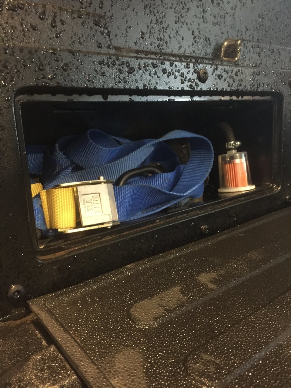

    This spot has worked well. Easy access and keeps it clean.4CF00E3C-16B0-47A8-93E7-60FF3323FF48.jpg 2583ABFC-2178-48BA-82C4-3857B2672ABB.jpg
