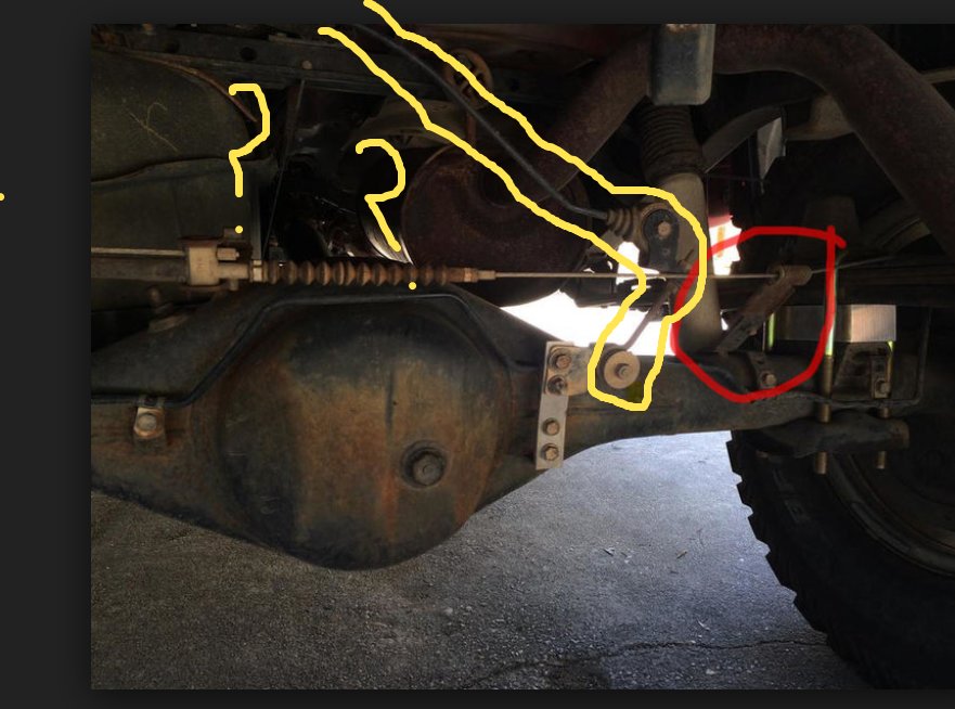

    While wrenching on a friends Taco today, I saw some kind of sensor arm attached to the rear axle (in yellow, please ignore the red):
    It goes to a hydraulic cylinder assembly (not included in this pic that I stole) that seems to then go on to drive both rear brakes.
    What is this beast?
    Near as I can figure it, it detects the vertical displacement of the rear axle, and could modulate the rear braking force by detecting a nose-down/tail-up attitude.
    UPDATE!
    Further digging makes me think that this is the rear proportioning valve, used to detect the tail-down attitude caused by load in the truck and modulate the braking pressure in response to the weight of the carried load.

    Yep, thats what it does. More weight in the rear allows more rear proportional braking to take place.

    yes, that is a Load Sensing Proportional Valve (LSPV)
    It adjusts the strenght of the rear brakes according to what you are carrying in the bed. The heavier it is, the more it pushes the piston into the valve, allowing more brake fluid to the rear

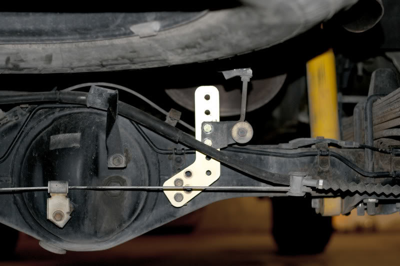

    OP, Sorry don’t mean to high jack your thread but it’s a related question. With a 3” lift how do you know how far this valve needs to be adjusted in order to work properly?
  6. Dec 14, 2017 at 10:38 PM
    Speedytech7
    Feb 20, 2014
    #123587
    57,357
    924 W Garland Ave, Spokane, WA 99205
    It's less Tacoma and more mod
    Raise it about as much as you raised the truck, also test it a couple times on dirt and pavement safely to determine that it isn't locking the brakes up too easily. That could cause tail happy handling and be dangerous in a panic stop

    @Shubin If you lifted the rear 3" then you want to put the bpv bracket at the corresponding height (3"). Then do what Speedytech said and go test it to make sure the rear brakes are acting the way you want them to.

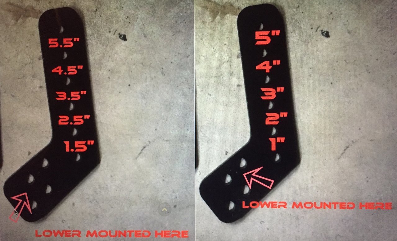

    Taken from BAMF's website:

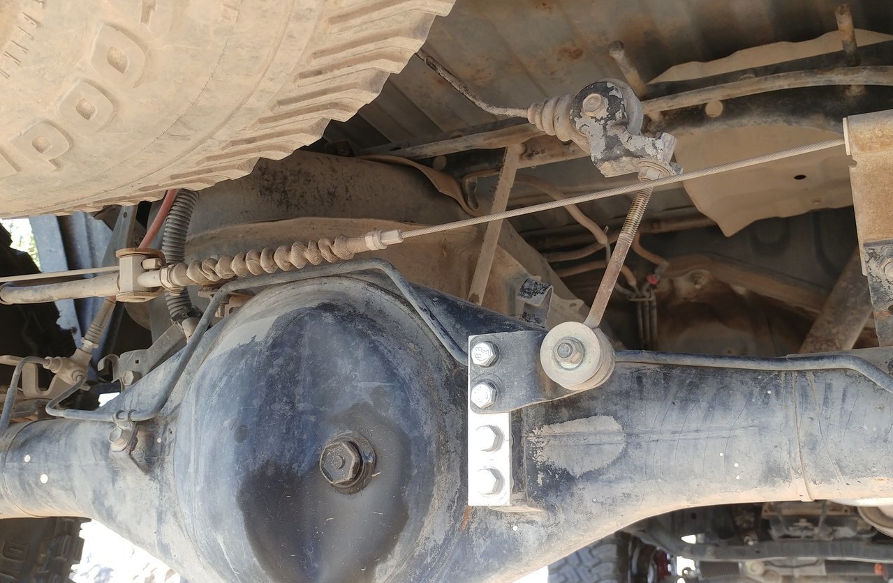

    What position is that whole assembly supposed to be at at regular ride height? When I did my relocation bracket, I noticed that whole assembly moves side to side, or up/down and "snaps" into place in either position when moving it.

    The valve above works by sensing the angle of the "arm" that comes down to the axle, you just need to elevate it equal amount as your lift to get the arm into the proper angle.
    I just cut a piece of metal and raised it 3.5", before doing this my truck felt as if all the braking was done by fronts only, now under heavy braking both front and rear would lock up about the same time.

    Isn't it easier to just make a bracket that lifts it up though? :notsure:
    I think that extending the rod would work, but it's probably more complicated than it needs to be.
