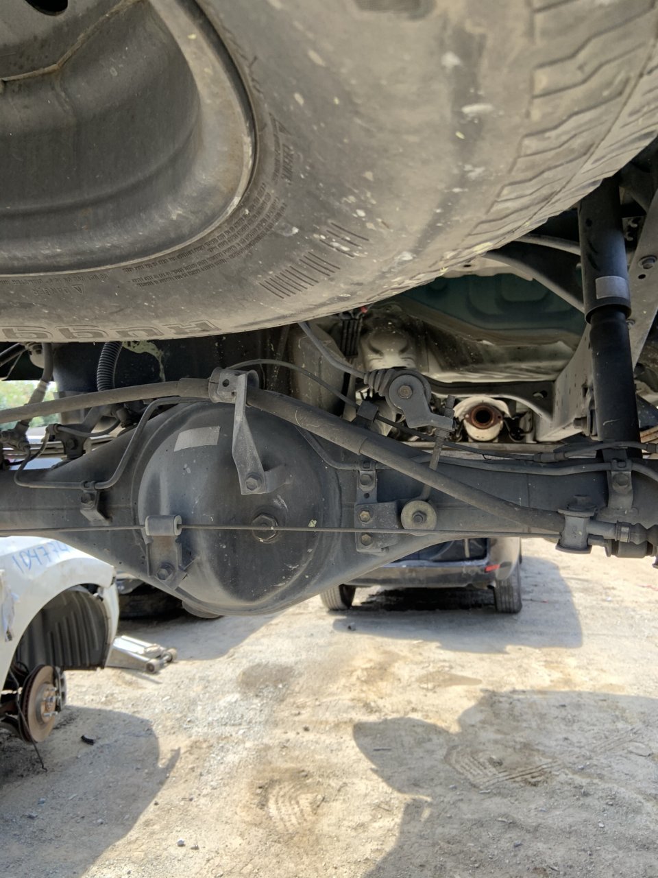

    C76149CE-C149-4F6F-97FB-8C8B7E7ABC06.jpg My Rear Axle Housing on the third member at the bottom has a small pin hole leak. I am going to attempt to JB Weld the hole to see if I can buy some time. My Elocker housing and Axles are completely fine. I have done my research and wanted to see if I am correct.
    1.) I could cut the rear cover off and weld on a new one from Barnes 4wd. Only problem is I can’t weld and the quote to get this service done has been around $800.
    2.) I could buy a Bare housing and use my existing E Locker and Axles. I can find a used Housing for $250 locally in almost pristine condition and install it myself. Only problem is that it is from a V6 2WD E Locker and my Truck is a 4WD with E Locker. Are the housings interchangeable? From visually looking at it, it seems like it should work. I’ve attached a picture above.
  2. May 12, 2020 at 7:43 AM
    02hilux
    02hilux What do you mean there’s no road, I’m here
    Sep 14, 2016
    #197244
    6,293
    Planet: EARTH
    All 8" elocker and housing are the same, even from the t4r. But on 4r, you'll have to cut the brackets and weld on the perch.
    Wyoming09 likes this.
  3. May 12, 2020 at 7:46 AM
    MoneyB86
    MoneyB86 [OP] Well-Known Member
    Mar 31, 2020
    #323490
    194
    Reagan Country, CA
    2019 MGM Tacoma Double Cab
    If I understand correctly, I can buy a 2003 4x2 Elocker housing with ABS and use it on mine which is a 4x4 Elocker with ABS.
  4. May 12, 2020 at 8:05 AM
    02hilux
    Sep 14, 2016
    #197244
    6,293
    Planet: EARTH
    Correct. 2wd and 4wd elock axle are the same. Only difference i can think of is the backing plate ebrake cable location. But since you're using everything from yours, that wouldn't matter.

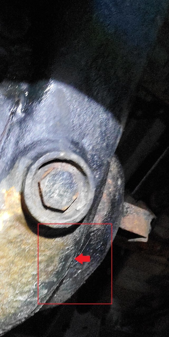

  9. May 12, 2020 at 9:09 AM
    MoneyB86
    Mar 31, 2020
    #323490
    194
    Reagan Country, CA
    Here’s an older picture ( a week ago) I’ll take a different angle when I get home today.
  10. May 12, 2020 at 9:11 AM
    MoneyB86
    Mar 31, 2020
    #323490
    194
    Reagan Country, CA
    Don’t mind the leak on the left. The Elocker actuator was cracked and I replaced it taking care of that leak along with resealing the third member.

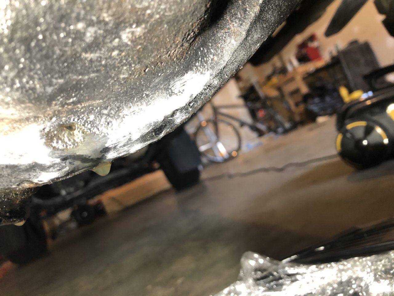

  12. May 13, 2020 at 9:07 AM
    MoneyB86
    Mar 31, 2020
    #323490
    194
    Reagan Country, CA
    Here’s the culprit hole. Got it down to bare metal and waiting for everything to drain out and then clean it with Acetone and JB Weld it.8DA357B6-6CF4-4C77-A59C-624BCC910F1B.jpg
  13. May 13, 2020 at 9:23 AM
    BT85
    BT85 Well-Known Member
    Mar 12, 2019
    #286406
    89
    Lancaster, PA
    2002 TRD OR 4x4
    5100s, AAL, Leer cap, 15x8 pro comp w/ 33x10.50 Maxxis RAZR
    i’m from southern PA, if you bring it to me i could weld it for a lot cheaper than $800. JB weld will have a hard time sealing on that even if you clean the gear oil and drain it.

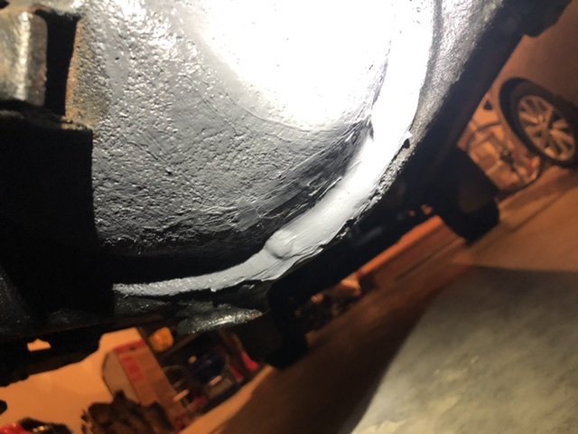

  16. May 20, 2020 at 4:54 AM
    #16
    MoneyB86
    Mar 31, 2020
    #323490
    194
    Reagan Country, CA
    ED6C6B6B-771D-427C-B603-54C1290EBDB0.jpg Just wanted to provide an update. My neighbor came over and tack welded the hole shut. There is now a nipple on the area of the original hole. I then took a syringe filled with JB Weld and filled in the outside gap of the weld to fill in any potential holes. After 24 hour setting time, I scuffed up the original application and applied a second layer of JB weld. Going on 2 days without a leak. This will buy me some time until I can find a good deal on a new housing
  17. May 20, 2020 at 4:55 AM
    #17
    MoneyB86
    Mar 31, 2020
    #323490
    194
    Reagan Country, CA
    FYI, I made sure to get the metal to bare shiny surface, scuffed it with some sand paper and then cleaned it with acetone prior to the JB Weld application.
