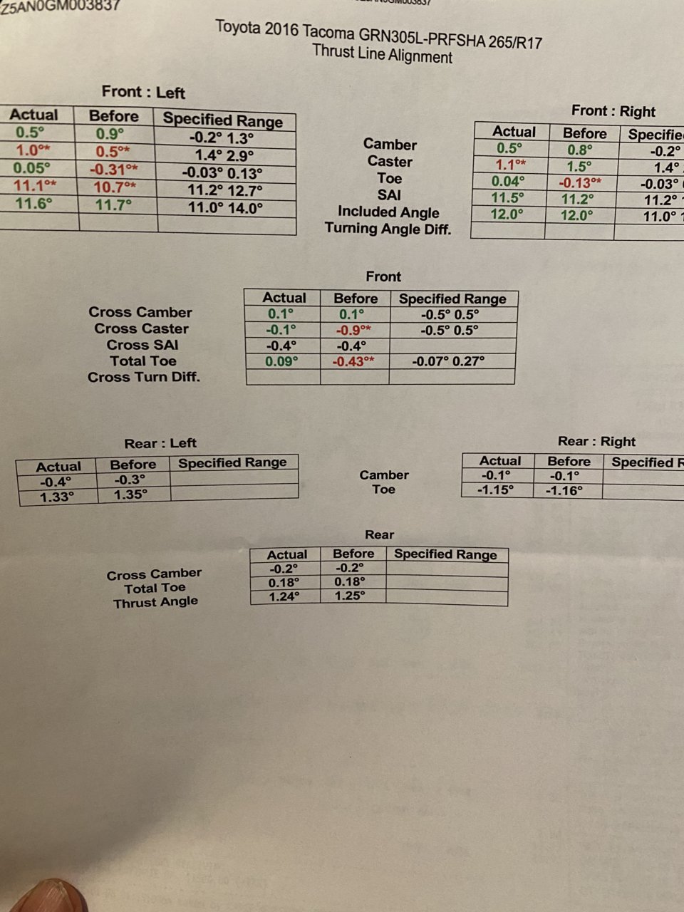

    So I had my neighbor following me today and he tells me my truck looks like My thrust angle is way off, and my truck is dog legging to the right....
    It steers straight, but steering wheel has been slightly tilted to the right since I had the dealer do a spacer lift on it a couple years ago..
    So I pulled the tape measure out and sure enough, I have about a 3/4" difference between left/right when measuring the distance between the back of my tire to the inside of the fender well. (one side is shifter farther back)
    Truck has never been wheeled or in an accident. I also crawled under it and measured about the same difference between the axle and end of bottom leaf spring, on the left/right springs.
    I pulled out the alignment sheet from when the lift was done and is shows a +1.24 degree thrust angle...
    I tried searching threads, and it seems this is WAAAAAY out of spec.
    trying to educate myself more before going into dealer, but from what ive been able to read doing searches, is that there really isnt an alignment for the rear ends, and this problem is usually frame damage/bent frame related?
    Any pointers or ideas? Ive read that maybe taking to a body shop vs dealership for this type of issue?

  5. Jan 3, 2022 at 5:32 PM
    Midnight beauty
    Midnight beauty Well-Known Member
    Sep 29, 2020
    #342283
    195
    White mountains AZ
    2020 midnight black Tacoma TRD Sport
    It sounds like they didn’t get the center pin back in its position when they put the lift on.

  7. Jan 13, 2022 at 8:09 PM
    Chasin Tail
    Chasin Tail [OP] Well-Known Member
    Oct 14, 2015
    #166697
    152
    Olympia, WA
    2016 Tacoma DCSB 4x Sport MGM
    Following up to close out my issue.
    Took the Truck into local Les Schwab and told them my issue.
    They put the truck up on the rack and took a look at the rear leaf packs.
    Pulled off the U bolts and dropped the axle to discover the Toyota Dealer that installed my lift put my leaf spring alignment pin thru one of the honey comb holes in the lift block instead of thru the center alignment hole... Thus shifting my axle forward on the one side....
    Then they did an alignment and my new Thrust Angle is 0.01 degrees
    Like magic the truck tracks straight now.
