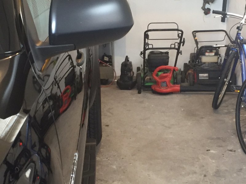

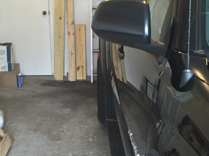

    Interesting......my truck is totally stock, except for the wheels and mine appears to be very slightly offset with the passenger rear sticking out about 1/4" more. The tire shop was totally perplexed to the point of replacing the back rear wheel because the techs and I were convinced the warehouse had shipped one with the wrong back spacing.
    The new wheel still looks off, but not quite as bad as it did before (though this could be psychological) After measuring the back spacing and offset, all four techs and I decided that we were all crazy and it was probably an optical illusion or something.
    My wife says that I'm crazy and I need to stop staring at right rear tire on the truck through the kitchen window. An offset bed would totally explain this.....
    OP: Is this about what you're seeing? In theory, you should be able to measure the center line of the bed, and center line of the window and mark them with a piece of tape and they'll line up......

    Yep that's exactly what I'm seeing but mine is far more pronounced. This weekend maybe tomarrow I'll do some measurements to see if it actually is the bed. It's really getting on my nerves. I notice it more and more everyday lol
