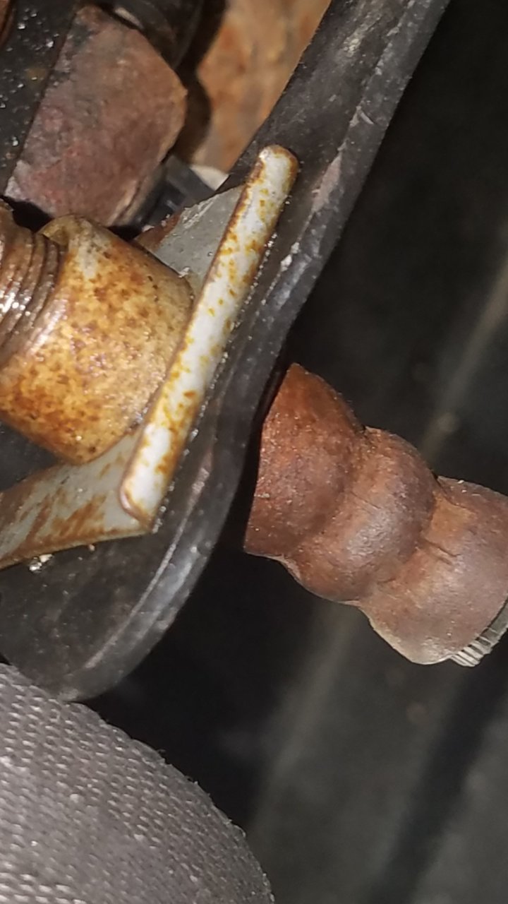

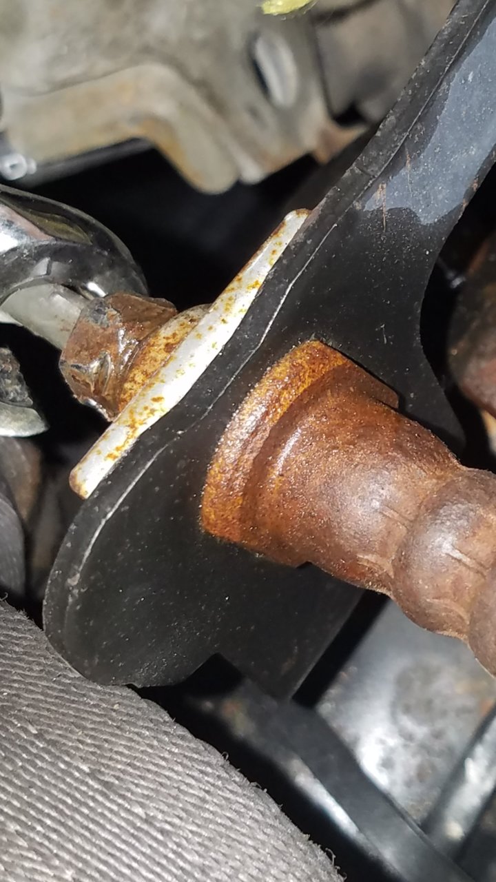

    Is this clip suppose to pop right out? Ive been hammering on it but doesn't seem to budge

    Yeah.
    That clip should slide off, probably needs some PB Blaster or that home brew, some tapping with a hammer, maybe some heat.

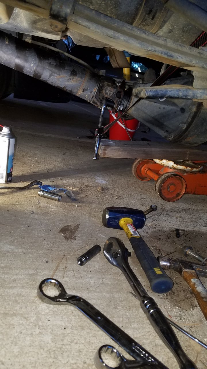

    Is this suppose to be this hard to get off?

    Absolutely not. Not sure what is going on here but it’s been way over complicated. Here is a video link. One of many showing it done https://m.youtube.com/watch?v=lye0CWwk8S8

    A longer breaker bar is nice to have to get things started sometimes. I don't think your contraption is helping much on the bolt, although it may help put you out of your misery. More PB Blaster or home brew. Leverage. Patience.
