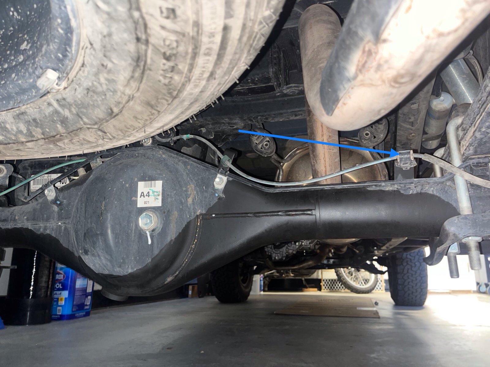

    Trying to figure out the rear main seal leak and the lower ball joints on the front end when suddenly I seen this leak. One step at a time, one step at time. Any one fixed this leak yet?

    Kind of need to see it from the other side.
    That’s a “weird” leak pattern looking at it from that side.
    It’s up by the diff breather on the left side too……
    And on the top of the axle tube on the right.
    Something odd. Again, need to see pictures of the back side.

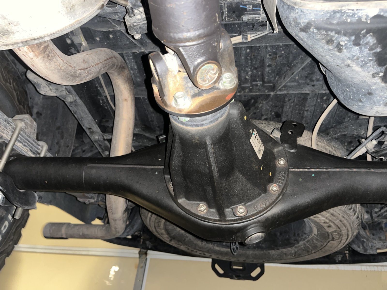

    I will get the other side.

    Maybe it’s just the picture?
    But this line, looks to have come detached from its mounting point?
    I don’t have a 3rd Gen. or I’d look at mine.

    Looks like I found the problem. I think that rear differential gasket is my main suspect?

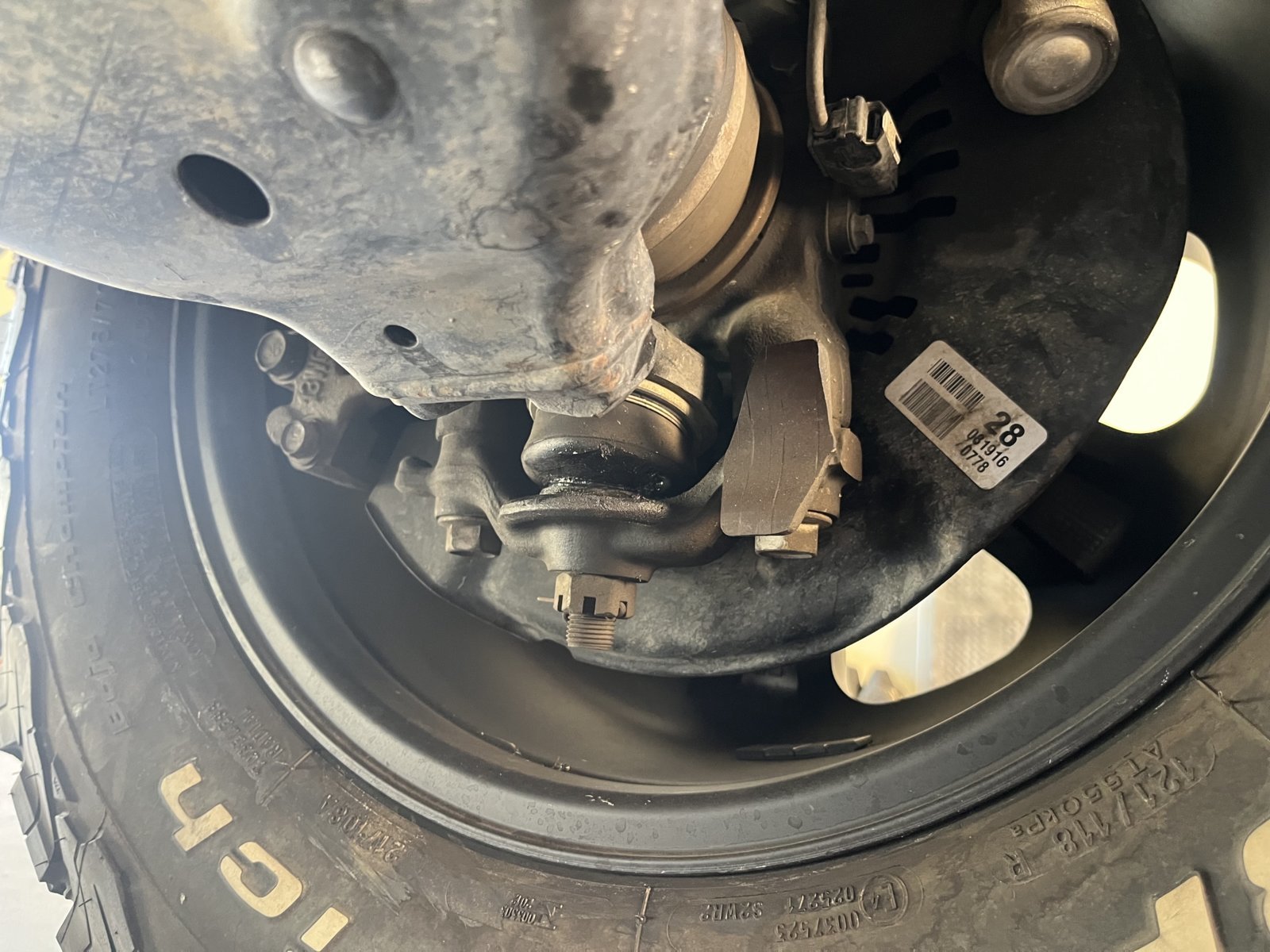

    I'll post up the lower ball joints, since I mentioned them. Dang, everything happens in threes.

    Yeah, the 3rd Gen trucks are known for that.
    Sorry man.
    Pretty sure you get can by with just unbolting the rear hubs and sliding the axle out a few inches.
    Think you can also unbolt the black lines from the axle tube, and have enough slack to pull out with out undoing the lines at the wheel cylinders. (No need to bleed brakes, or cap the lines).
    Still not a fun job. But doable in a driveway for sure.
    If you have an E-locker. You may also have slide the locker ring over to get the 3rd member out,
    There is a tutorial here on TW. It’s not a 2nd Gen. But the principles are the same.

    3rd gens don’t require anything special with the locker. Diff just comes right out once the shafts are out of the way, wiring unplugged, and nuts for the 3rd unbolted.

    Wasn't there a known issue with the 3rd member housing leaking on 3rd gens? I think I remember reading about it somewhere

    Sure was. I don’t know if there is a TSB or not?
    But it’s a known issue.
