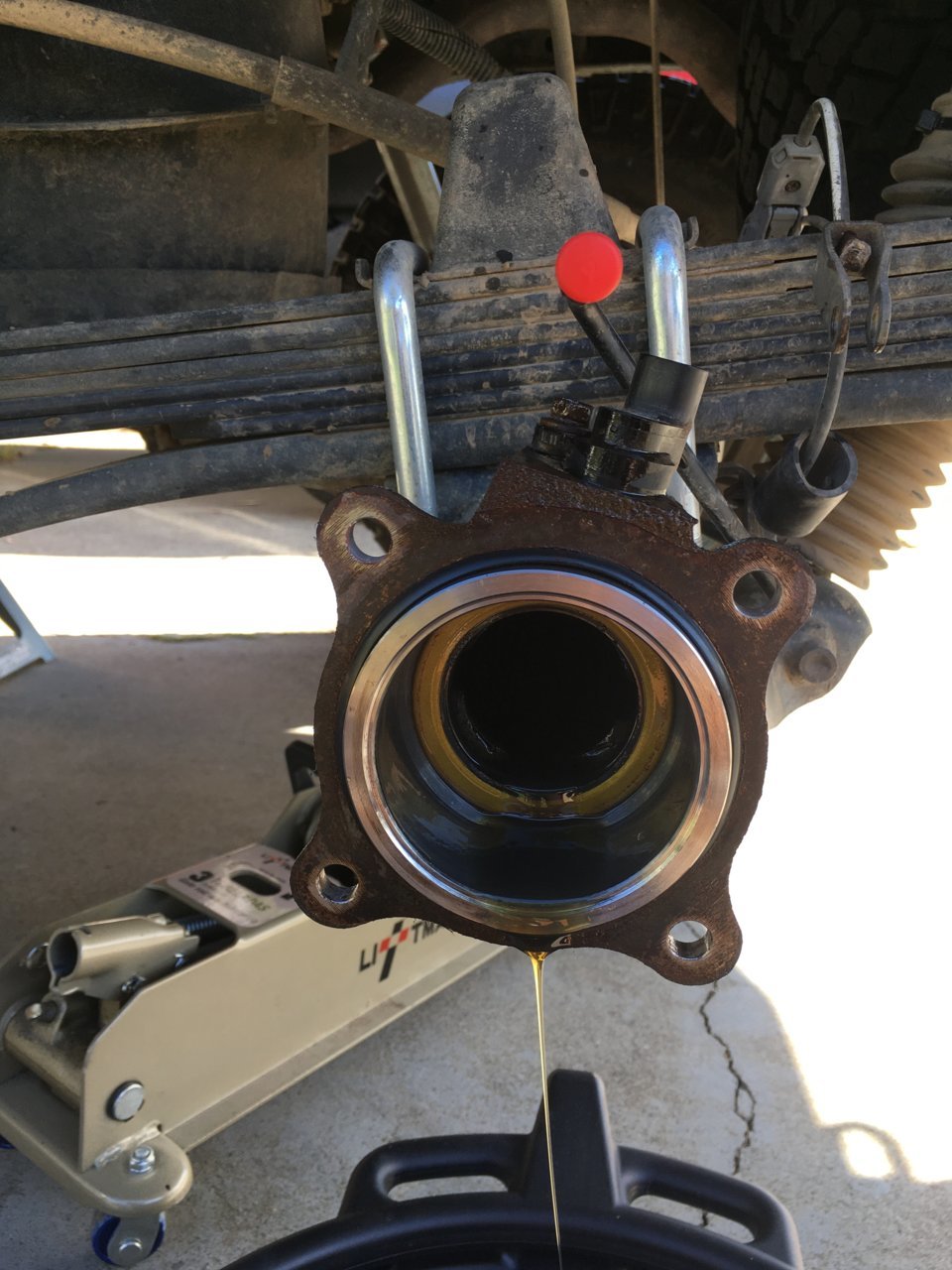

    Inspected rear brakes and found them covered in fluid. I pulled the ABS sensor and confirmed it is gear oil. Both passenger and driver sides are drenched.
    I pulled the diff breather valve and cleaned it up good. I cleaned the drums and shoes and entire areas w brake cleaner and rags.
    I bought two new inner seals from the dealership today as well as new o-rings. I took one side apart and was ready to change the seal but I chickened out.
    The YouTube videos I saw show the inner seal is almost flush with the end of the axle housing, but mine is tucked in a bit which makes it harder to pull and harder to press the new one in.
    I have a seal puller but no special tool to press a seal in. Stealership wants $1200 to do the job which is insane.
    Any advice?

    I think I have a metal cylinder I can use to press the new seal in, but how far do I press it? How do I know when it's where it needs to be?
    Also, the seal puller I have doesn't really work for this application since the seal is set so far back in the axle housing. Can I use two picks to pull it out instead, or is that a bad idea?

    I normally drive a screwdriver through it and twist it causing it to buckle and pull out. Careful not to booger the bore. If careful you can drive the new one in with a large (1/2 or so) flatfaced punch if you don’t have a seal driver.... that seal should be flush. I bet your axle bearings are sloppy too. If you can wiggle the backing plate all over the place they are worn, thus your new seals won’t last very long. I normally buy 3 seals in the event I screw one up... good luck

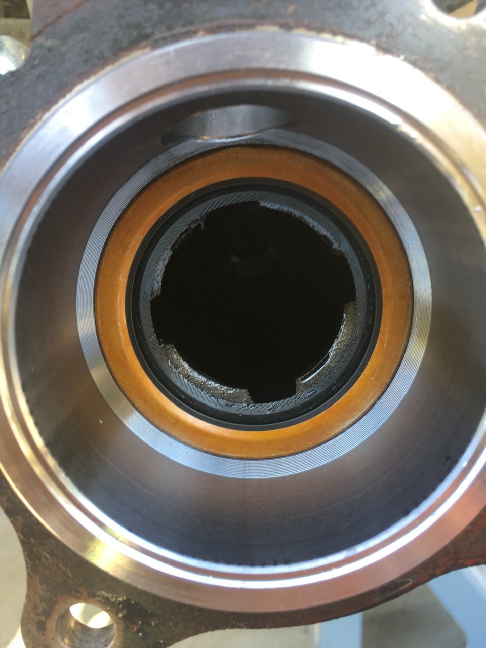

    How bad is this bearing?

    I would replace it, mine were that bad, I had to put it back together to get to work, replaced just the seals and three months later they leak... there’s a gazzilion threads on this....

    Like previous said, new bearings on both sides. Otherwise you’ll end up doing seals again in a few months, or worse, left on the side of the road
