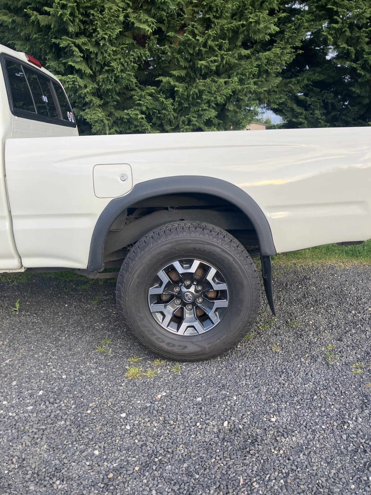

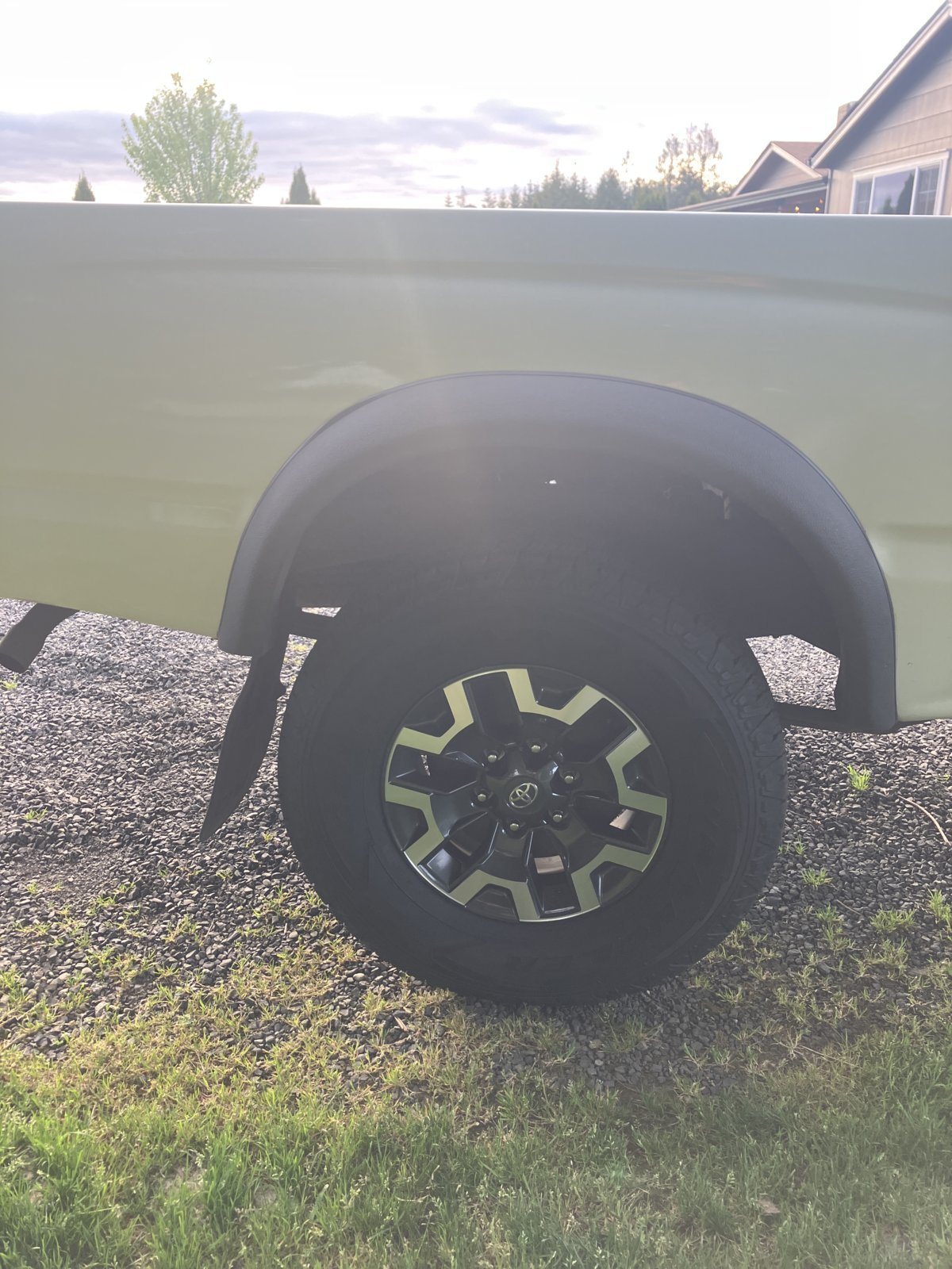

    image.jpg image.jpg Hi, I have a 1997 Toyota Tacoma 2.7 4wd. I don’t know if this is even a problem, but I just wanted to be safe. My rear axle seems to be favoring the rear, and the wheels seem to be close to the mud flaps, but it could just be that I have different wheels and tires on. My leafs and all look good underneath. It just seems like something could be wrong. Photo is attached. Any info helps, thanks

    Not that I know of. The rear shocks are pretty new, but I have only had the truck for about 2 months. I don’t know what all has been done haha

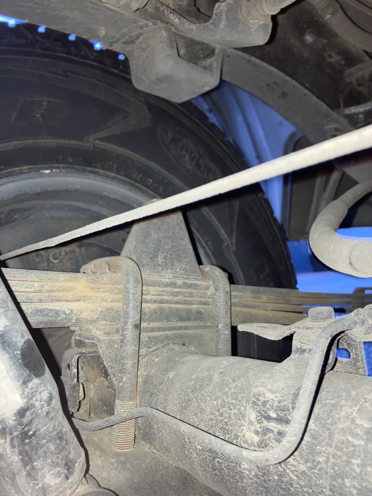

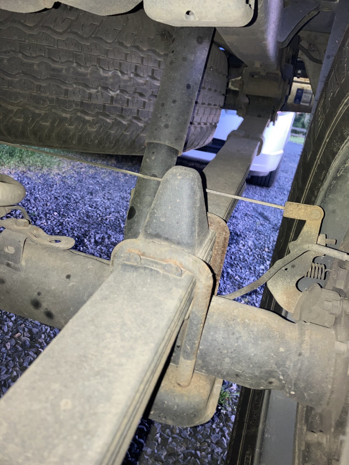

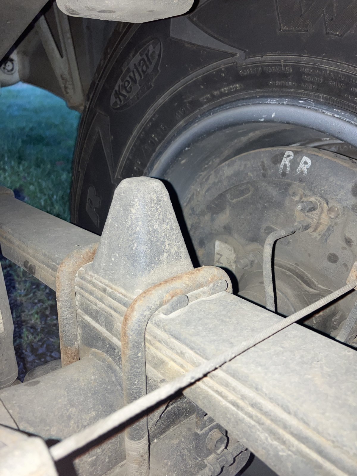

    Take pix of the shackles
    The U shaped fastener that goes over the leafs on front and rear of the axle
    Bet you can see movement/witness marks on the top leafs

  6. May 13, 2024 at 8:56 PM

    Great pix
    Shackles have not moved
    Hmmmmmmm

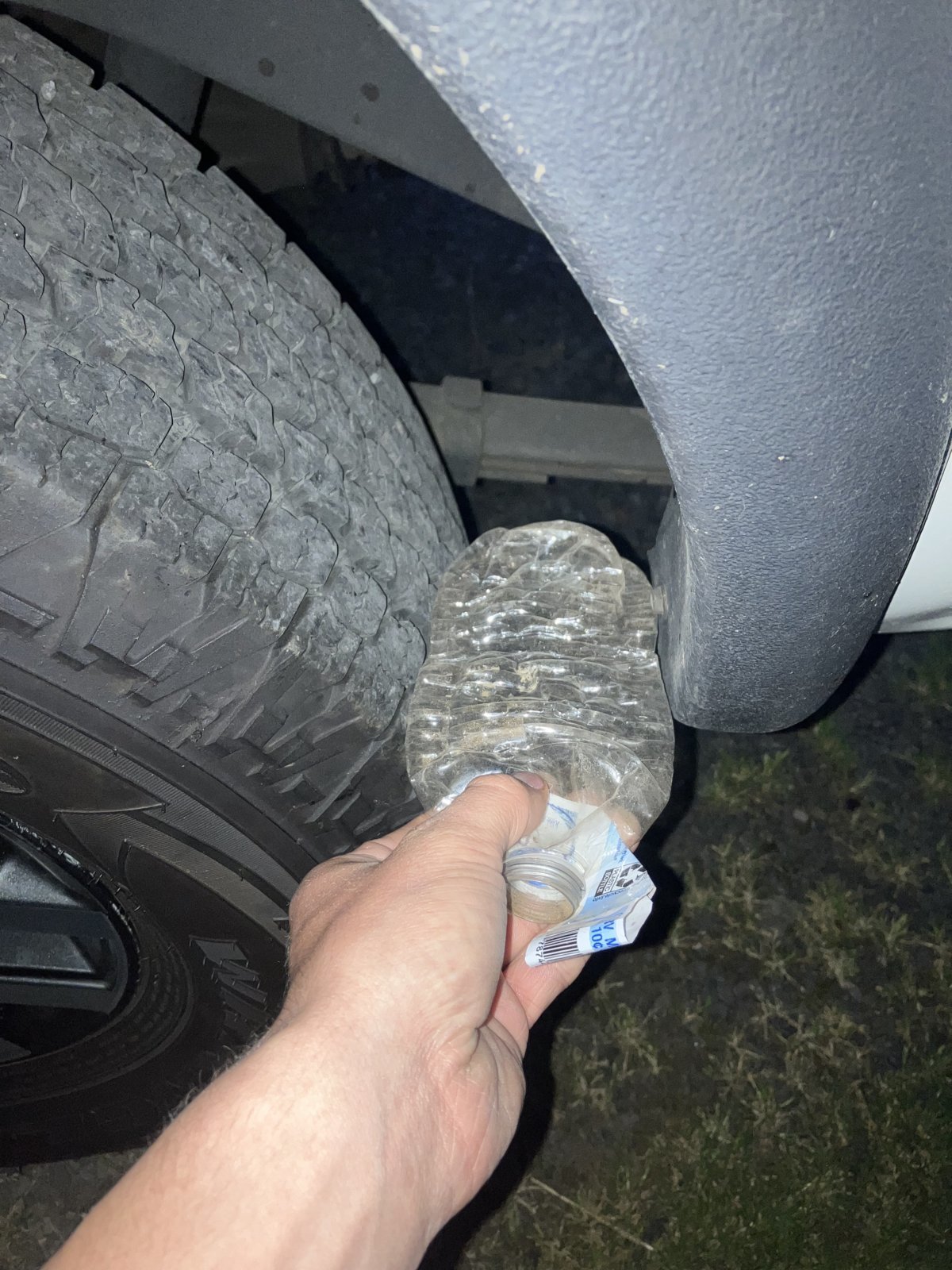

    Just to make sure
    Can u check your gaps both sides with an object
    Kinda like this…..
    Just to be sure

    Just checked the gaps (couldn’t upload the photos for some reason) but they seem to be exactly the same. I don’t know if I should even be concerned??

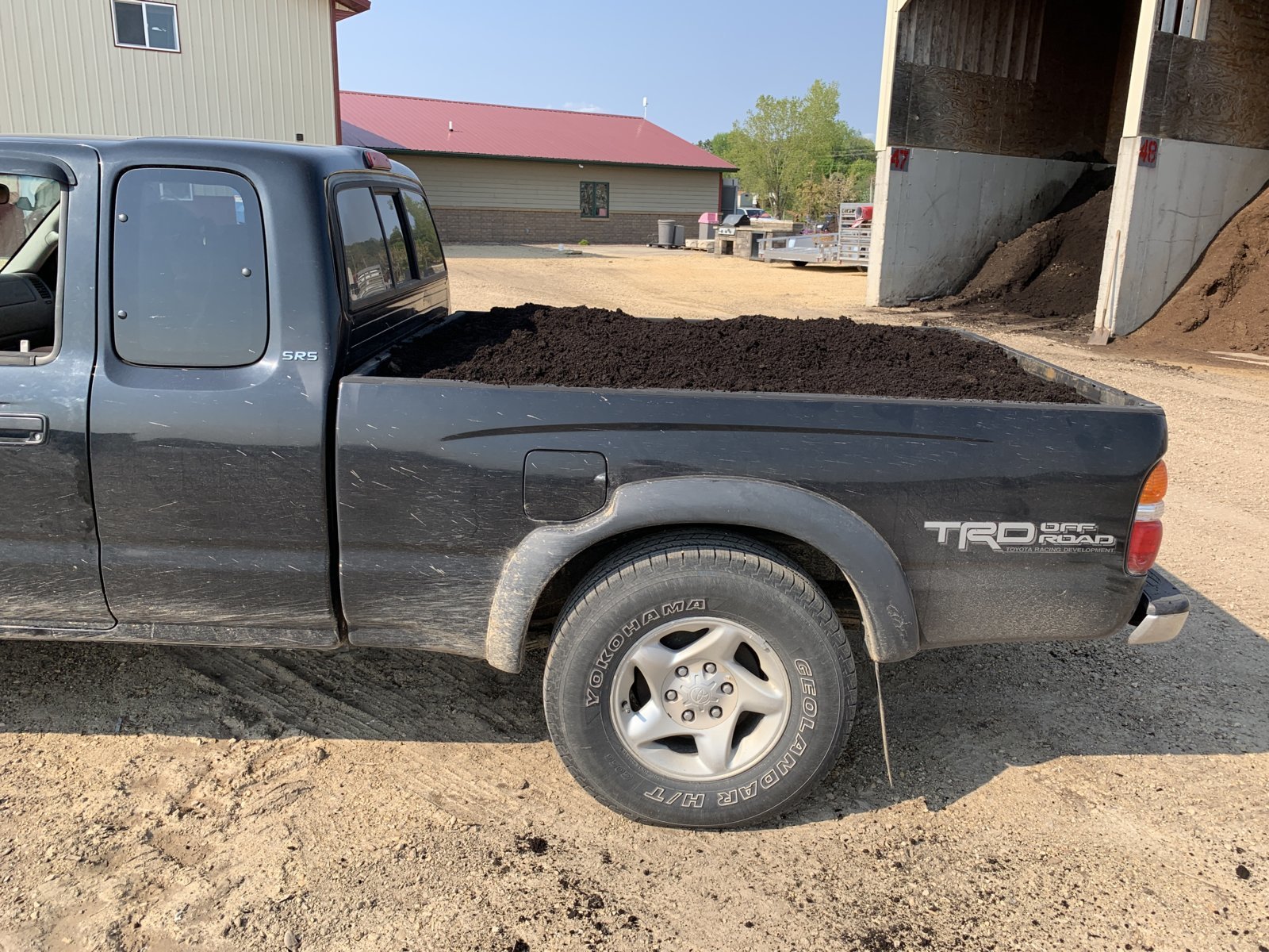

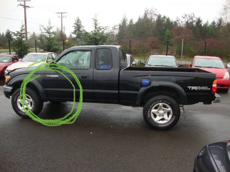

    Is this a 97 or a 98? Got a picture of the grill? I don’t recall the 95-97 models having that fender flare but I might be wrong. Just thinking making it’s actually a different bed or something? Here’s a few of my 2004. Pretty similar in how it is offset.

    Maybe not
    If gaps are same both sides…..your not crab walking….no bad sounds….no uneven tire wear
    does look like wheels kicked back thou
    The only other part to inspect would be the hangers (2 each side) but again if same gaps both sides…..hangers should be fine like those U shackles

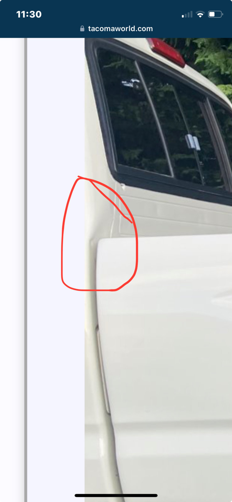

    Any wrecks on vin#? I dont know what the bed gap between cab and bed should be but looks like a dent in the cab from bed? Maybe got rearended and moved bed forward

    I had a 4 wheel alignment done at Les Schwab about 2 weeks ago, and they said it was the tightest Tacoma they had driven in a while haha! When I shake the bed nothing happens, just feels pretty tight. To reply to ztwatson… Yes it is a 97, I think the previous owner added those fender flares from another Tacoma, because they fit so well on each fender and look pretty good lol but that was a really good guess.

    Holy crap zwatson you gave me an idea
    I looked at OP’s bed gaps….look pretty tight compared to your pixs
    saw this

    @wilcam47 yes it is a salvage title truck. It was repossessed by the state patrol and sold at auction to a Toyota dealership. I believe it was a pit maneuver or part of a drug bust or something. The rear bumper has been replaced I know for sure. The body work that was done looks very good for the most part, but the bed scooting forward is definitely a possibility. The pictures make it look so much worse lol… it’s parked at an angle in the photos so it doesn’t look TOO BAD in real life haha

    Oh man you guys are good!! That dent in the cab is on both sides in the exact same spots so I never picked up on it!!
    So what’s the final call guys, should I be worried about the longevity and drivability of my Tacoma? It just seems so tight and strong I don’t see how this could cause issues… but I want some more opinions… let me know. I’m 17 and this is my first truck. I get compliments on it all the time. This is gonna drive me nuts knowing that dent is there now hahaha. Thanks for all your help guys

    But then wouldn't be super hard for a PDR guy to remove. But it means your bed was pushed forward enough to contact the cab. Usually there's just slightly over an inch of gap between the bed and the cab. I would guess that's why your wheels look like they're more in the back than the front. You can realign the bed though it's only six bolts holding it on
