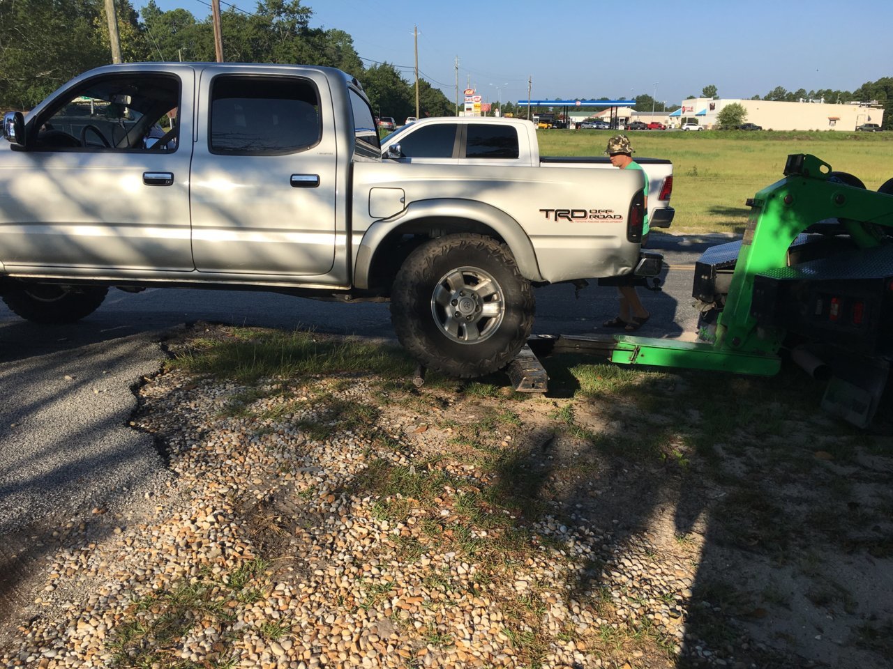

    Alright guy and gals. I’m new to the page. ( as a member ) I’ve been researching for months now and I can seem to find the answer I’m looking for. Hopefully I can get some answers now.
    I have a 01 Tacoma trd 4wd. Originally I had the elocker rear end. 4:10s. I got t-boned a few months ago, I since then found a axle with out elocker, 4:10s. I was wondering if the axle size is the same, I’d like to put my factory axle back in. (Cut and weld)
    See pics.
    I guess the question is is the size the same? Could I cut the bent portion out, weld the good portion in? Had it been done? Is it possible? What’s the best route? HELPP!!!!!
    If anyone is near sc, or in sc. do you have a spare elocker axle housing you’d like to trade for good non elocker housing? (4:10s)

    Idk about cutting and welding but i dont see why you just dont put the other axel in and upgrade to a Detroit or arb locker
    But the houseing should be all the same if you wanna :sawzall:and:welder:

    You'll never get that axle straitened out. You'd have to cut the entire tube out and weld in a new one in an axle jig. Be cheaper and easier to just source a junkyard axle.
    http://www.car-part.com is a pretty good site to see what's out there without having to call around.

    This is one of those rare times where I agree with the above. That isn't for fixable for less than how much another would cost.

    Ive never heard of anybody welding a housing back together and it could be very difficult if you attempt it. I think they would be interchangeable (only thing I can think of would be ABS vs non-ABS having different designs to accommodate for the tone ring). If you do decide to weld it make sure alignment of the tube is perfect to save your tires and it may be worth adding some trusses for extra strength, while you are there.
    I would recommend just swapping in the open rear end to get the truck drivable and then just keep an eye out for a new elocker housing. If your elocker is ok a new housing shouldn't be too hard to find or too expensive. The link jberry813 posted is really helpful btw

    He was only doing about 50-60 in a 35. Surprisingly that’s all it did, wheel didn’t crack, was able to pull most of the dent out. Fucked his car more than it did my truck. Toyota FTW .

    Thanks! And as far as abs I didnt have it in either axle. My old boss is a wiz at cutting and welding, I’ve seen/helped him cut and shorten a few axles. That’s why I was wondering if it’s the same. But as far as finding a housing... that’s the hard part. It’s either 600-1500. I feel like just throwing a locker or something in the axle would be just fine. But I also feel like putting it back to “factory” would better accommodate the truck. But as far interanls everything is okay beside the shaft on the bent side.

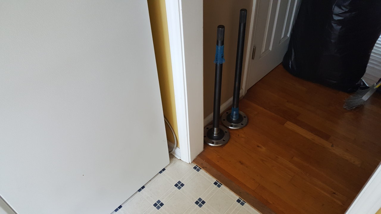

    I have 2 spares you can have if yours are non abs.
    They are trail spares. The flange is slightly off on both. No vibes. When I say slightly...i mean just barely visable.
    Edit: or I have a brand new one that was used for 2 days I'd let go for $300. I believe it's oem and was over $400 new.
    I do have a brand new set of 4340 chromos. Non abs sitting in my hallway.
    Probably have a rough time getting those from me :) but trail gear usually has them on sale quite a bit. 120 degree twist rate and some insane torque.

    While the axle housing could be repaired .
    The cost of a used housing even spending the money for new gears new springs and assorted hardware would be cheaper.

    He was only doing about 50-60 in a 35 and more or less side swiped me, hit the tire and a little bit of my rear bumper. But for the most part the axle took all the damage.. wheel wasn’t cracked or bent, tire still full of air. Surprised the hell outta me. He sent me into a 180 spin.
