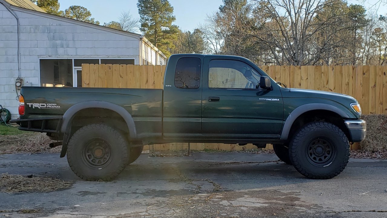

    edit: here you go, have a couple photos as well. This is Tucker as he stands now - 19 years of ownership and counting. He's currently riding on some steelies and 285's.
