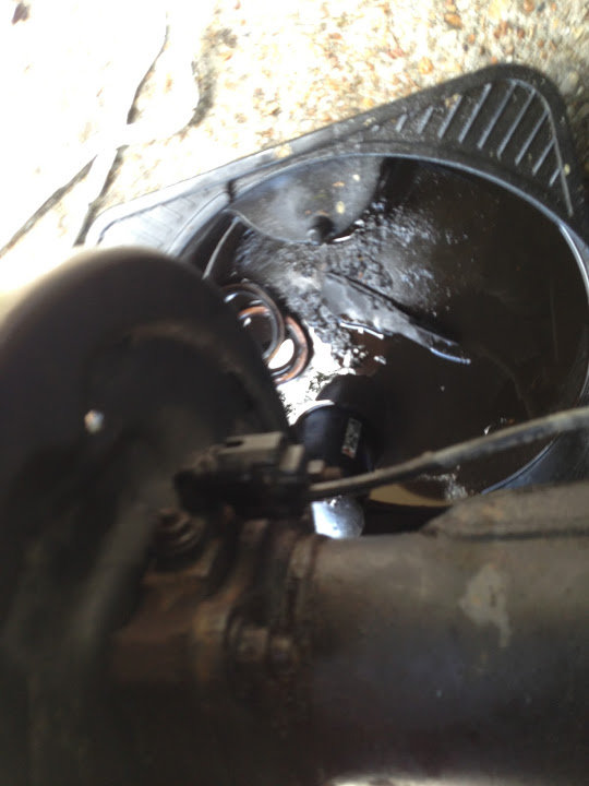

    Hi everyone, I just finished replacing the inner seals on my 2007 Tacoma's rear axle. I just wanted to share what I did and what I learned. Firstly after researching a bit I was able to find a couple write ups that helped. The one that helped the most was for a 4-Runner so it was a little different but the basics of the steps are the same.
    Here is a link to that:
    That one is pretty detailed, so i will just point out the differences.
    - The part numbers for the orings and seals are different, but the Dealership will give you the right ones. They were $8 for the seals and $3.50 for the orings.
    1. First put something under the front wheels to chock them up. Make sure there is no way that the vehicle can roll. Once you have the rear end off the ground (especially if you remove both rear wheels) there is nothing to keep the truck from rolling. The parking brake has to be off to complete the procedure, and the pawl lock (if you have an auto transmission) will not save you, as it only locks up the rear wheels, which will now be off the ground. WARNING: THE VEHICLE MUST NOT BE ABLE TO ROLL, NOT EVEN A CENTIMETER. IF IT ROLLS WHILE UP ON THE JACKSTANDS IT MAY FALL ON YOU AND COULD KILL YOU, MAIM YOU, OR OTHERWISE SERIOUSLY INJURE YOU.
    2. Next, get the rear end up one side at a time. I placed a jack under the axle, removed the wheel, and placed a jack stand under the frame near the rear of the vehicle, in front of the rear axle. I also placed a second jack stand under the rear axle to better support the axle and the vehicle itself. The stands under the axle also help to keep it level so that all of your gear oil doesn’t pour out of the pumpkin.
    3. Now take the rubber hammer and lightly strike the drum until it comes loose and you can pull it off the wheel studs. Once you remove it, you will see that the inside is full of thick black grease. This is a combination of gear oil and brake dust.

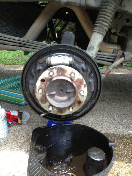

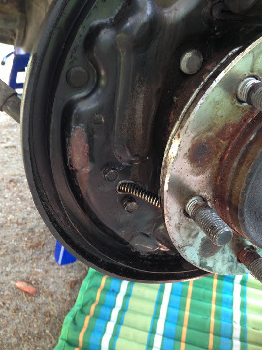

    4. Once you have the drum off, you will be able to see all of the brake components inside. These will also be covered with a layer of thick black grease.
    5. Take some time at this point to spray down the brake assembly with some brake cleaner. Place a catch pan underneath the brakes, make sure you have good ventilation, and go to town. I used an entire can per side spraying off grease and brake dust with brake cleaner.
    6. Next, locate the rubber brake lines where they come to the axle and into the metal line just to the drivers side of the pumpkin. One at a time use some vice grip pliers to pinch the line closed, but not too tight, or you may damage the line. This will prevent you from losing large amounts of brake fluid to gravity when you remove the brake lines from the backing plate.

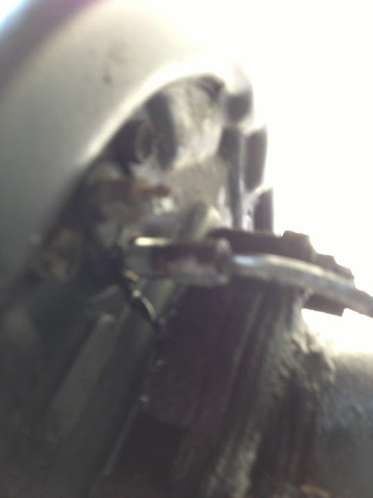

    7. This is where the procedure will differ a bit, from the link. Here you will need to remove the brake shoes and all the springs and stuff attached. The Haynes manual has lots of pictures and a good procedure for this. When its done it will look like this:
    8. Now you will need to disconnect the brake line from the cylinder (10mm).

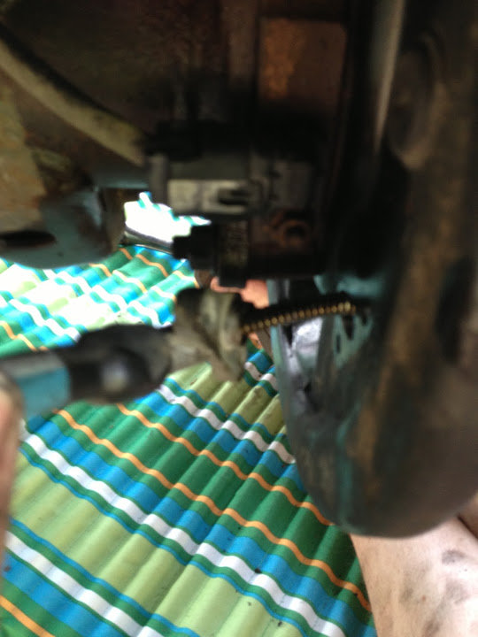

    and the ABS Sensor (10mm):
    9. Now you will need to remove the Parking brake cable, Just unscrew the 2 10mm bolts and slide it out.

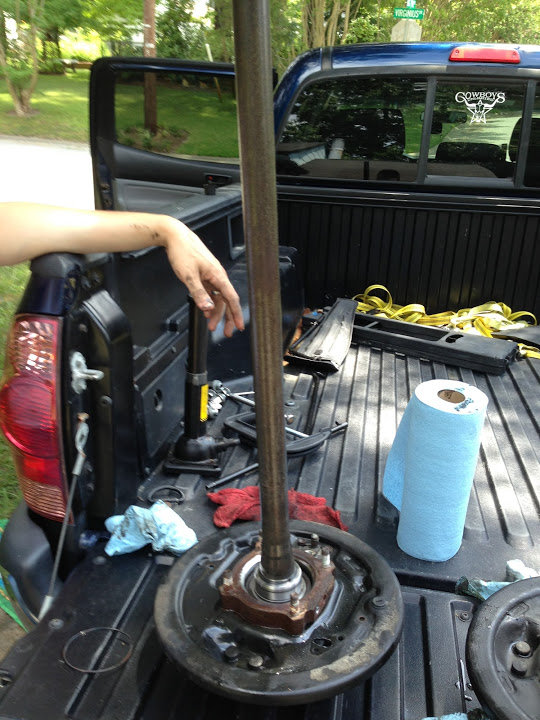

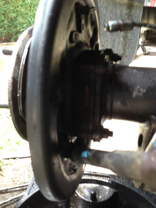

    10. When everything is disconnected you can undo the 14mm bolts holding on the backing plate. You might need to spray some penetrant on it as they were pretty tough.
    11. And CAREFULLY slide the axle out. It weighs about 30-35 lbs but is awkward, so if you have someone to help you, use them. This will leave you looking like this.
    12. Now you can use your seal puller (around $10-$15 at auto zone) to remove the old seal, being careful not to scratch the axle tube.
    13. After wiping everything down with a lint free cloth you can install the new seal. Make sure it goes in straight and goes in until it is flush. You can use pvc, a seal driver, or i used a piece of wood and rubber mallet.
    14. now put everything back together, dont forget the new o-ring on the backing plate. Check the haynes manual for the torques specs. and bleed the brake lines before you try driving around.
    I was pretty nervous about doing this myself, but loking back it was pretty easy, with good preparation and research.
